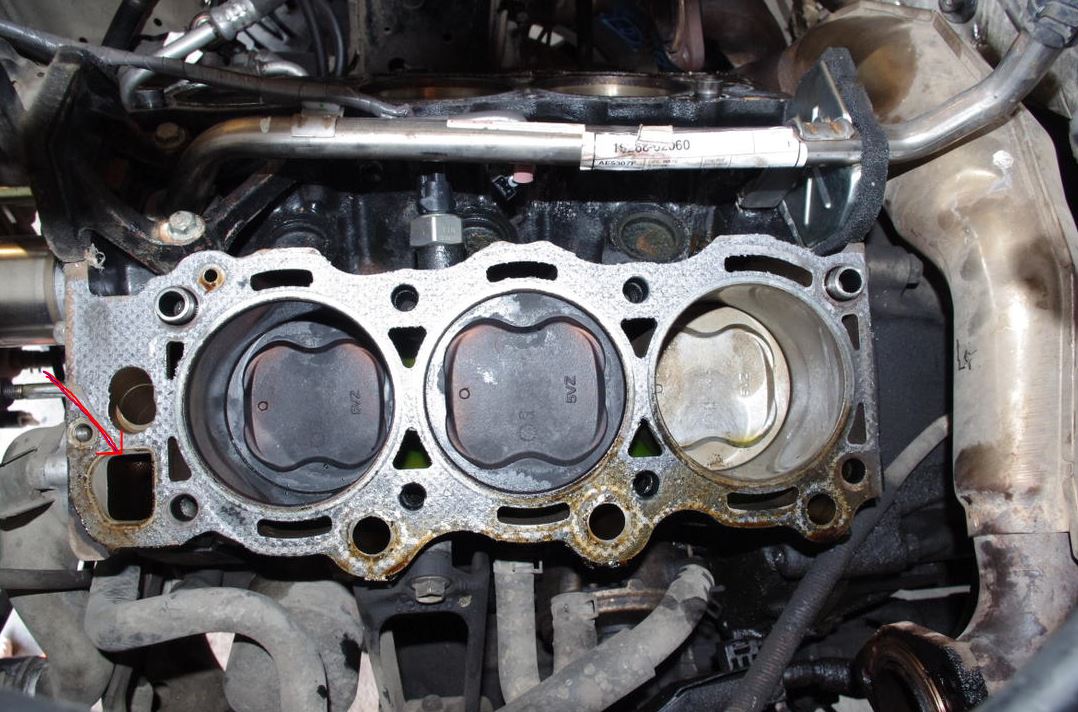

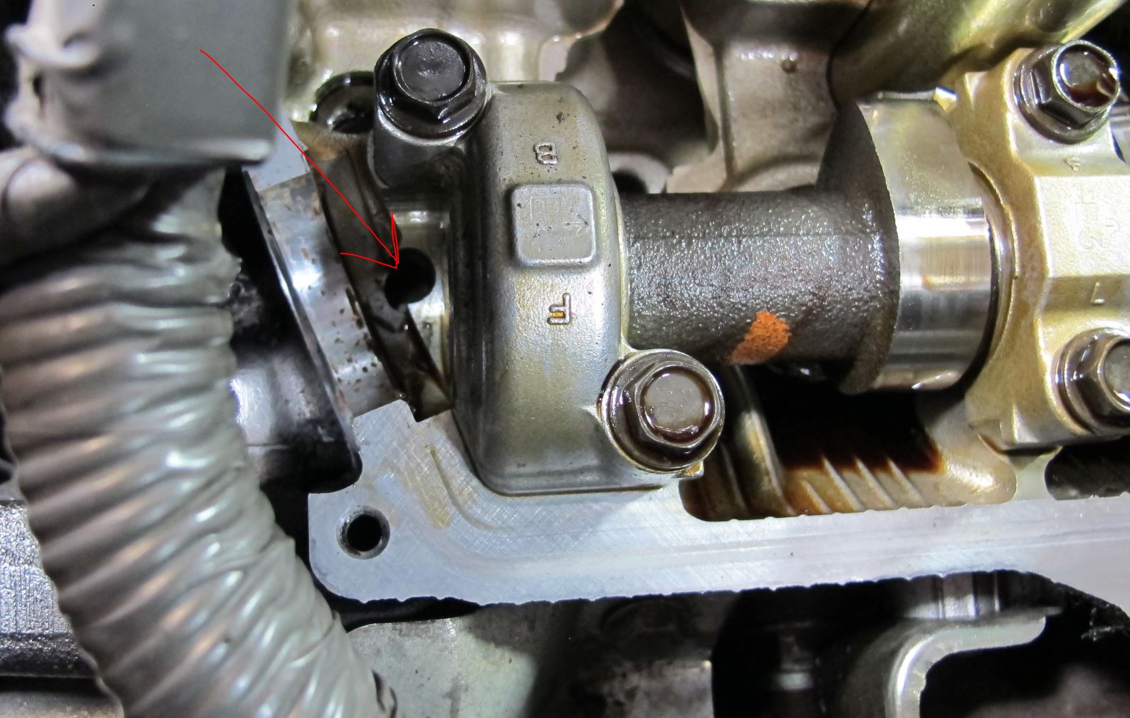

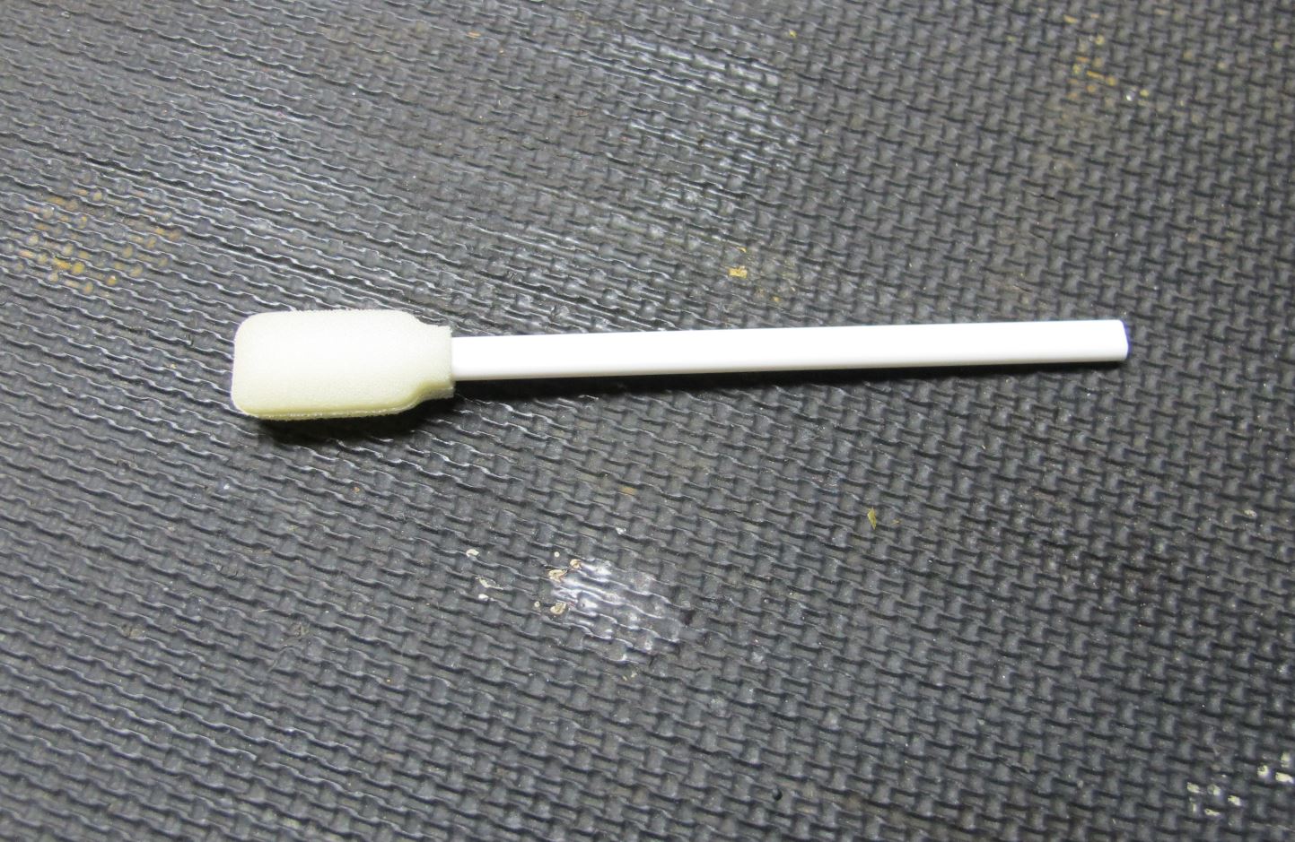

I was replacing my leaking valve cover gaskets and had a major screw up. I was cleaning the FIPG from the front drivers side half moon and thought it would be a good idea to plug the small hole just behind the half moon with a foam q-tip to keep the old seal from falling down the hole. It did keep the seal out, but the stupid q-tip fell down the hole and is nowhere to be seen.
The Hole of Doom
A similar q-tip, the one lost was round with a round shaft

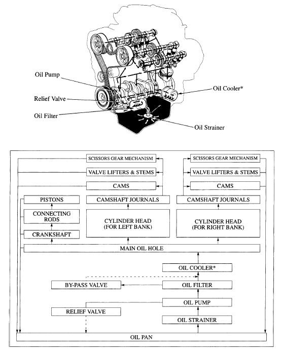

I did find this oil-flow diagram, and it looks like its on the uptake side, probably stuck low in the main oil hole. I might be able to get to it if I remove the cylinder head, the diagram shows a bend before flowing into the crankshaft area so it might be sitting there. Those that have done a head gasket replacement - do you recall a bend in the engine block's main oil hole, or would this thing drop straight into the crank shaft area?

Your hole shouldn’t be uptake. It would just blast oil at the valve cover. The uptakes should inject into the cam bearing journals.
Your hole should be a drain back for oil that oozes out the back of the rear cam bearing.
That diagram doesn’t show the drains.
