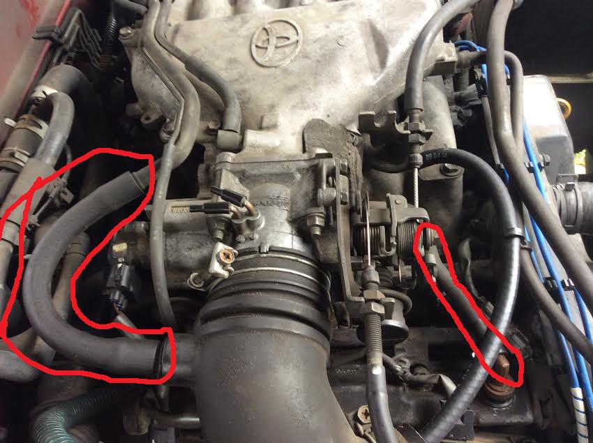

Ok, so I've done a little looking around and cannot seem to find anything consistent. When i did the valve cover gaskets there seemed to be a good bit of oil in the left hose, which would be consistent with the oil in the j-pipe. But some of the info i've been able to read suggest using the right hose (PCV valve). Some of what I read said it doesn't matter, as long as you have it on one of the other. Can anyone confirm or provide some guidance? Thanks!!!

Probably your valve stem seals are just too old to seal well enough and the excessive blowby is getting into the crankcase. If you see any blue smoke on start up, I'd bet such. Do a dry and wet compression test.
To slow it down I'd first try using a high mileage oil such as Maxlife or Mobil Super that contains swell additives to soften the seals.
Add the catch can. The reason they aren't used from the factory is that they have to be dumped or drained after a given time. Most automobile owners would not take the time to do such. Some car makers such as BMW actually design to dump it back into the crankcase.
The real fix will be to replace the seals.
Whichever line is wet is the one you want the catch can on. If both, then run two.
