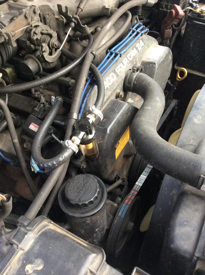

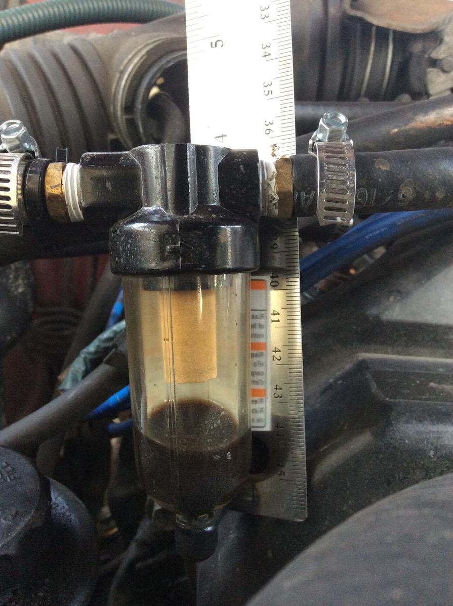

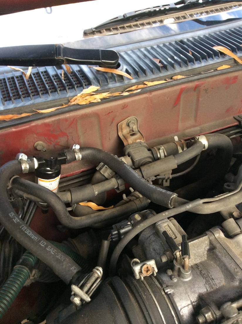

I took a picture of the package of the one I used. Its just a husky moisture separator for an air compressor. You can't really see too well, but the one that I put against the fire wall for the vacuum line back there has not captured anything, which was very counter to what I had expected since there was a bunch of oil in the j-pipe. The PCV one has filled up pretty good. You can see the picture of the mounting location....I just zip tied it to the other hoses running through there. And then the picture showing how full it is. That is after 2132 miles.
