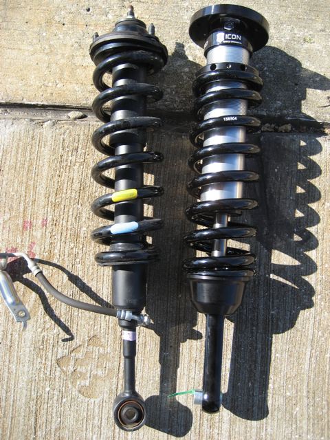

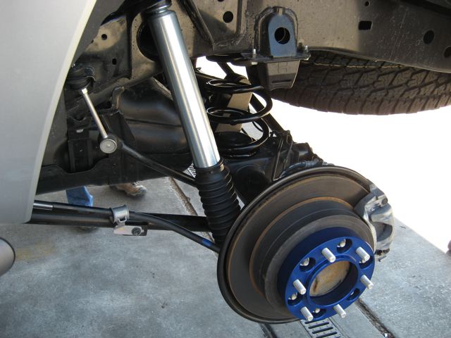

Suck it up and go for a coil over suspension lift. Spacers actually cut down on suspension travel. Coilovers add it. I'm running the Icon kit, and highly recommend it. Much better ride than the stock Xreas. Adjustable front lift from stock to 3.5", 2" in rear. I haven't adjusted my fronts- they measured out to a 3" lift in front the way they came. The install is easier than with spacers too- Did it myself in an afternoon with no special tools.

I bought the whole kit from a member here on the forum- if you want his name, PM me. He works at a dealer in Vegas and is a dealer for Icon. I think it was $1299 for the whole thing with shipping. Coilovers, rear shocks, rear springs, and front roll bar spacer kit to move it forward for shock clearance. That's all that's required, nothing else. Install the whole thing, drive for a few days, then take it in for a full alignment.
I wouldn't go back to stock for anything. Most people don't even know it's even lifted until I mention it. I can slam into speed bumps and such with no problems. Very smooth suspension, just a little stiffer than stock.
If you ever want stock ride height, put the stock rears back in and crank the coils back down- they go all the way down to stock height!
