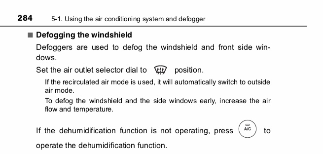

From the 2018 owner’s manual:

1. If the moisture is on the outside of the glass, the vents are likely blowing cold air. Condensation sticks to cold things when humidity is high and temperature is in the 50-65 degree range.
2. If the moisture is on the inside, the humidity in the vehicle is too high and cracking a window and/or engaging the A/C along with slightly warmer air temps will help remove the moisture.

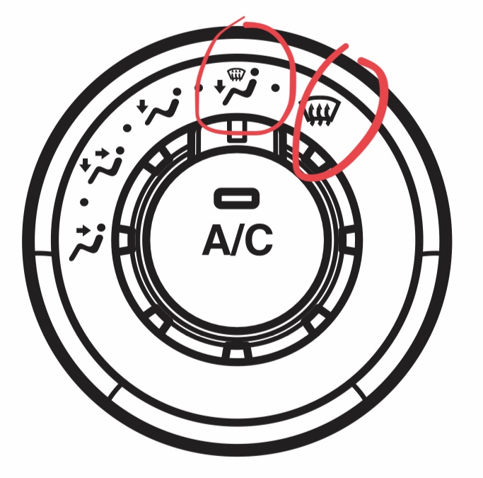

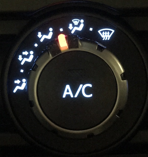

Winter weather and more windshield fogging than usual.
But keeping the windshield clear in the defog “windshield” setting prevents you from recirculating the air if you get behind a diesel or drive through generally stinky areas.
My technique to keep the windshield fog free is to set the air vent selector knob position between the “foot” and “foot+windshield” settings. With the temperature set however you want it and good fan speed you get some air blowing on the feet and windshield. Plus you can keep it on recirculate. If you start fogging up anyway try increasing the fan speed, and turn the A/C on for a while to rapidly clear it. Then turn off the A/C if you want. Or just leave it on.
Note that when you turn off the ignition then turn it on again the recirculate function is reset to bring in outside air.
