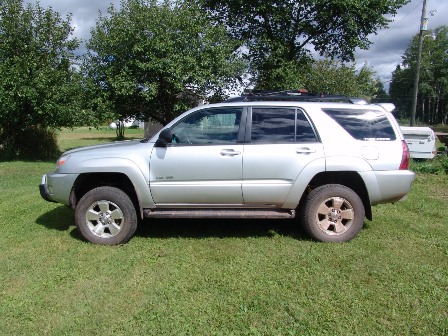

Its DONE!!!!!!!!!!!!!!
Well I got it installed to day and I must saw it's AWSOME!!!! Can't wait till Wed. thats when the wife gets her days off so we can go test it out.

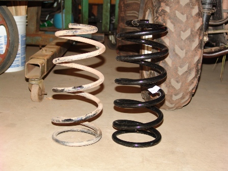

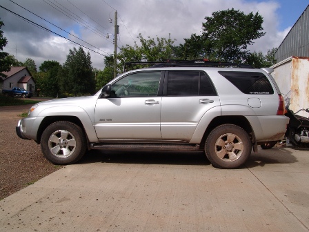

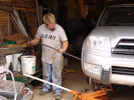

Just some advice to those looking to do this install the driver side rear spring before the passange side. I thought I would say this since I had not seen it in any of the others threads on there install. It took me from 10:30 until 3:00 and that was with gathering my supplies and cleaning up after. And I did must of it alone except I had a little troublee getting the left front in and need a little help from my neighbor's Dad. I had a great time doing it myself. Thanks to my fore-fathers who had installed and posted their progress it made it less of a challenge.
Before

Nice looking rig, you did that by yourself? Wow.

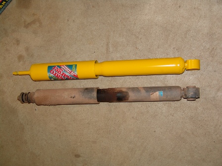

What OME part #'s did the total lift consist of? I couldn't tell by the boxes in your pics.
Wel I won't be taking them off just yet, though I would like to. I have a 2 year old daughter who uses them to get in and the wife likes to use them also. Maybe some sliders in the future after I sell the sport bumper trim.
As far as the set up I went with 884 springs with N140s struts in front and 895 springs with N142 shocks in the rear.
Hello Spensane,
What was the reason that the rear driver side spring needed to be installed first before the passenger side?
The 4R looks good. Congrats.
Cheers,
If you put the drive side in first you don't have to work against the force of the torsion bar. And I tried to put the right rear in first and I just couldn't get enough flex to put in the left rear. I removed the right rear and put in the left rear then I got the right rear in with no problem. I don't claim to be a mechanic but it worked for me. Thanks for the compliment one the rig, it's getting there.
