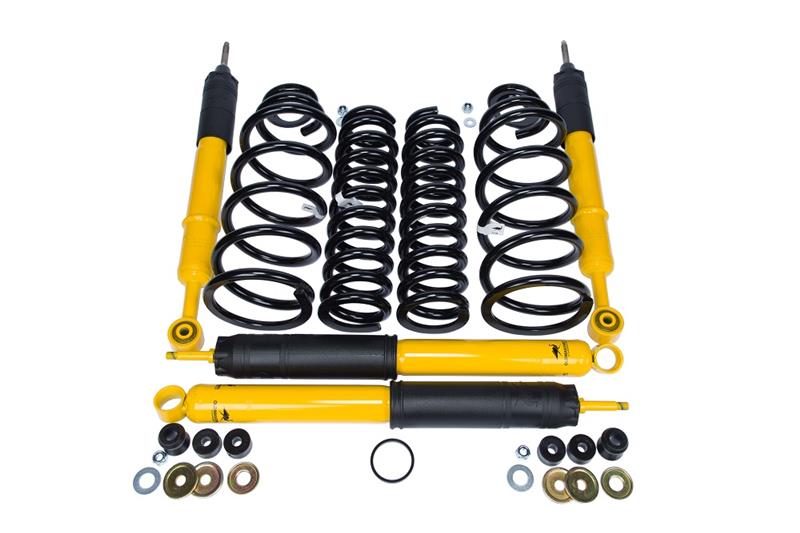

Im thinking of installing an ome suspension kit that is supposed to give me 2" inches. I really want the lift, but im getting worried about how it will affect my day to day ride. Does anyone have any complaints? The truck is still going to be a daily commuter so i dont want to loose much of the natural softness of the stock suspension, which even with 100k miles I still think it rides great. So, is it a good buy? Will i loose too much confort on road driving? I would really apprecciate if people with the OME kit would answer based on their experiences. Thank you!
Do you know exactly which kit your thinking of? There are several different spring options for both front and rear. But generally, OME will firm the ride up. You will definitely loose the stock cushy feel, but handling, cornering and off-road performance will be much better.

Is your OME going to be "stiffer" yes it will. Stiff is not a bad thing. Anytime your getting lift from a spring its going to be stiffer. My 6112/5100 is stiff as well. The 6112/5100, mono tube is Harsher over bumps. OME shocks handles everything much smoother. A good analogy to me is a sharp knife vs a not so sharp knife. Both do the job and work well. The sharp knife just works smoother.

You will guaranteed loose the plush stock ride comfort with the firmer valved shocks & stiffer springs that Old Man Emu kits are known for. They are primarily designed for modified and heavily laden vehicles used off-road, but there are on-road benefits as well.
My 4runner is light weight and mostly stock... LT rated all terrain tires and rear drawers that weigh 240lbs. I run OME #2885 (medium) front springs w/ Nitrocharger Shocks, and OME #2895 (medium) rear springs w/ #90005 (heavy) Nitrocharger rear shocks. The body roll, lane-change stability and highway handling characteristics are *significantly* better than the stock XREAS suspension w/ 120k miles on it. I also ran the heavy #2896 rear springs on #90005 shocks.
The trade off is an overall stiffer ride over potholes, man hole covers, speed bumps and expansion joints when the truck is empty and has less than 1/2 tank of fuel. Once there's 400+ lbs of cargo drawers, water and camping gear - the ride quality is super compliant both on and off road.
If I didn't plan on ending up with a super heavy rig, I'd consider the Old Man Emu #2884 (light) front springs with corresponding OME shocks, and #2895E rear springs with the standard #90004 Nitrocharger shocks (which are 15% softer the the '90005's). If i planned on keeping a lightweight rig and I just want to clear larger tires without loosing ride comfort, I'd look at Toytech or Bilstein 5100's with OEM rated springs.

Ive got OME on my GX which is I believe the same system. I find those complaining about stiffness picked the wrong strength. Ive got a steel bumper and winch so heavy front, roof rack and gear so medium in the rear. Its perfectly comfortable and ive beaten the shit out of it. its miles better than my stock 4runner suspension which I hate.
As everyone has mentioned already, there will be increased “stiffness” but that doesn’t mean bad. I have OME 886 (heavy) w/the firm valved nitrocharger shock. With a v/8 and a bumper w/ no winch, I found the ride to be perfect. I recall old pot holes I’d hit and bounce around on my morning commute, but when I got my lift, I’d hit the pot holes but no more bouncing and swaying.. so that was the “see I told ya” moment to my longtime GF haha
