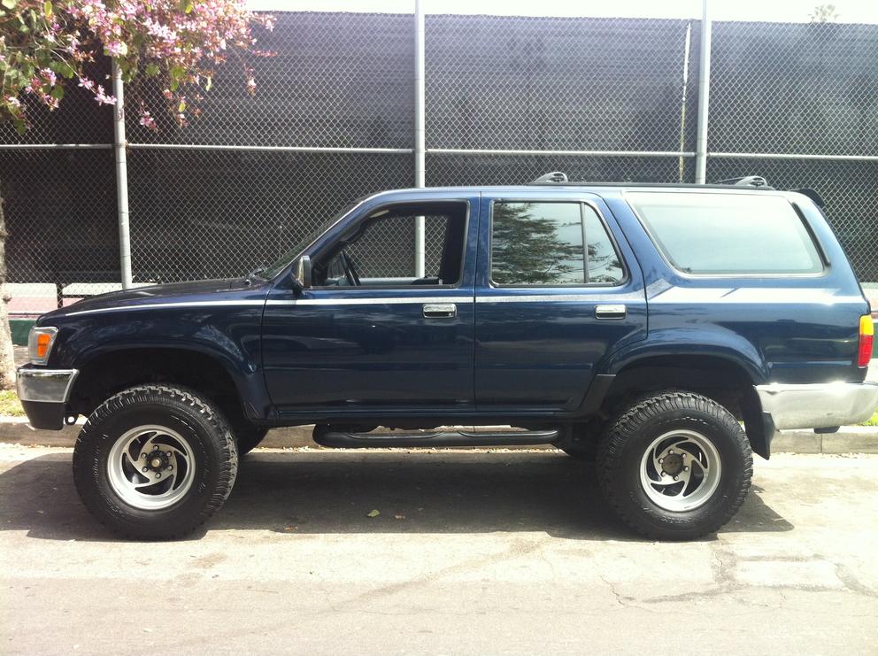

I did the med coils also. Waiting for my shocks to come. The shocks won't give you any lift in front. You would need bj spacers to get lift up front. i like the way mine looks with just the back lifted a bit. Heres a pic uf mine with just the coils in back, its sits pretty level now.

I'd say my height looks just like 94Runner's pic above. My rear end was sagging pretty bad. But the OME shocks and springs leveled everything out. I must have lifted a little. My mechanic said they should have charged me more labor because it lifted the truck.
[MENTION=80561]94Runner4[/MENTION], your runner looks awesome in that picture! I was just wondering, was there any weight in the back of the truck at the time the picture was taken? I'm thinking of getting the medium rate springs and I'm hoping that with a good amount of gear in the back there won't be too much rake. Thanks
