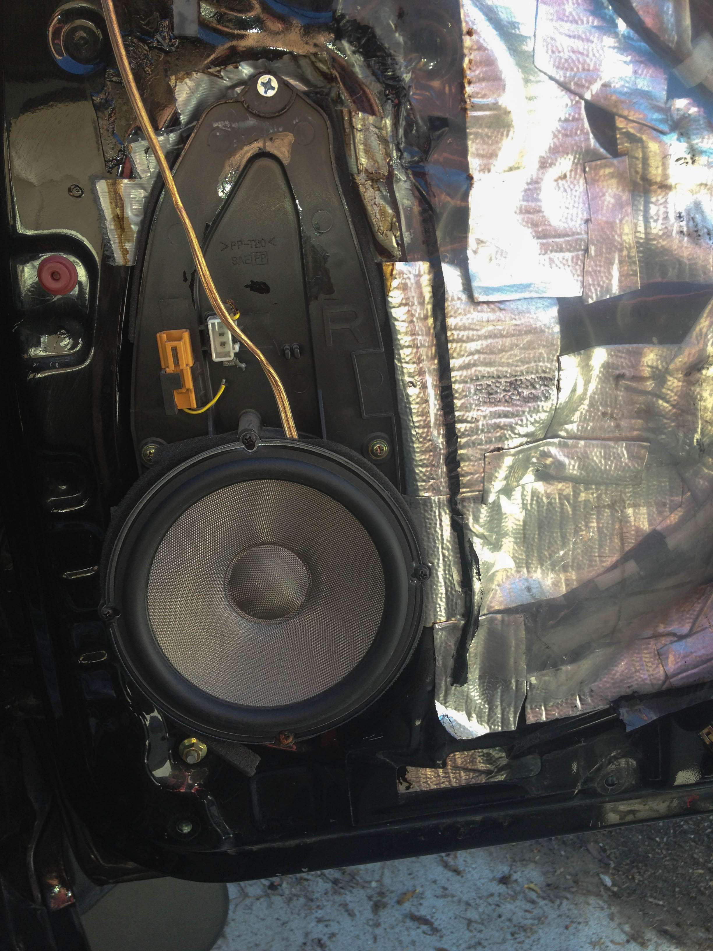

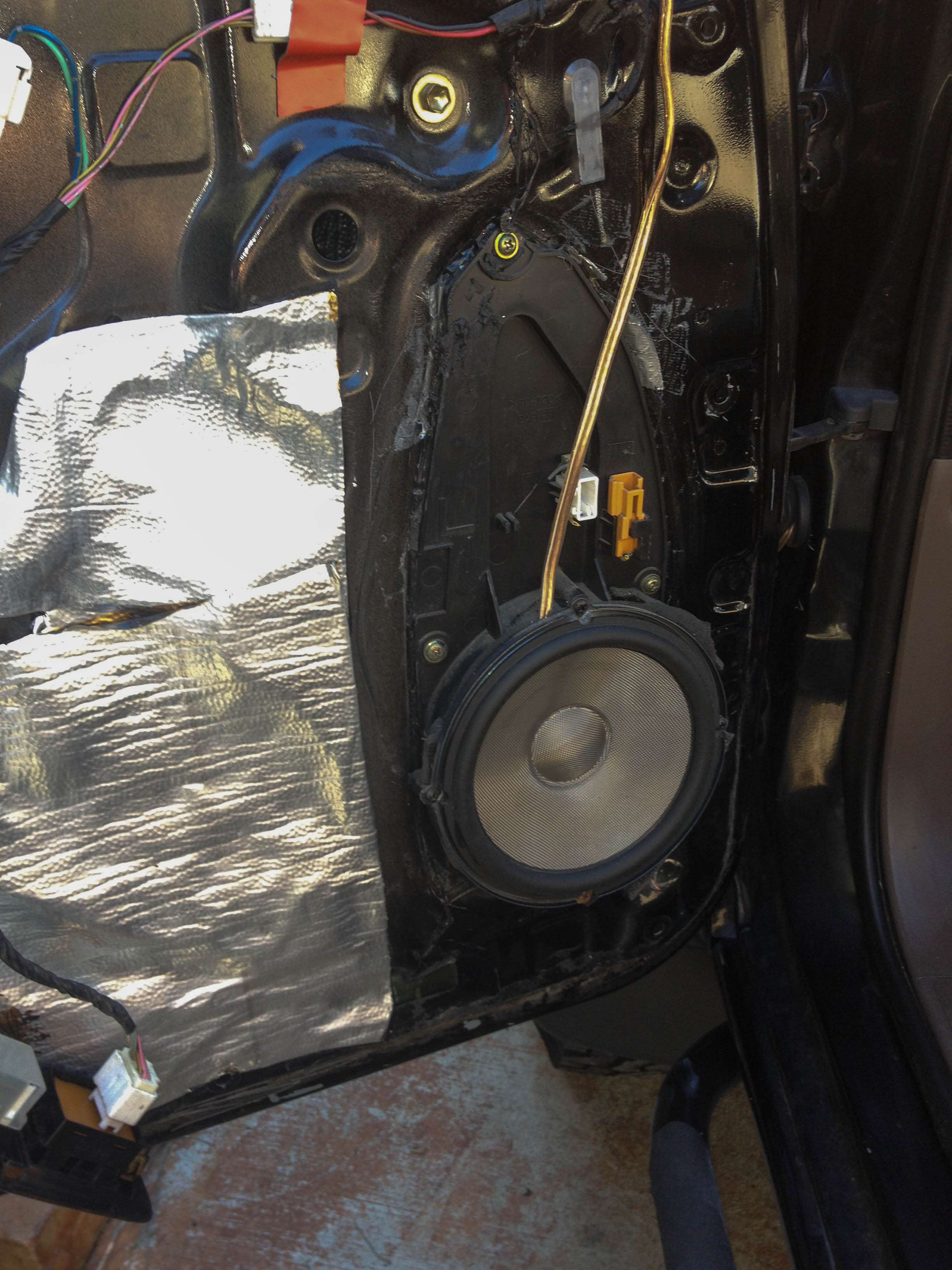

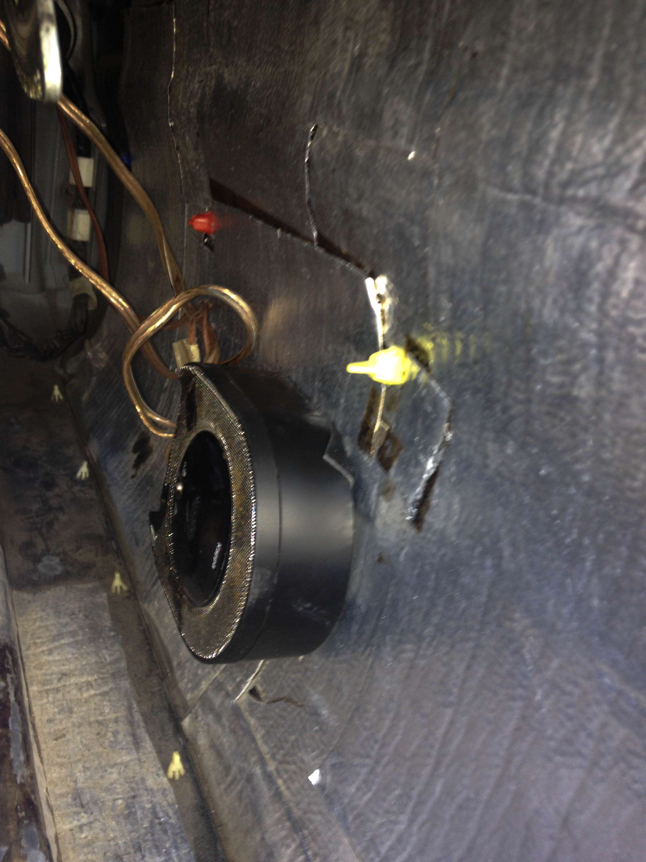

Today I would like to talk about a few Stereo Mod's I've done. I put these speakers in over 2 years ago but last week I had my door panels off and thought I would take some pictures.
The panels are really easy to remove for anyone who hasn't done it before.

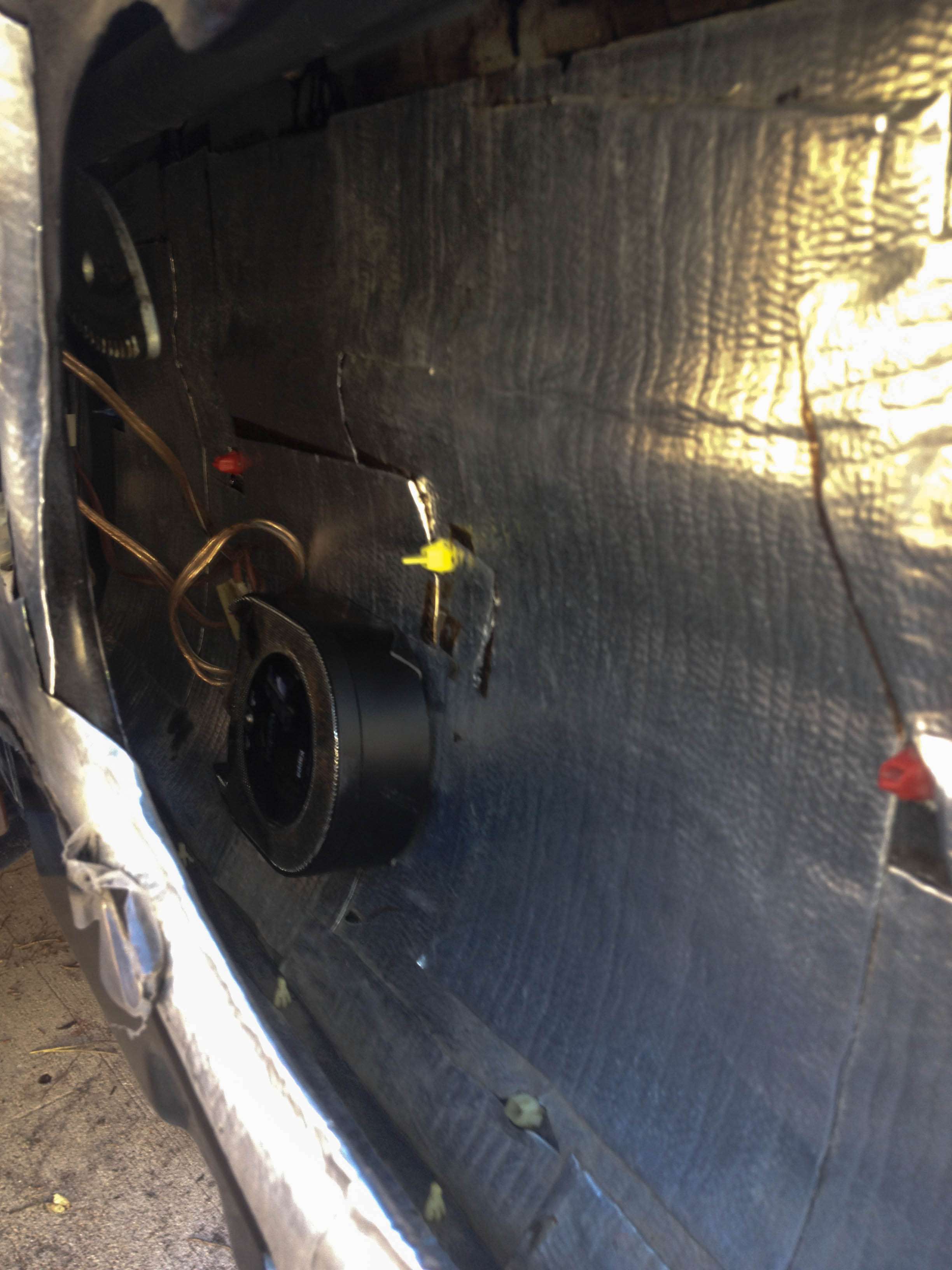

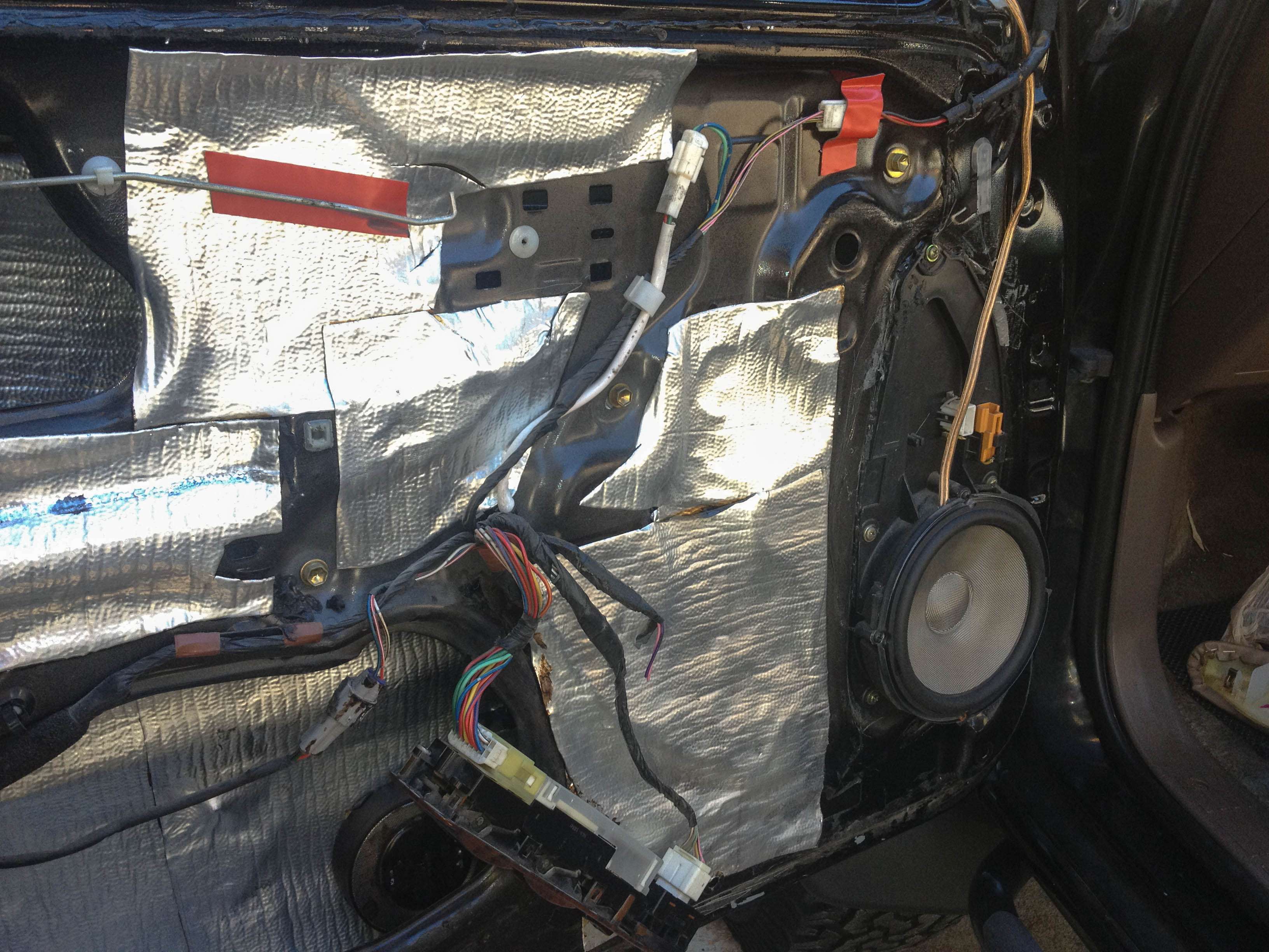

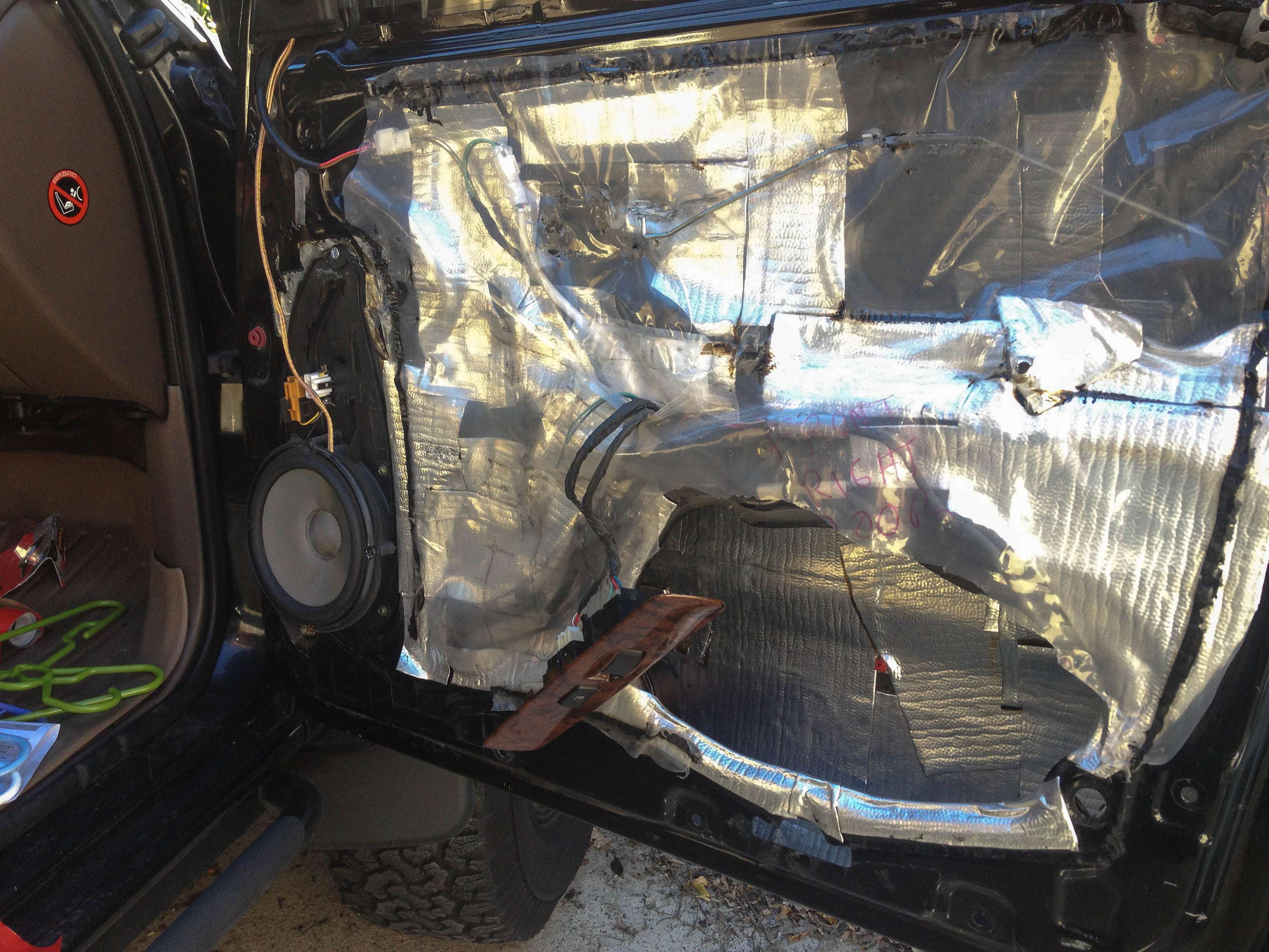

1. Sound Deadening Mod - Roofing Material
2. Alpine Stereo CDA-9835
3. Infinity Kappa 6.5 Component Set
4. Alpine 75W RMS x 4 AMP
5. Ran new 14 (or 16g?) wires from the amp under the seat to all 4 doors (this is highly recommended by me)

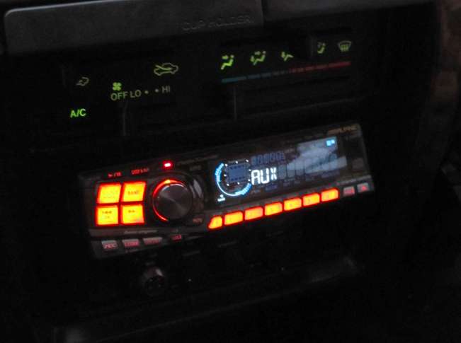

Alpine Premium Head Unit
Here is my new (used) Alpine 9835 MP3/CD Head Unit. I cannot stress enough how much of a difference the 4V pre-out, 109db signal to noise ratio and the TILT feature make this thing awesome. Bought on ebay for $109 + $99 for a new faceplate.
Alpine 9835 Features (2004)
1) Tilting faceplate (big deal on 4Runner, means no glare)
2) 4V Pre-outs (to my two amps)
3) Nice big clear buttons
4) Almost a 100 professional audio features, thats why they were $500-$600 back in day
5) 109db Signal to Noise ratio ~ translation: amazing audio quality :)
6) 3.5mm direct-wire audio input
7) Plays mp3 playlists from CDRs (yes they still exist)
8) Factory pre-set 6 band EQ
9) Alpine V-Drive 27W RMSx4
10) 512 Color Display

Speakers, Sound Deadening, and new wiring
