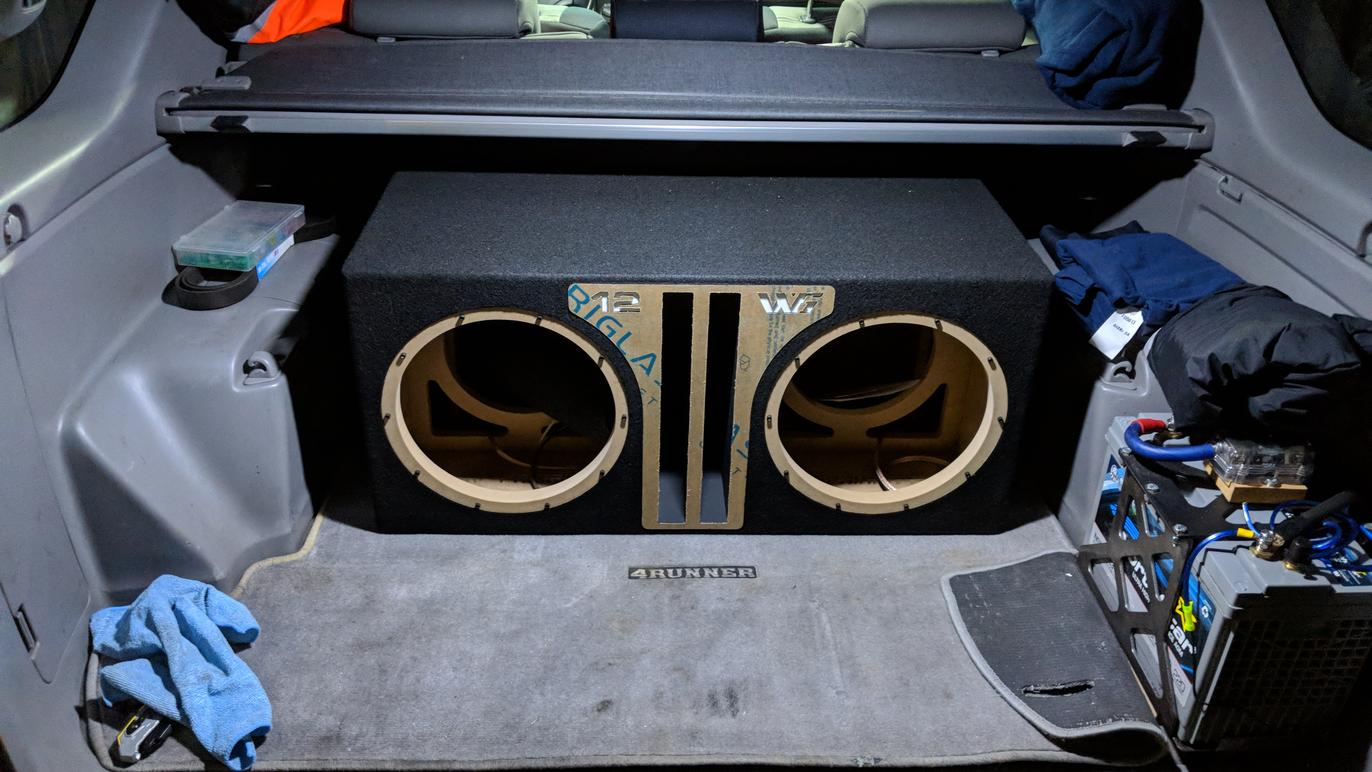

any more update on your current system?
since you use an external dsp, should your amps run full range with no crossover settings, or amp crossover turned all the way up just to use the boost knob. your external dsp has crossover settings right?
im at another upgrade right now.

Hey riceandpho,
"Nice box"! I was using the 'mini-DSP in-a-box' x-over but I stopped using it because I was getting frustrated as it has a (PEQ) parametric EQ which that alone has sooo much flexibility of about 18 bands of user adjustable center frequencies (I only use about 5 center freq. for the sub; lowest set to 30 HZ, highest is 80 HZ; to say nothing of it's adjustable 'dB's per octave slope' flexability!
Now I'm just using the adjustable 'High-Pass' filter built into the amps, and it's low-pass filter on top of the bass to blend with the stock door speakers! What size are the two holes in your new box for; ten's, 12's... It looks very nice and well built! And did you add any amps to drive those subs? 'Best',

12s.
waiting for the sale my dealer has, so itll fit 12w6v3.
box is from avpriority
amp is still the same, keeping my rockford fosgate t1000-1bdcp
will be driving everything down to a 1 ohm load. wouldnt mind trading the amp to a 1500 version, will be a tighter fit in the storage compartment.

[MENTION=5149]riceandpho[/MENTION]
Nice box... One tool I wish I had many years ago was a CNC router table, it really takes making a speaker box to another level.
I wish I had the box more custom. Wanted more width , but having a shop do it. I got quoted almost 500 to 600 . I was like God damn. I was looking at the ground shaker boxes, seem to work, but avpriority has this box build to spec. Very good product. I still haven't peel the tape off the plexi center. Looking to buy 2 woofers and 2 grilles this coming week.

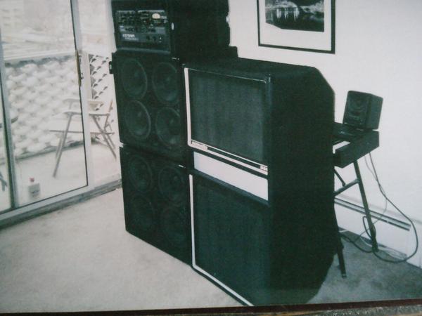

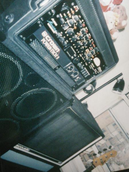

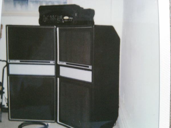

Hi soap94,
Using car audio subs for musical instrument reproduction (especially low frequency instrumentation) is 'NEVER a good idea'! Musical instrument reproduction equipment is designed for the purpose of throwing/projecting it's low frequency wave-front a substantial distance from a stage; I just happen to be a bass player who's worked a lot of large venues. Here's a few photos of my stage rig:
So that Pro-sound low frequency wave-front reproduction equipment was designed with a high to very high efficiency ratio... it's not how much power the equipment is capable of, but rather, how much sound the speaker system is able to reproduce and at a given dB level into the audience!
Now, car audio applications are designed with the expectation that a certain amount of 'Cabin-gain; usually 12 to 15 dB (decibels) of 'apparent volume', will factor into the design equation with low frequency wave-front reproduction! And if you are familiar with the spec sheet standards in both applications, you know that there could be as much as a 20 dB difference between these two applications!
I think my car audio sub sensitivity (no cabin gain factored in; just full field measurements) is 90 dBs 1w/1m. But my stage rig can create around 110 dB at 1w/1m... so there's no fair comparison going on here; but then my stage rig cannot create or reproduce that level of sound output at 25-30 hz! So there is a substantial difference built in to the design objective from the engineering POV!
