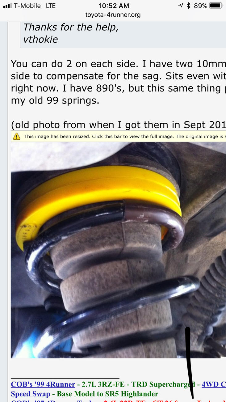

If they installed the trim packers correctly, I don’t see how they could of moved “off center”.....look at this pic. The bump stop keeps the spacer centered. Did they incorrectly install the spacer on top of the bump stop??
