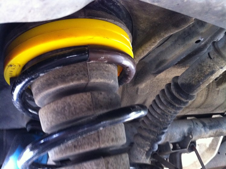

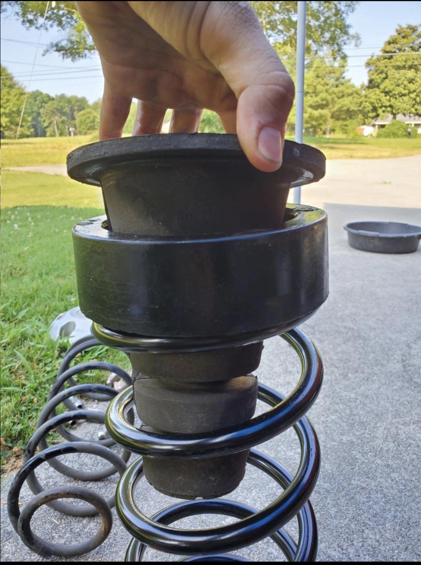

Hi sorry to revive an old thread and an old topic. I’m trying to do the exact same thing in my new to me 3rd gen 4runner. I’ve seen pictures where the trim packers went between the coil and bumpstop. And when using the daystar, they also went between the coil and bumpstop. I attached said pictures.
So if i’m using them in addition to the daystar spacers, is it confirmed that the trim packers go on the very top next to the body?
From top to bottom: body>trim packers>bumpstop>daystar spacers>coil
Or should it be
Body>bumpstop>trimpackers>daystar>coil?
This would mean the trim packers are securely inside the cone instead of on the very top with the possibility of them sliding out.
I’m inclined to think that the daystar with its concave shaped groove should sit next to the coil. Please correct me if I’m wrong.
I’d appreciate your feedback.Thanks in advance.

^ this, although I wouldn't suggest two spacers. That looks like something might get squished out to one side after a while.
