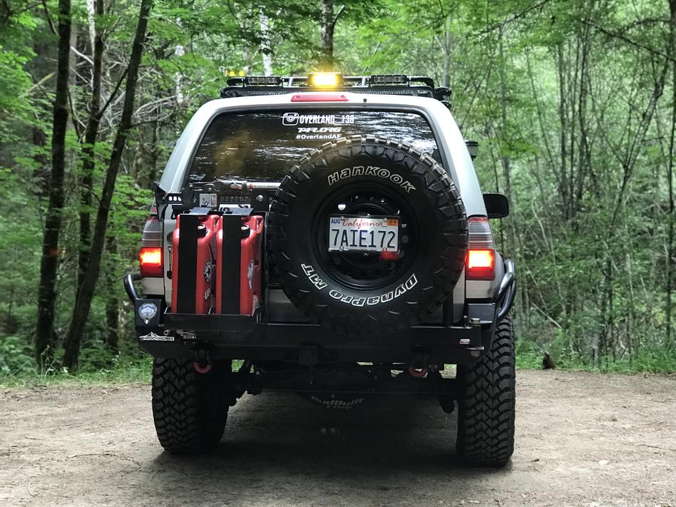

I've got a rear steel bumper, swingout with spare 35, & cargo drawers, along with the factory conical bumpstops on the 861's, and have just a slight rake with the front coils on the 2.5" perch on my bilsteins. It's great in my mind - much better than the LC coils I had previously, but if I still ran 285's and didn't have anything in the back, I would have kept those.

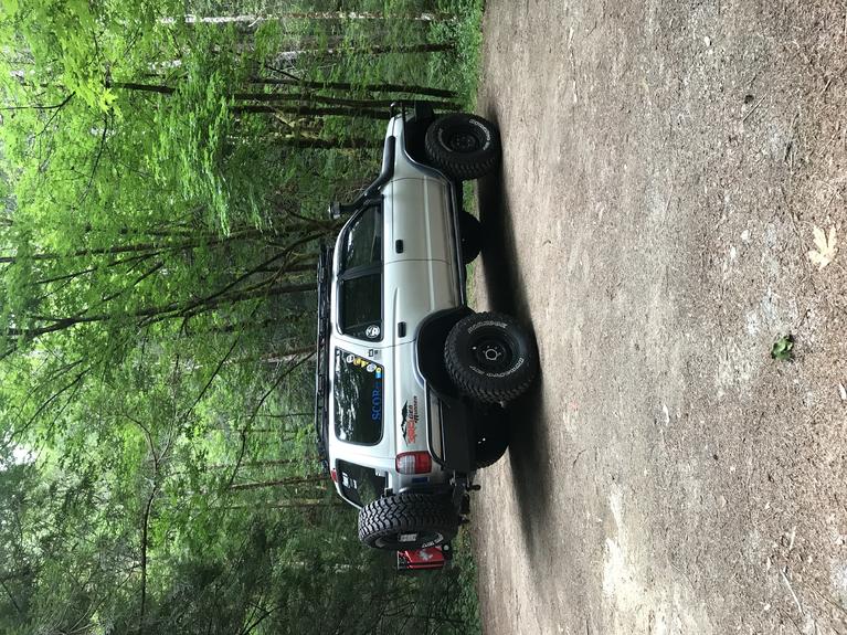

As shown, I'm at 4-4.5" lift in the rear and 2.5" lift in the front. My front fenders are trimmed 1.25" which makes it look taller in the front than it really is.
IMG_7965 by Brandon Faliszewski, on Flickr
IMG_7988 by Brandon Faliszewski, on Flickr

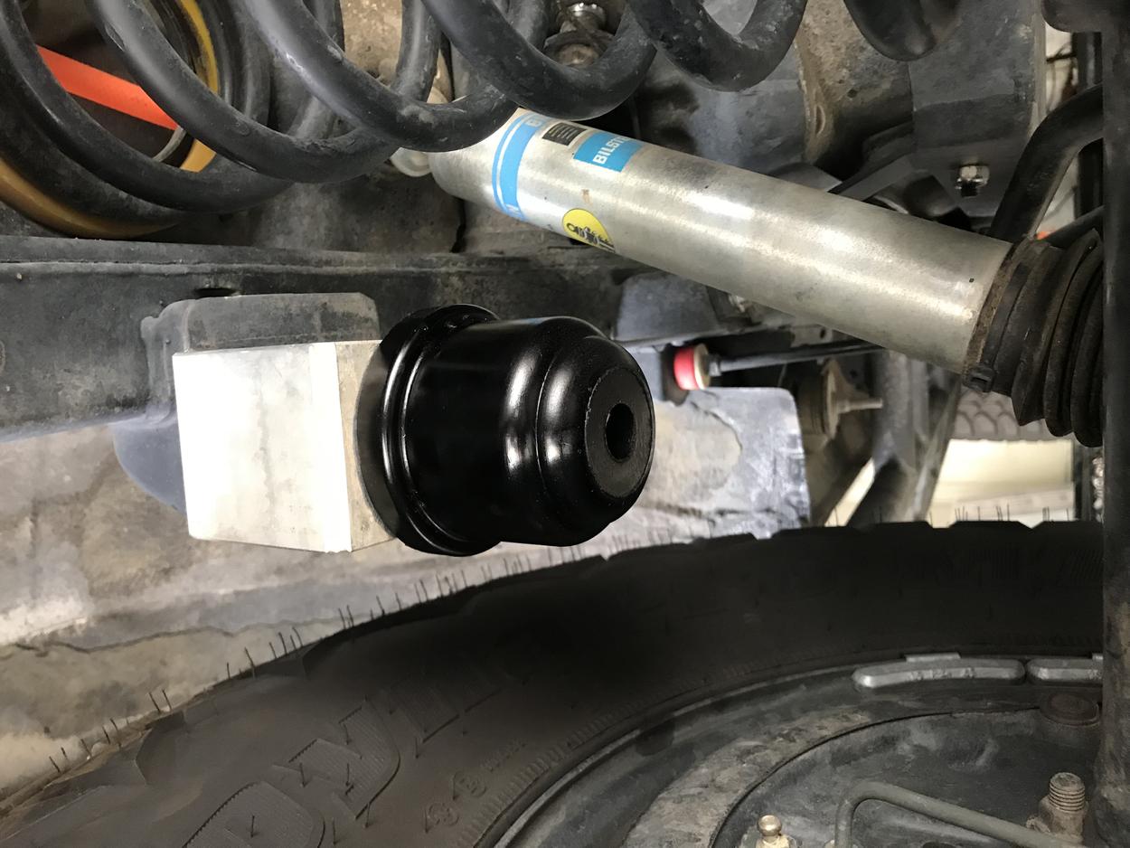

I had the superflex without the Shrockworks rear bumper and tire carrier, worked amazing and the flex/ride on and off road was awesome. When I got the Shrockworks rear bumper the superflex couldn’t handle the weight and would bottom out right away even over a speed bump.... now I’m running 851’s and have zero complaints. I’m also running dual compressors with an air tank back there, a hi-lift on the bumper and 2 gas tanks, also full skids, sliders and a roof rack. They flex like crazy and ride really well combined with the front range off road links, fully loaded I sometimes do hit bumps HARD over unexpected whoops in the desert but after I swapped the bumps for wheelers off road Tacoma rear bumps it honestly hits bumps really nicely. You can barely feel it!

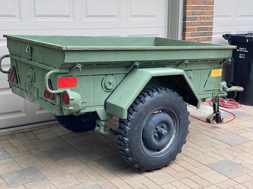

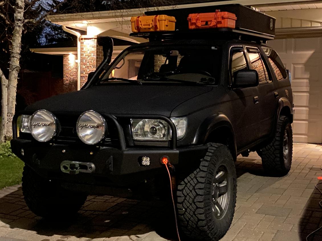

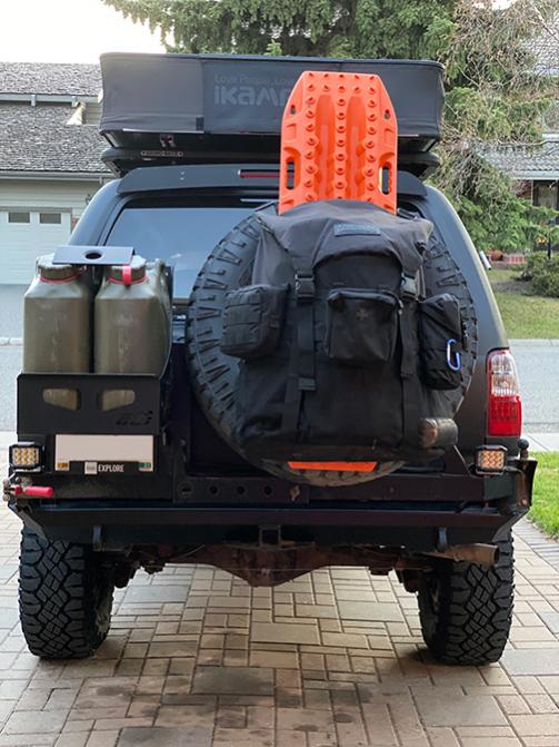

I'm currently running LC 9 wrap blue/pink/white's (heaviest) and they're struggling hard to keep up with my weight. They are paired with adjustable Fox 2.0 w/ remote reservoirs, which I love. I have a heavy rig - CBI swing out with 33" tire and 2 jerry's, fridge w/ slide, drawer system, kitchen, 15 gallon H2O tank where the spare used to be, air tank, subwoofer, amp, lots of dynamat, 2 water pumps, yellow top, max trax, trasharoo, propane, lights, roof rack, and roof top tent - and that's just behind the rear axle. I would like to add skids and sliders, but I'm currently unable to handle the weight. With the family aboard, I'm pushing 6200 lbs!
Oh, and I just bought a trailer, so a couple hundred pounds of tongue weight on top of that.
I'm probably one of the heavier 'runners out there.
The debate is between 861's and 850's. I'm worried the 861's won't be enough. I'd love to hear some feedback from you guys with 861's on what you think I should do (besides buy a bigger rig!)

Have a couple pictures of your water tank set up? I'm getting ready to put a 10 gal water tank in the spare space.
I've got a brand new set of 861s i might get rid of. I'm thinking of going with Dobinson 210s instead since I only have a bumper, swing out, full size spare, awning, sliders and skids. With that, the 861s might give me too much lift.
I’ll PM you...
