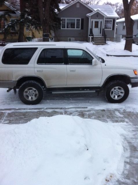

I have a '00 with OME 881/906 setup and I'm getting some rear sag. Is this common with those springs? They are about 25k (KM) old.
In any case, would a couple 10mm spacers level me out?
I haven't measured it but it's quite visibly evident. I'll try to post a picture later this AM.
Thanks for the advice!
Here is the picture.......maybe I'm dreamin' but I feel like I need to put some spacers back there?

Fair enough- old owner put this setup on.
Is the best/cheapest way of fixing this a pair of spacers in the back? I was thinking of just getting 2 10mm spacers.....will this level things out?
I don't really want to replace the rear springs entirely unless spacers are just generally a bad idea or won't fix the problem.
2 10mm spacers per side should do the trick. But I think they're $10 each, so $40 total. You could probably find a used set of 890's for not much more and sell your 906's when you pull them out.
Like stated most likely its a little sagged and those springs are not that tall anyways. I would look in running 7 wrap lc coils, I have them and love the 3.5" lift they give.
906's are barely tall enough to run with the 98 coils I run up front, they are better than stock but they are only a half inch taller than the fronts.
So big difference between going with the spacers or the 890s would probably just be a stiffer ride on the 890s?
Anything I would need to worry about with spacers when I'm on the trail? I don't go rock crawling but we use it for canoe trips where we take quite a few ugly logger roads up North.
890's will probably ride a little nicer actually, taller softer spring rate. 7 wraps ride great nut they're a little too tall for your 881's IMO.

I was just about to post this, I thought I had read that the springrate on the 906's was actually stiffer than the other OME springs. Using the proper spring for the job is the correct way to fix this, and I'm sure there are lots of guys with stock sagging rears that would LOVE to snap up your old 906's.

I have tundra 5100s up front and 906s in the rear with 10mm spacers and I'm getting about an inch of rake. Those 881s up front are too tall for the 906s. Either switch to 880s (close to stock) or change the rears to 890s. Frankly, I'm thinking of pulling out my 906s and switching to 890s too. I like the height but if I lose the spacers I should be close to the same height and it shouldn't ride so stiff. Hit a speed bump and it's like riding in the back of a school bus.
I installed 881s and 890s yesterday. The 890s are a little higher than the 881s, about an inch or an inch and a half. There is about an inch of front leaning rake, but IMO, it looks great. Can't wait to see how they perform on the road.
