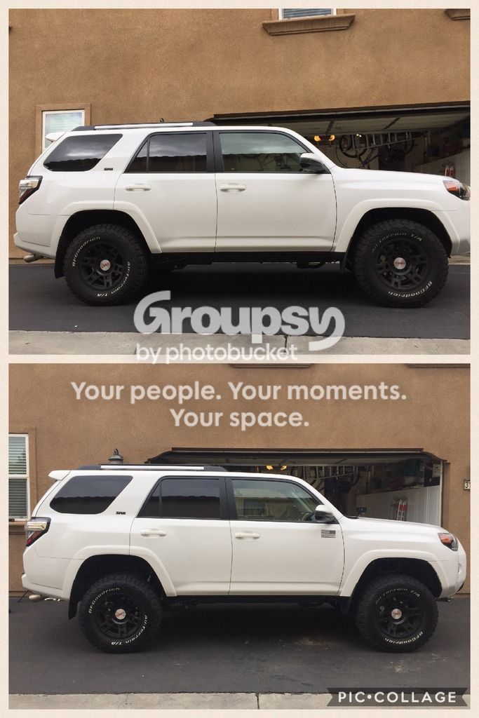

I have Bilsteins with 884 on the front set at 0. At first it gave me 3" but settled about 2.5" after a few days.

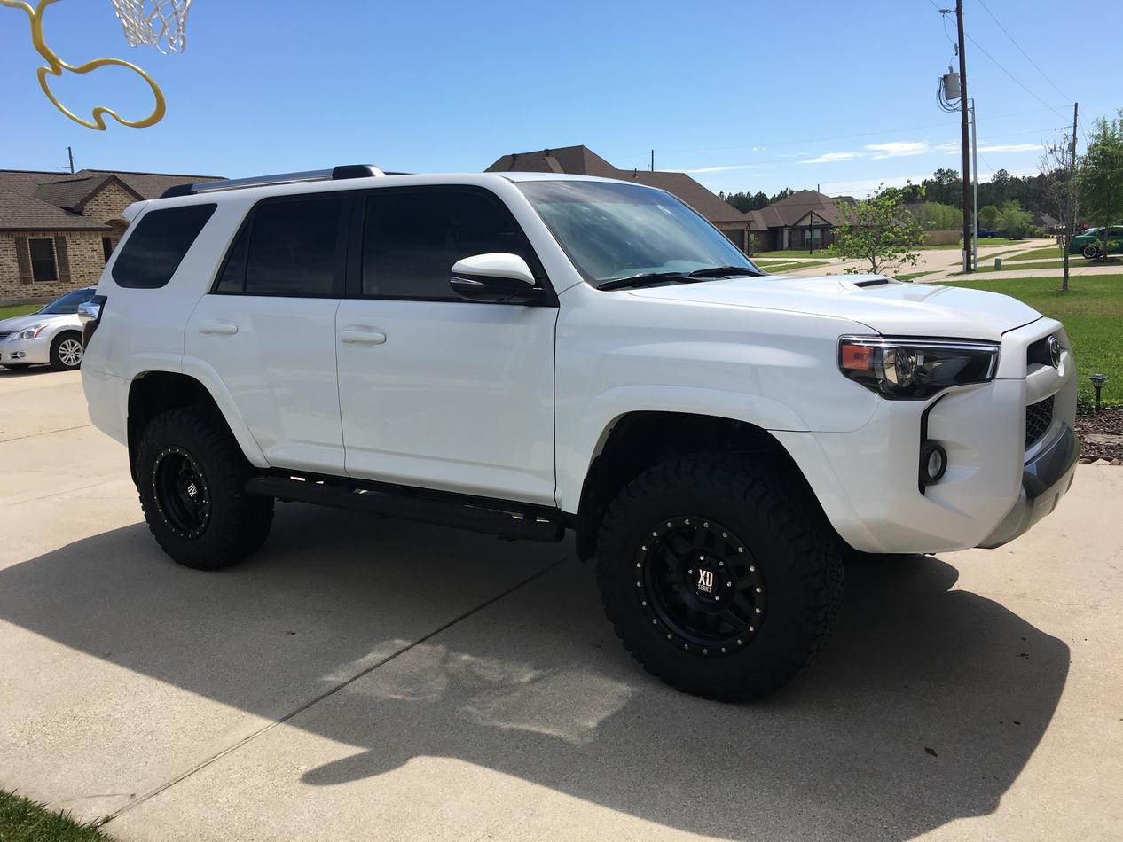

Finally got it all done 5100s w/ 884s and 5100s and 1 1/4 Cornfed spacers on stock springs. Went with 275/70/17 KO2s and XD Machete wheels with -12 offset. Looks like I will need the 1/4 spacer for drivers side, it sits 1/2" lower. Really doesn't bug me so I might just keep it the way it is. Thanks @stphnman for the help and all the other members I bugged when I had questions.
Looks great!
