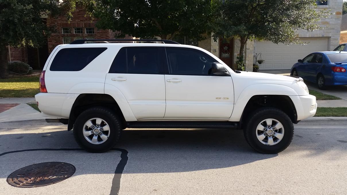

I'm almost running a similar setup on my 4runner like what your talking about.
Front: 5100s, OME 885, Toytec 3/4" spacer. Rear: Stock Shocks, FJ rear Coils, Daystar 1.5" Spacer.
I ran that set up for a week or so (top pic), it was nose high and I didn't like it. I put in the OME in the rear and it was much better (bottom pic). I still have bilsteins in all corners, it's a great set up.
What ome did you run in the back, 895, 895e?
