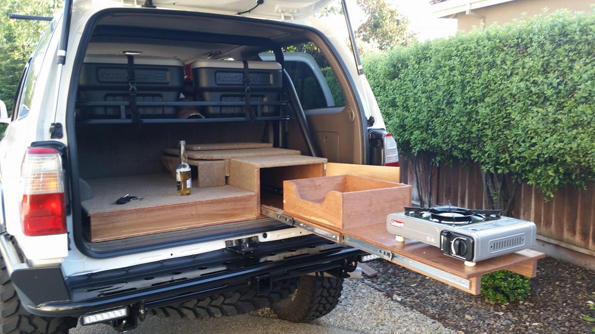

So this is a great question as I am currently facing a decision myself. I've had the 890's on for about a year and a half. But since installing them I've done some work in the back of the Runner including a steel bumper (and occasionally towing). I have so far lost about 1/2" since originally installing the 890's. Not the end of the world but I've developed a slight bit of that butt sag back which I cannot stand. I am deciding now between adding spacers or switching to the 891's. Only reason I worry about the 891 is how folks talk that the ride is just too stiff for our rigs. When I off-road, particularly in the rock gardens, I already get butt wobble. I just assume the 891's would give me even more wobble. I have zero complaints about the ride comfort of the 890 both on and off road it's just that I have permanently added about 220lbs on the back of my rig and even more when I load up for a trip. I spoke with the Toytech guys and they said I could go either way and I'd probably be equally as happy with the results.
