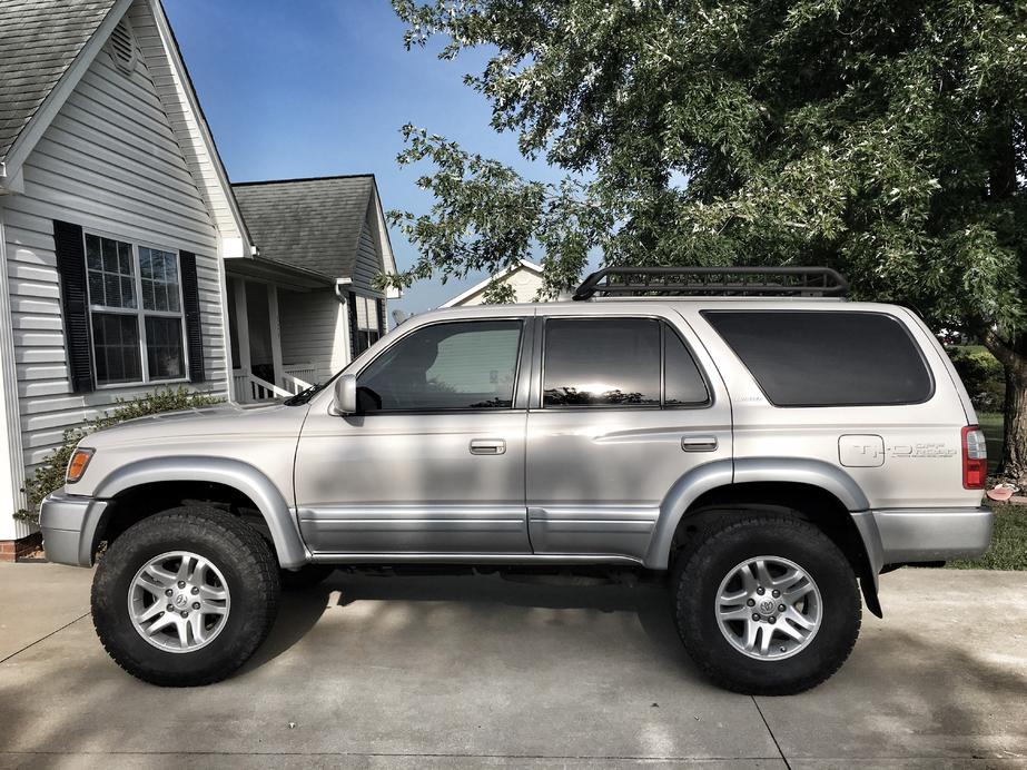

Do you have a side view of this setup??? With the front on second perch and rear 890 coils??? And maybe a hub to fender measurements? Below is my current setup. 906 rear with 5100. The front still has stock with ~2.5 inch spacers. I like the height in the front so thatspacer why I wanna do 2nd perch when I install these trd coils. As you can see it currently sits about .75" to 1" lower in the rear and I want more of a leveled out look with some stiffness so the 891 may be my go to.
I'll get you some fender to hub measurements.
Hub to fender measurements
F/L - 22.25
F/R - 22.00
R/L - 23.00
R/R - 22.75
This is with 1/2 tank gas. I'll try and get a picture later on flat ground

Not a great pic but may give you an idea. Full tank of gas
I may have to get 890s, more my TRDs to the 2nd perch and sell my 906s. I think I could live another .5 inch of lift.
I agree.. I'm not a huge fan of any rake but a slight bit won't hurt. I put my trd on second perch and love the height. But I'm exactly an inch lower in the rear with 906s
