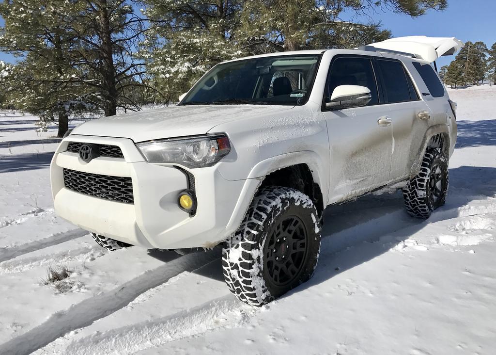

Hello all, I'm looking for any advice from folks who have or had the OME BP-51 suspension system. I've got over 20K miles on mine and just recently have developed a very loud creaking sound and I think it's coming from the passenger side front shock. I've already lubed up every other component I can think of and sound is still there anytime there's up/down movement.
Has anyone had these shocks or coil's do this after some mileage put on them? Any ideas on how to verify the issue is actually coming from the shock?
The noise is so loud I can't isolate exactly where it's coming from because it resonates thru all the components in that vicinity.
Heres the link to the previous post I made: http://www.toyota-4runner.org/probl...front-suspension-ome-bp-51-a.html#post3022035
Thanks in advance! Jim-
It's a 5th Gen T4R, SR5 w/ 40K miles. Suspension has been on for most of that 40K. I do have Spidertrax 1.25" wheel spacers.
