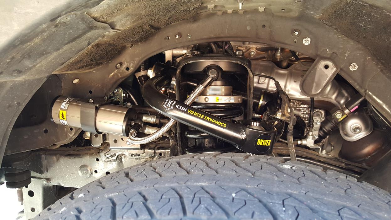

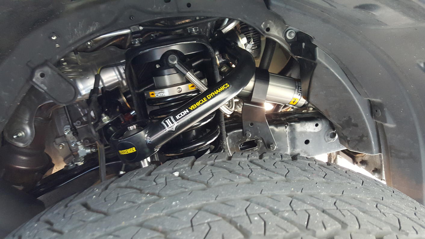

Spent some time wrenching on the 4runner. Don't like the way the driver side reserve is mounted. Need to call about that.
Set the preload on the front to 15mm. I have an SSO front bumper and warn zeon platinum 10s ready to go up front.

Yeah, that seems off. Let us know what they say. I won't be pulling the trigger in these for a few more months so perhaps we'll have an official bracket by then.

I bought this kit back in March of this year. I kind of knew it wasn't right. I'll see if they have a solution or fab one myself.
Sorry for being naive, but what is the issue with the drive side mounting?
it is outside the frame rail, whereas on the passenger side the resi sits on top of the frame. I don't have this kit and haven't seen one in person, but it looks like there may be a chance of hitting it at full lock when stuffed, or there is always the possibility of hitting it with debris. all and all, the passenger side appears to be much better protected.

It doesn't make contact at all with the tire. It's mainly not as tucked away on the frame rail on the drivers side when compared to the passenger side. KDSS plumbing lines on the drivers side are the reason for the drivers side reservoir bracket not being as tucked away on the frame rail as it is on the passenger side.
It looks as though there is space in front of the wheel on the frame as opposed to trying to mount it in the rear. Is that not a viable option?
