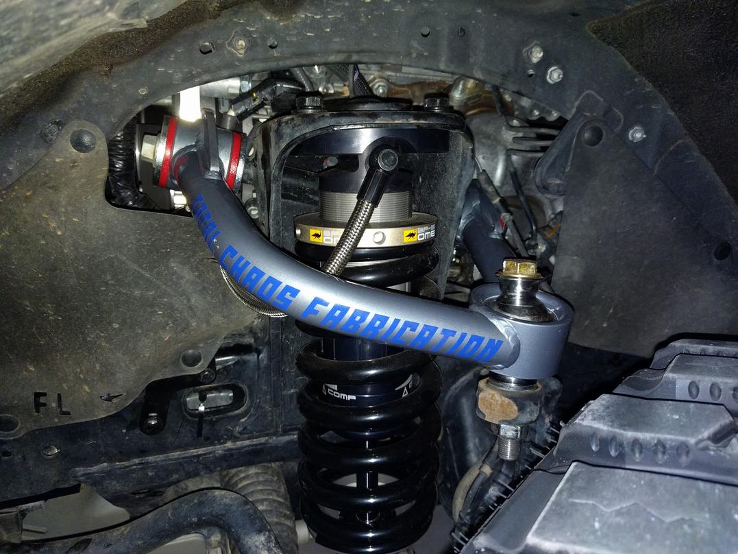

I think a good number of us have installed this kit with no regrets. My biggest draw was the kit working around stock components like the UCA. I'll change my UCA at some point, but didn't want to do it right away. Adjustable compression and rebound, internal bypass with reservoirs, what's not to love!
Really curious after I saw your picture just "how" this works without a new UCA and 3" of lift vs. others?
I thought it was inevitable that all 3" lifts required a new UCA.... I'm intrigued

[MENTION=146469](none)[/MENTION] I adjusted my preload to 12mm of thread from 20mm (bumper, battery, winch) and there is still more to go. I couldn't say for certain that you could get all the way down to 2" but maybe.

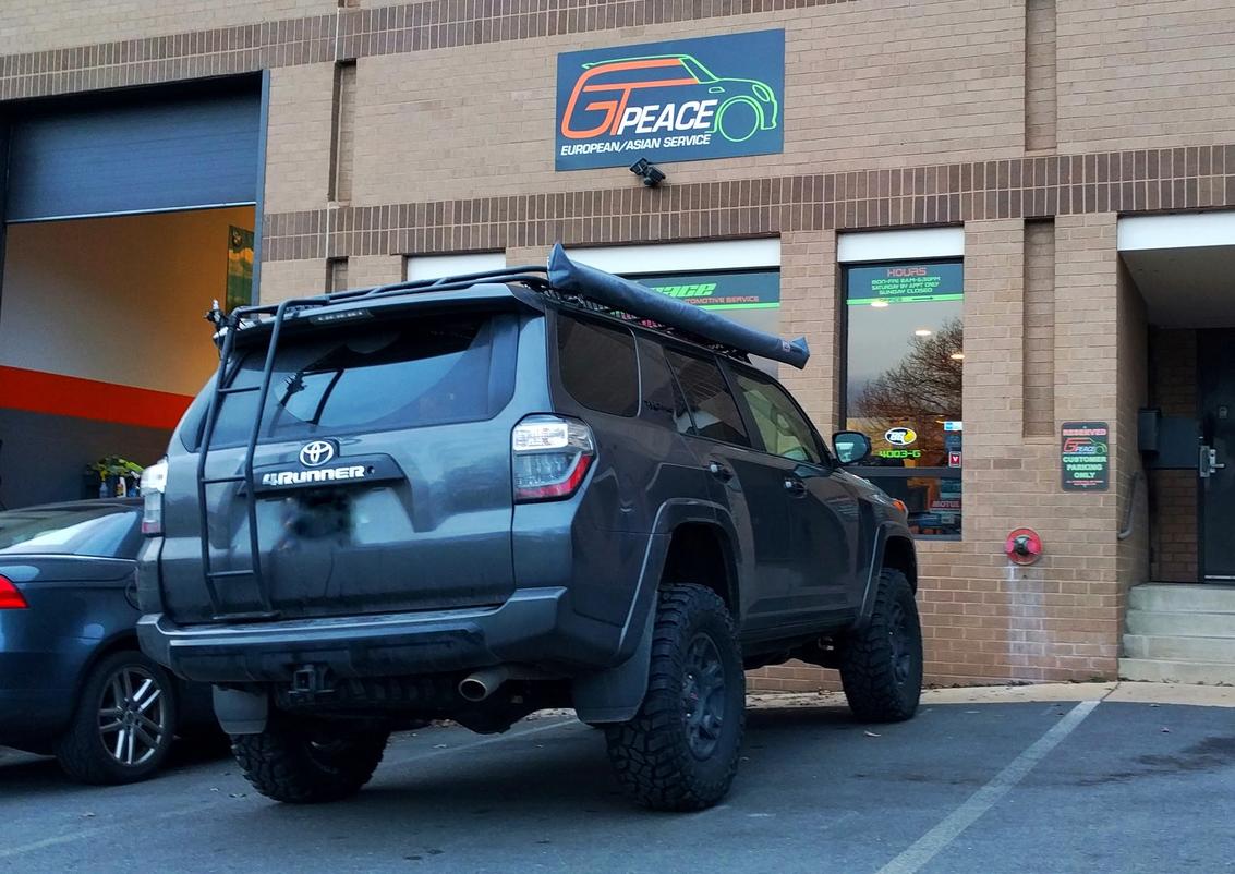

Following up on my prior post:
Shout out to [MENTION=99235]Scott@Hightech[/MENTION] from gtpeaceauto.com for doing the install and being an awesome guy. Anyone that's anywhere close to the Northern Virginia/DC metro area looking for a 4runner-specific shop should give him a call or connect through the forum. This was my first experience with Scott and gtpeace, but anything in the future that's outside my depth (or time availability) will be going through him.

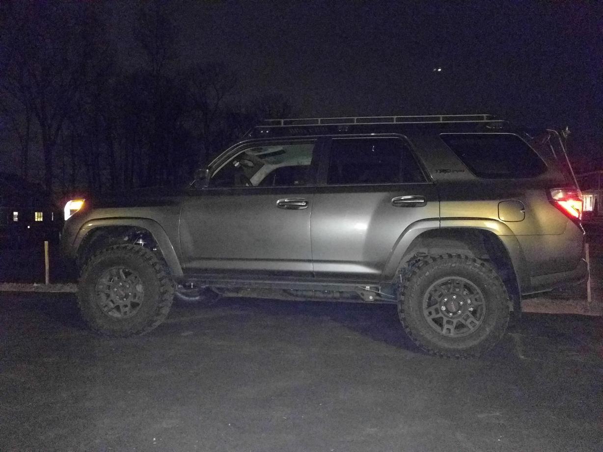

-- As promised, pre/post install measurements attached below --
Prelift/stock tires (Nitto Terra Grapplers @ 265/70/17):
Center of wheel to fender
Front: 20 4/8 in
Rear: 21 4/8 in
Floor to fender:
Front: 35 1/8 in
Rear: 36 1/8 in
Rear diff (floor to bottom of diff)
9 3/4in
Post lift/tires (Cooper STT Pro @ 285/70/17)
Front: 23 4/8 in driver
23 5/8 in passenger
Rear: 24 4/8 in driver
24 5/8 in passenger
Floor to fender:
Front: 38 4/8 in
Rear: 39 3/8 in
Rear diff
10 3/4 in
Tire pressure @ 38psi (need to test for even wear @38psi -- discount tire recommended 43psi -- anybody here already dialed in a good road pressure for these?)
Front compression @4 (from OME)
Reb @6 (from OME)
Rear Compression @3 (from OME)
Reb @6 (from OME)
Drove it around and tuned the rear comp/rebound down to @2 and @5 due to 889 coils riding a bit stiff w/o load/fridge in back
Obligatory pics attached.
