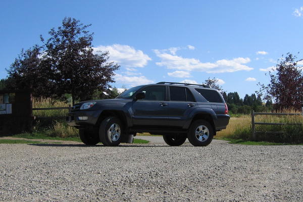

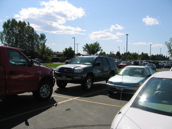

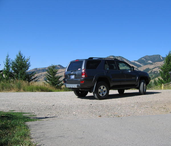

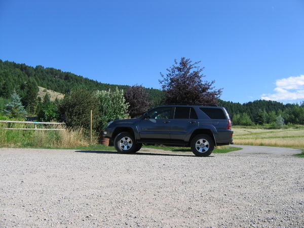

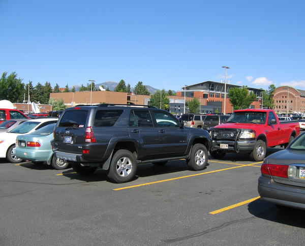

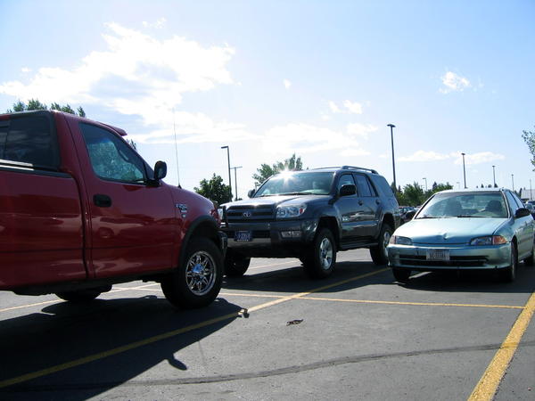

Pictures below. Please note on the third one down, the truck is sitting on a bit of an incline, which makes the truck look nose-high. The truck is level. Tire size is 265/70/17

I'll post pictures soon. I bet once you see the pictures you won't think it's too much lift. It looks and rides very natural.
