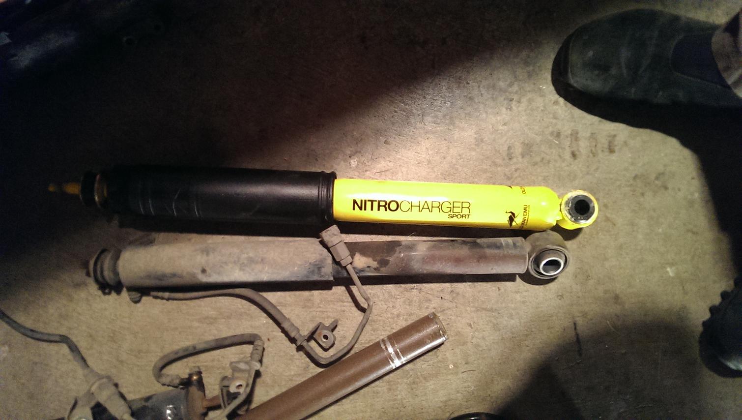

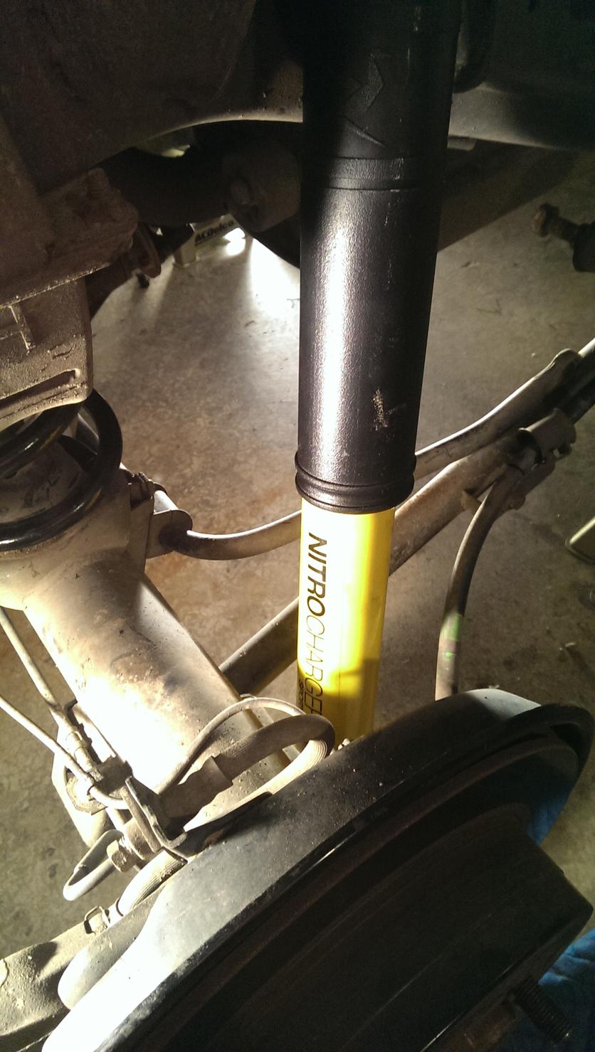

I just replaced my original Xreas suspension at 199,000 miles with the OME Nitrocharger Sport and a set of brand new FJ Coils from Toyota. I know I know waited way to long. My rear shock was actually frozen solid no compression at all. Anyways the ride is just right with this setup, minimal lean around corners, not to harsh and the BREAK dive is completely eliminated. Wish i would have done this 150,000 miles ago. I do have a v8 and plan on doing a hidden winch mount in the near future. I ordered my stuff from Metal Tech, Thanks LT for all your help.

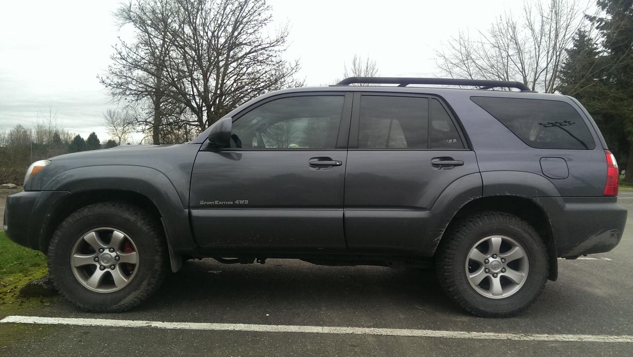

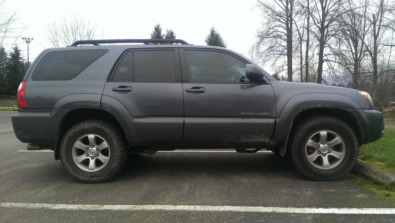

Pics of my V8 Sport running FJ Springs/New from Toyota and OME Nitrocharger Sport. Tires are 265 70 17 bfg at ko.
