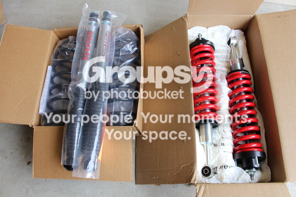

I dabated between OME and Toytec. I was set on Toytec 3"(the one with 5100's up front) mainly due to price. I didn't care(so I thought) about adjustability. When I ordered them I received an email noting they went on backorder. Since I was ready to pull the trigger, rather than wait I went with the Boss kit because it was in stock. So glad I did. Being able to adjust height to get the CV angles and height combo I wanted ended up being very important.

Do you have any pics?

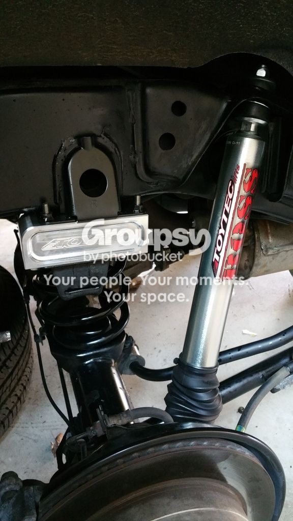

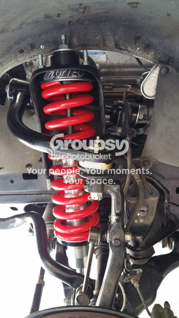

I've only had mine installed for a couple weeks and I'm not a hard core offroader. Mostly light trails, camping, and I tow. With that said, road manners are great and it's more than I need for what I will do offroad but XREAS was shot and needed to be replaced. I haven't even gotten an alignment yet and I'm on balding tires with 50+k miles on them and I was surprised how well it drives. I'll likely never need the bump stops but at this price point it was still worth it to me. Like I said I wanted the 3" with bilsteins and think it would have fit my needs but in the end the adjustability ended up being worth the extra money. The Boss kit has 600 lb front coils and the 3" kit has 620lb which is the only thing I've read that people didn't like maybe too stiff especially if you have a V6. Obviously I can't comment on longevity yet but I'm glad I bought the Boss kit.
I just ordered the OME 885 front setup with Toytec Superflex rear setup to replace my XREAS system. I debated for a while over a few kits.
A couple pics ...
