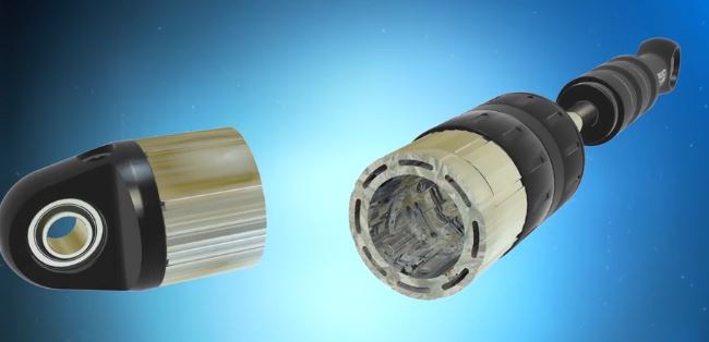

Just did some research by watching their video. While the outside of the shock body is 2.5", the piston diameter looks to be closer to 2" with the internal bypasses taking up the extra space in the thicker than normal shock wall.
Hmm interesting. It looks like a very cool system. Wish it was already in production for 4th gens.
