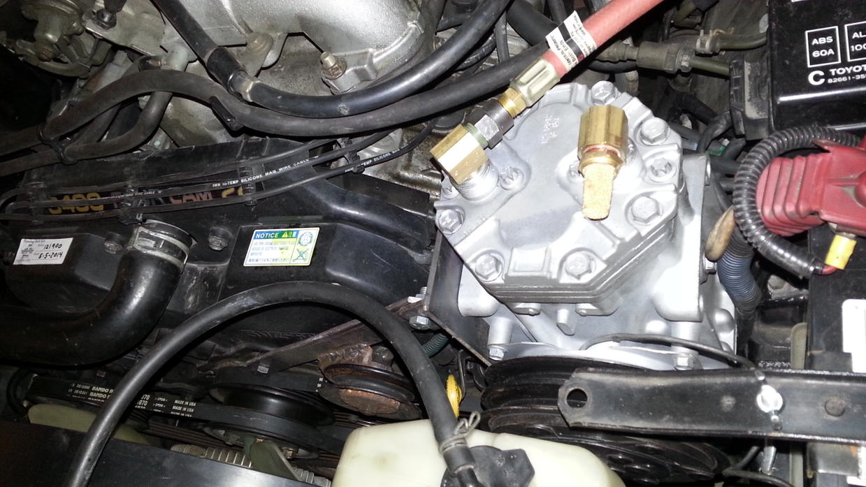

I mounted a York 210 compressor under the hood. It's powered off the alternator with a modified v-belt pulley (belt not installed in this pic). The install is more complicated but it's the route I wanted to go for various reasons. Only running a 2-gallon tank right now but am planning on installing something bigger soon.
