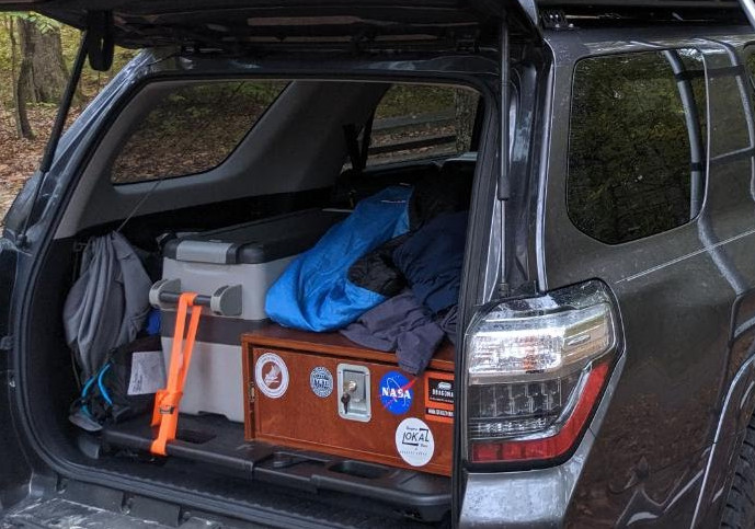

I also have a sliding rear cargo deck and to secure the fridge I drilled one hole in the rear of the tray and installed a D-ring, I secured the front of the fridge to the handle of the cargo deck, see photo attached.
I decided that I didn't want to hardwire the fridge to the battery since I didn't really know all too much about the low voltage disconnect and didn't want to run into issues with running down my battery. What I opted for was a lithium battery that runs the fridge and charges from the cigarette lighter port when the car is running. I have the rockpals 300w which runs the fridge a good 7-8 hours baking in the desert heat and significantly longer in cold weather conditions.
One issue i have with my fridge is that the lid opened vertically instead of horizontally, taking up lots of room. My lid would just about open completely in the back so I didn't have to hold the lid open when I was using it. I made a drawer to take up the 60% portion, the whole thing was secured to the sliding cargo deck so that I could just slide it out for easier access.

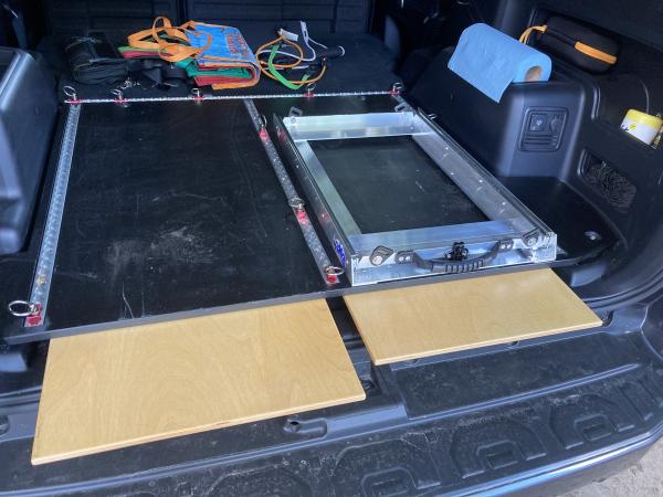

I did what was suggested in the above second paragraph, with a 500w Jackery lithium. I use a Dometic CFX3 35. I plug it into the 12 volt outlet on the Jackery, and charge the Jackery from the 12 volt 4Runner outlet while driving. I have a Goal Zero 100 watt solar panel to charge the Jackery when camping. I don’t have the slide on cargo tray but do have a DFG Off-road fridge slide mounted on a platform I made. I’ll try to post a picture of it.
CSI. I believe it actually an Indel. $549 shipped with transit bag — there’s a “never ending” GB over on a TacomaWorld. Built my own slide for a about $30.
