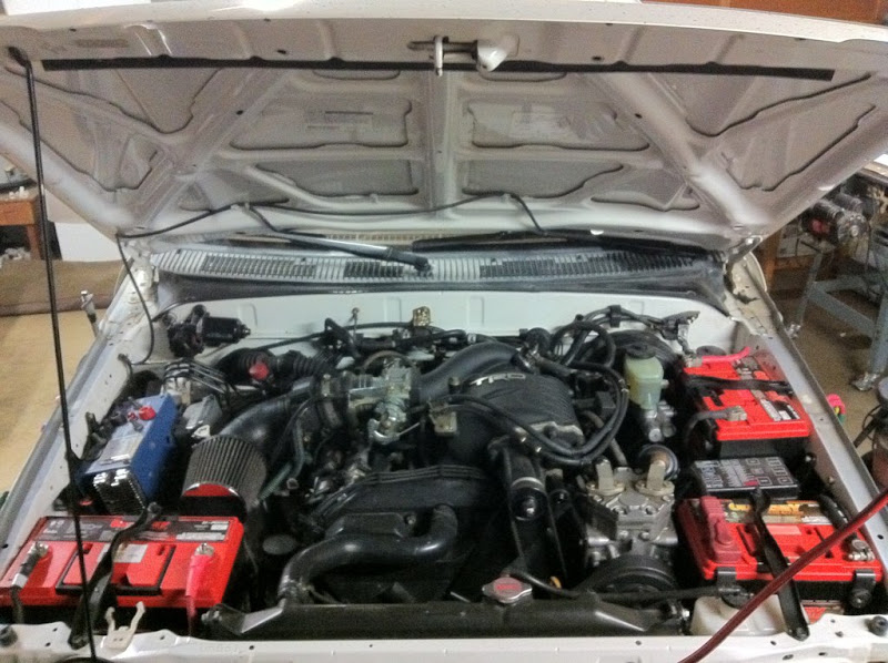

Not mine
^^^ Who's rig is that? That is the most packed engine bay for the 4runner/taco I've seen... 3 batts? Welding or what? Is that what the blue box on the left is?
Yes, that does fill it up. Sure looks like the Mobi or Premier welder to me.

The white 4Runner is stuffed. Three batteries, a welder, SC, York and a 5 speed which adds a clutch master cylinder. No doubt there is quite a lot of equipment that has been taken out or moved. The SC and air box delete does free up some room but heck 3 batteries takes it all back.
