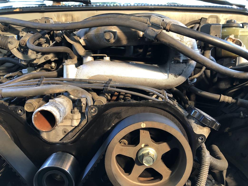

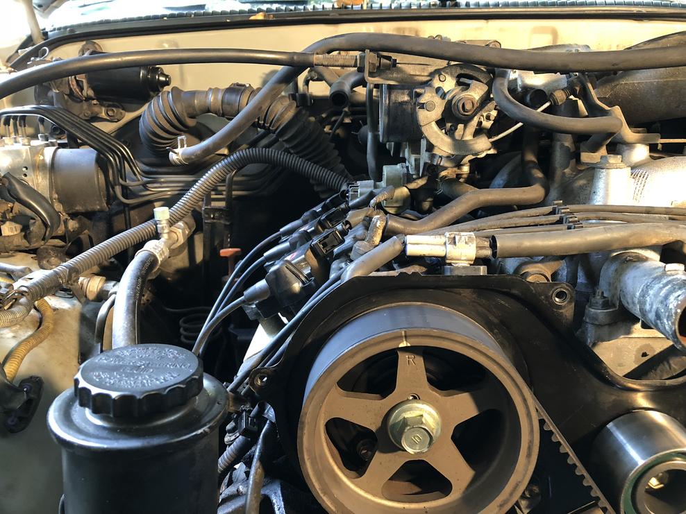

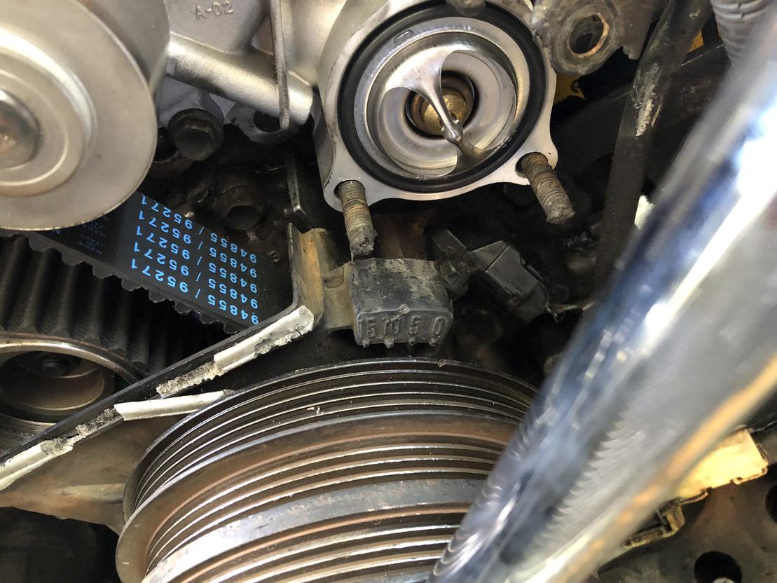

So this is where it's at, I tried to take pictures to best explain whats going on. So when the crankshaft is at 0 the two cams are both together at being about a tooth off from TDC. Do I need to pull it off and re-align everything? It only appeared off time after installing the new belt. I'm guessing the pressure possibly moved something, I'm not too sure.... ahhh

Yeah you're definately off a tooth. It's more accurate if you can pull the crank pulley and cover and get eyes on the sprocket itself. It has a mark on the engine and sprocket. From there, you can LOOSEN and not fully remove the tensioner bolts to relieve some pressure, clamp the belt on the cams with binder clips or close pins, pull the belt off the crank, rotate the crank the appropriate direction and install belt one tooth over.
What tends to happen is you put the belt on and slip it right onto the sprockets. Well, there is slack on the driver side of the belt system (since it rotates clockwise) and when you spin the crank by hand at first, the slack gets removed and placed onto the tensioner side (passenger side) of the belt system. Hence, making you one tooth off.
When installing, you want it to be difficult to get the driver side portion of the belt on the sprockets and have all the slack on the tensioner side. Does that make sense?
At any rate, you are indeed off time by what looks like a complete tooth.
If everything lines up as shown below, you should be good:
Yours does seem to be about a tooth off, but it's hard to tell without looking straight onto the pulleys.
