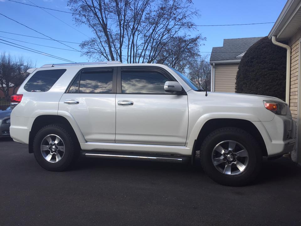

It's not to bad at all. Took a couple of hours but I did it with my buddy who has a shop and a lift and the right tools.
You'll either have to disassemble the UCA ball joint, or you can take out the two lower bolts that hold the LBJ to the steering knuckle. Either way will allow the LCA and the UCA to operate independently enough so that you have room to insert the spacer. I chose the latter method - up to you.

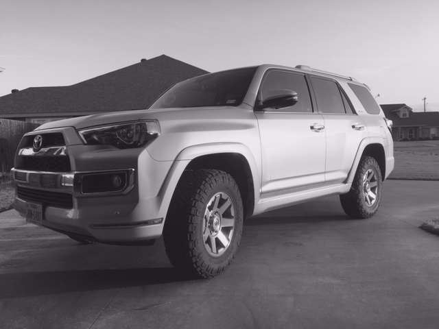

I installed the Cornfed 1" spacer last weekend. Took just over 2hrs, I removed the skid plate, sway bar, and separated the upper ball joint to gain enough clearance. It was pretty easy, and I even took my time.
