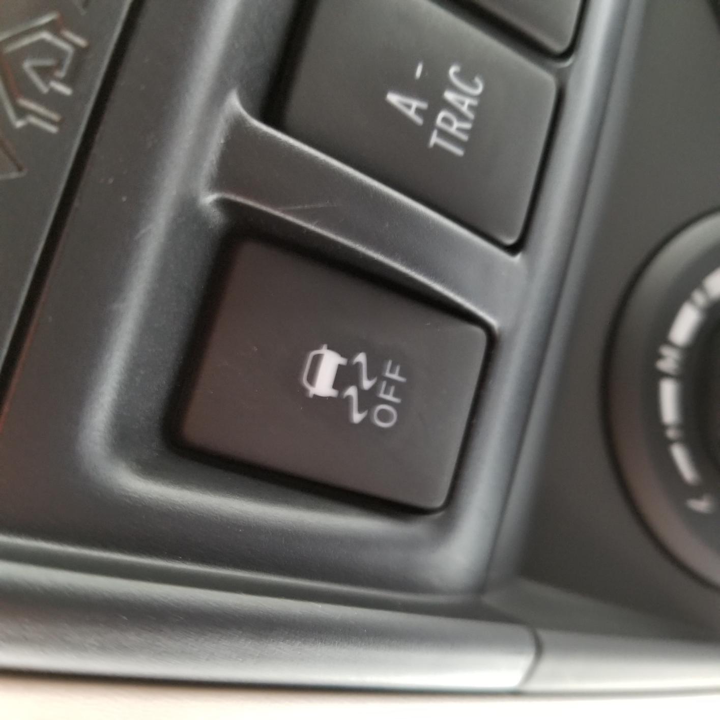

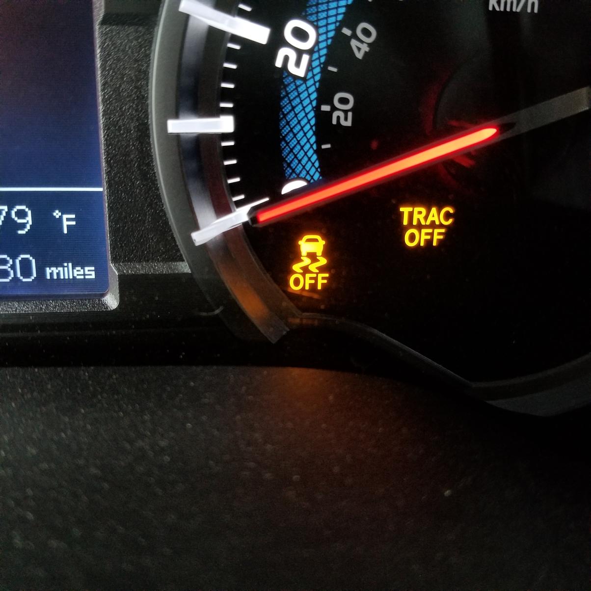

Does holding down this button in 2wd until these lights come on, do anything for the ride?
