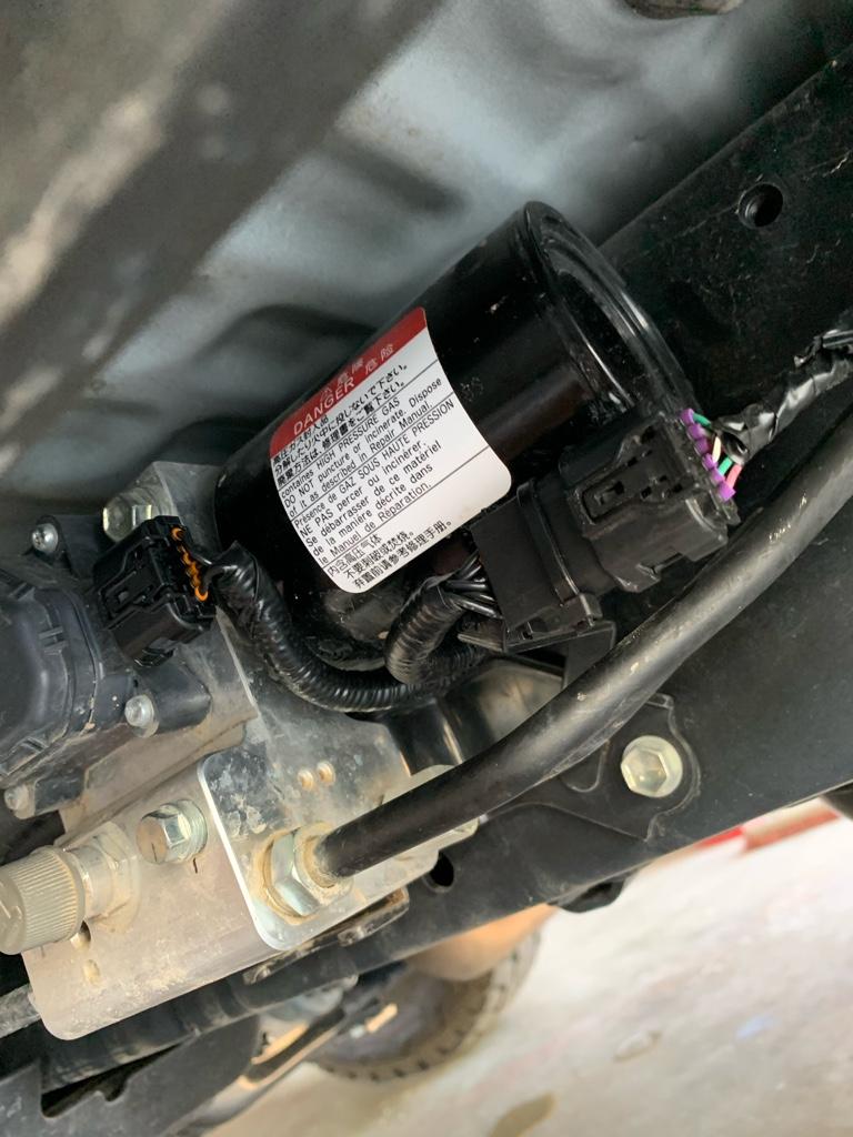

FWIW - visually the plug looks like a 6189-1083 Sumitomo connector or a 6189-7100. Without seeing the inside female end - I can't tell much more than that visually or even if it's a match. But it looks a lot like it from the Sumitomo catalog. I wish I was more of an expert in auto connector identification. I'm sure if you sent a photo to Sumitomo they could probably tell if it's a match. Otherwise I think you'd have to buy one to check. If I were doing it - I'd probably start by just testing the wire that goes to the shutter valve(s). I believe that the two valves are the light green and pink wires. I think the three other wires are for the pressure sensors in each chamber.
What's an unknown for me is what information from the pressure sensors and/or the valve positions is sent back to the power management control ECU and how that interplays with the various other motion control functions. My guess is that the result of KDSS as an add-on item means that it isn't a core component of the VSC functions and wouldn't cause a problem unless the pressures go above the max or something like that. I think max pressure is 1,200psi according to the guide on bleeding the system. You bleed it at 1,000psi and then back off the pressure to around 400psi, but it has a warning about going above 1200.

Another option is to use a relay to interrupt the signal at the KDSS ECU to the relay that closes the shutter valves. But I don't know what wire that is and it's a little more tricky to identify. If someone wanted to go crazy and map all the ECU input/output signals then you could match up the functionality and have more information on how to go about modifying the signals under the dash instead of out at the frame rail.
Edit: after looking closer it's pin# 1 and 3 at the KDSS ECU that correspond to light green and ping wires at pins 5 and 6 at the KDSS valve. So you could just tap them under the dash with no need to wire anything down to the frame if you wanted to avoid it. But it's a bit more involved to gain access to the KDSS ECU than down on the frame.

Hint: it's the light green and pink wires. Pink is the shutter valve for the upper chamber, Light Green is the lower chamber shutter valve.

What's missing in Chillfancy's original wiring bypass is that what you would do to make the dash light also go away is add the correct resistor circuit so that the ECU doesn't detect an open circuit when it expects to close the shutter valves. The bypass relay to defeat KDSS shutter valves should not open the circuit, but rather connect it to a resistor. I don't know what value is correct for this resistor without reading through the FSM.
