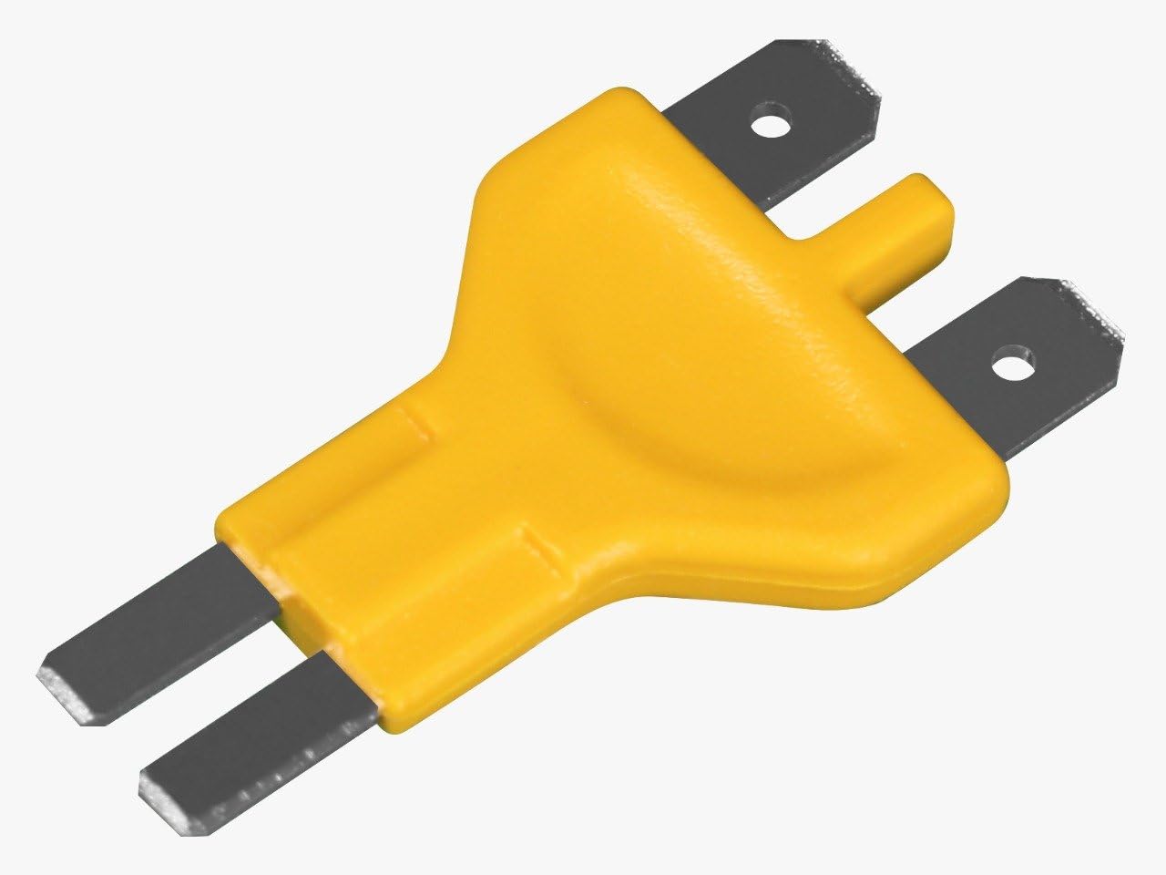

However - with that, I don't know if the temporary disconnect of the KDSS ECU would signal to the CAN bus to set some other code in another place. Just something that would have to try. You wouldn't need to do that at the KDSS ECU. It could be done at the fuse I think. So I'd probably just make up a circuit at tap in using what's called a fuse socket connector. Allows you to easily access a fused circuit in a plug and play type way and disconnect with your aftermarket circuit. A fuse tap can function for this and if it were wired up the right way it could serve both functions of powering the relays for the disconnect and cutting out the KDSS ECU to reset when turned back on.
They look like this - I don't see them used much, but they're handy for some situations like this or when you need to measure current to diagnose something:

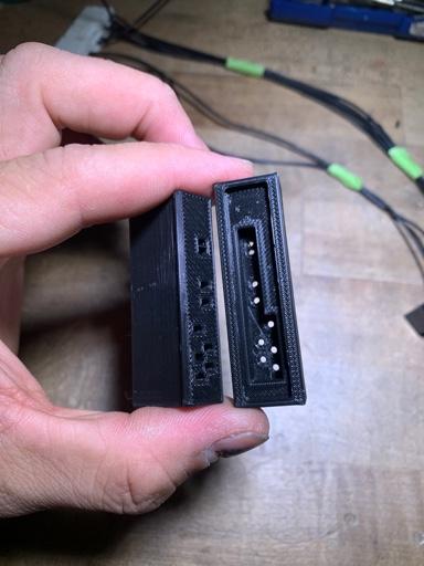

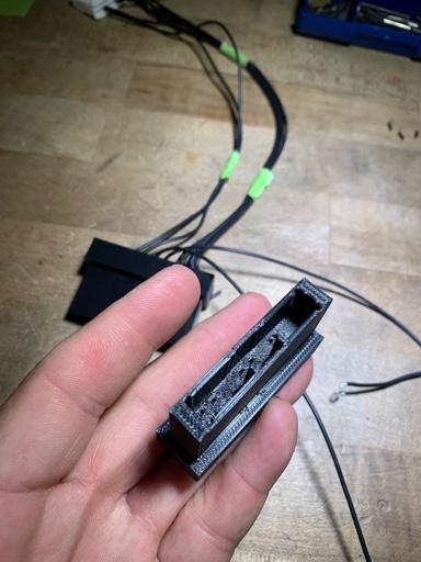

I’m still on it guys. Sorry it was the matting connector that I ran into. Absolutely no one makes it.
Anyway I have had some made and have gone thru a couple version. I think I’m finally locking it down the latest version. I’ll report back in 2-3 weeks. Or look me up on the frame under @dr_kdss ( no dr doesn’t mean doctor. It’s my initials [emoji1787]).
The back cap is so that the pins can be locked down. It’s pretty cool design.
