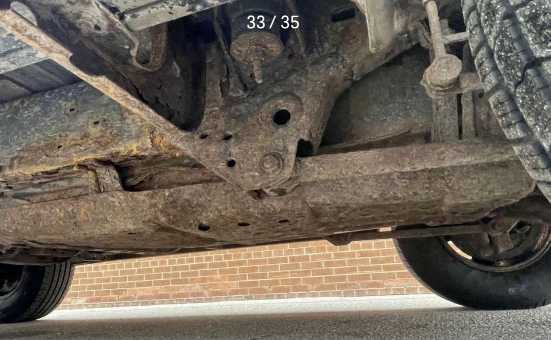

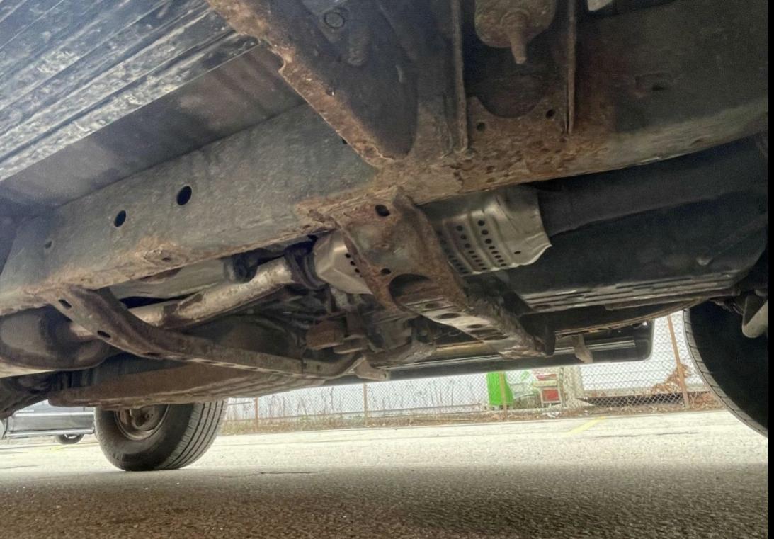

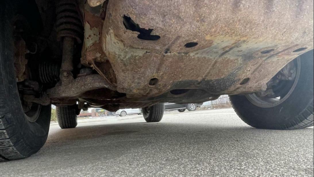

Guys, what do you think of this one? 200k (kms, not miles) new timing belt.
I haven’t seen or driven this one yet. It’s a hike for me (they all are really) so I’m hoping to get your thoughts before hand.
Timing belt was changed 2-3 years ago is all I know from a maintenance standpoint. (It’s at corner lot used car dealer - yes, wary)
This frame doesn’t look the greatest. Do you guys think this could be OK with some minor repairs and annual oiling from here on in? Or do you think I’m going to find bigger holes under the scale?

Not bad for the rot belt. Check the frame around the the rear lower control arms. The arches and inside sections in the middle as well. :)
Sent from my SM-J337V using Tapatalk
First glance I would expect to see holes developing on the control arm mount with that amount of scale on the visible portions. If possible ask for pictures of the mounts and rear axle housing before traveling to see it. Will require some serious tidying up even if those are solid but certainly viable with some cleanup. All depends on the price as 200k km isn't bad even if it needs some grinding or patches but don't pay top $$ with that much rust.
It doesn't look good IMO, nice low milage though!, price makes a big difference, it is hard to tell because of the chosen pictures, but is that a hole on the driver front lower frame rail, if so you will have a hard time putting it on the road as is, and that rear driver frame rail doesn't look like it has much life left in it either.
There are all kinds of things you can do to preserve it if you can get it on the road, but you will be fighting that rust and it will be a losing battle until all rust and bad sections are removed replaced and painted, or the frame is replaced. It took me 2 years to find a rust free 3rd gen, and that was 8 years ago, so I can imagine they are even harder to find now, especially a Canadian Car.
Thanks guys, it doesn’t look too healthy. The rear LCA mount looks really rough.
If I go, I’m going to take a screw driver and poke around.

About $3100 USD, which would be very fair if the frame wasn't so far decayed. I think they are aware of the issue. This is a dealer so I would expect them to ask way more if the frame was in better condition. Judging by the fresh Michelins, this may have been well maintained despite the rust.
There is potential at the right price.
Thanks guys, I’m going to check it out and see if they will let me take it to a mechanic for a full assessment.
I know they sell rebuild sections for these frames, or I can make my own. But if its bad in more than a few easy to reach areas (laughable comment, I know), I will pass. I like the low-ish kms but I’m not in for a full, body off resto/frame swap

No pics of the rear section behind the tires, that is usually worse than than everything else, from the pics it's obviously a 96-98, sometimes the km don't matter if it just sat around and rusted. Any pics showing the door jambs and rockers? A lot of people just top wash their vehicles without ever getting the frame treated or at least spray it off. Always see a few for sale here in Ontario where someone recently bought one for cheap that looked good on top but when they went to get it certified and put it on the road it had frame problems that weren't worth the money to them to fix, then they try and re-sell it for an inflated price because they basically overpaid for a parts truck. Basically with all of these trucks up here or probably everywhere at this age if you can't do the maintenance or repairs yourself it's not worth buying, luckily most people who own these and are on this forum are mechanically inclined and almost all problems/repairs at this point have been documented
