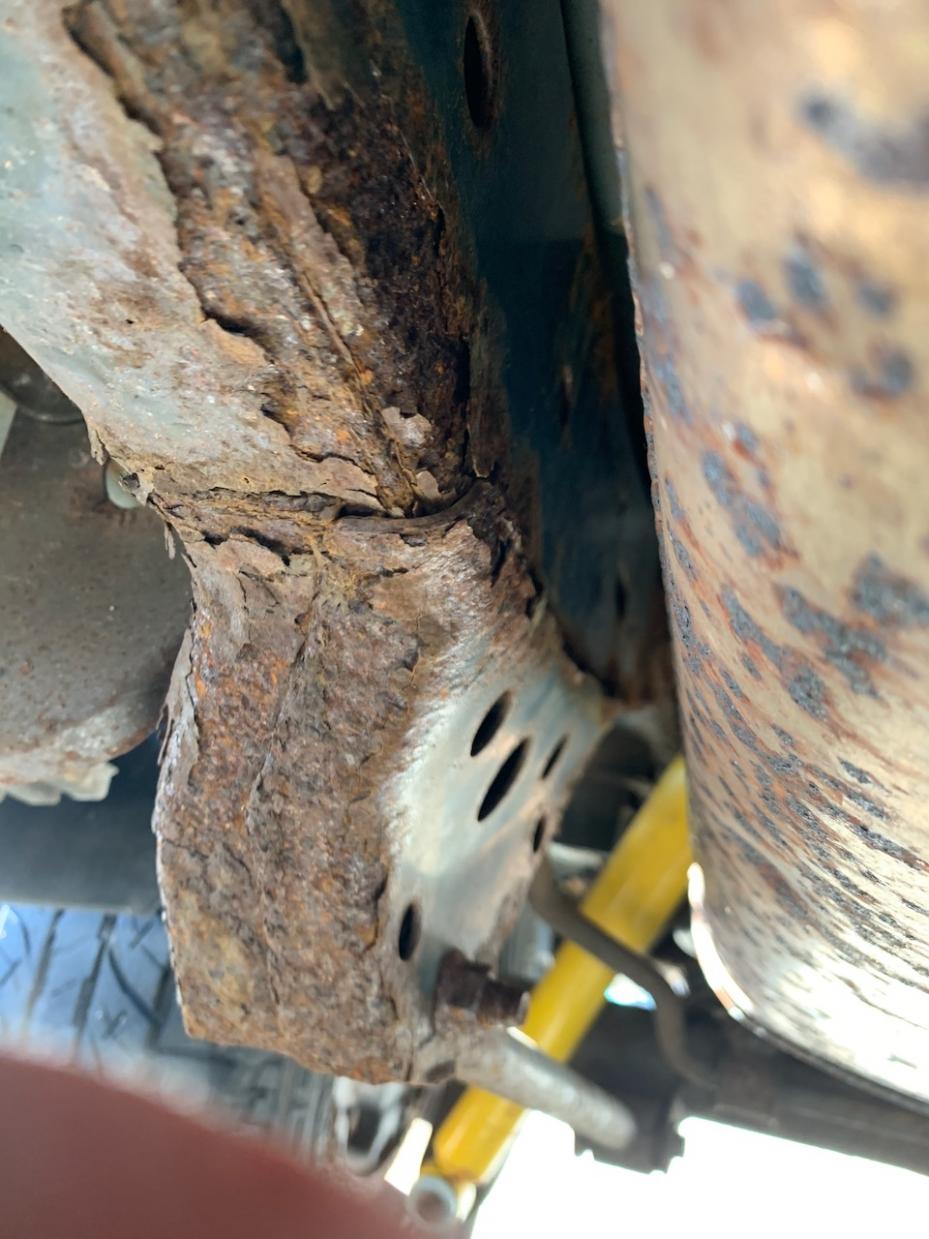

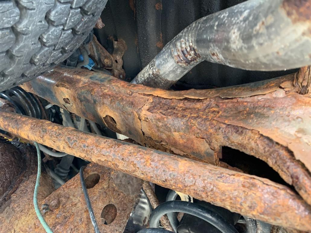

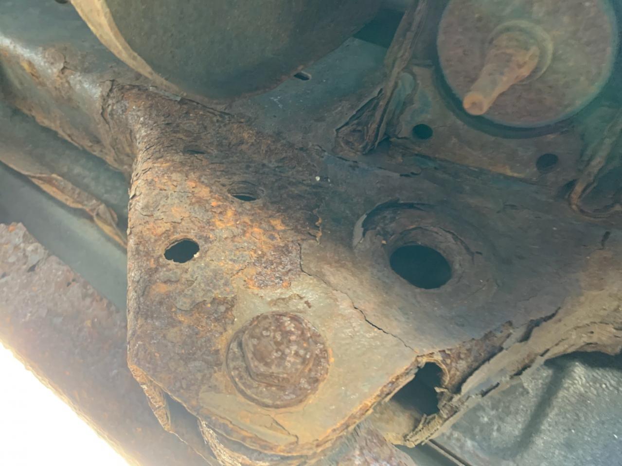

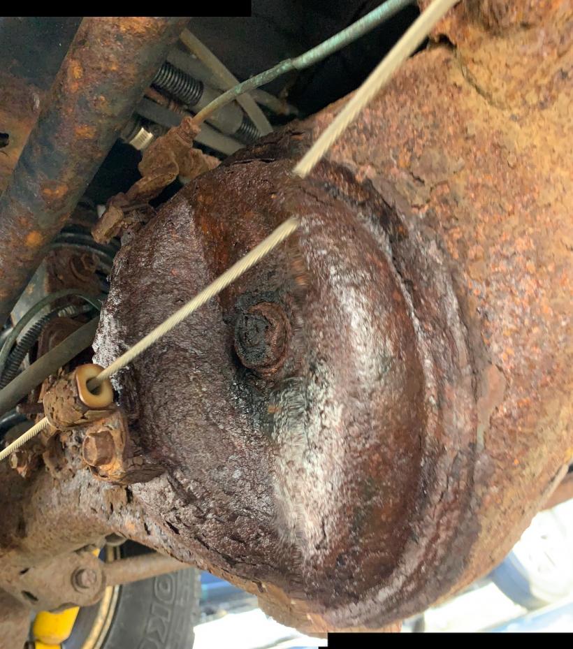

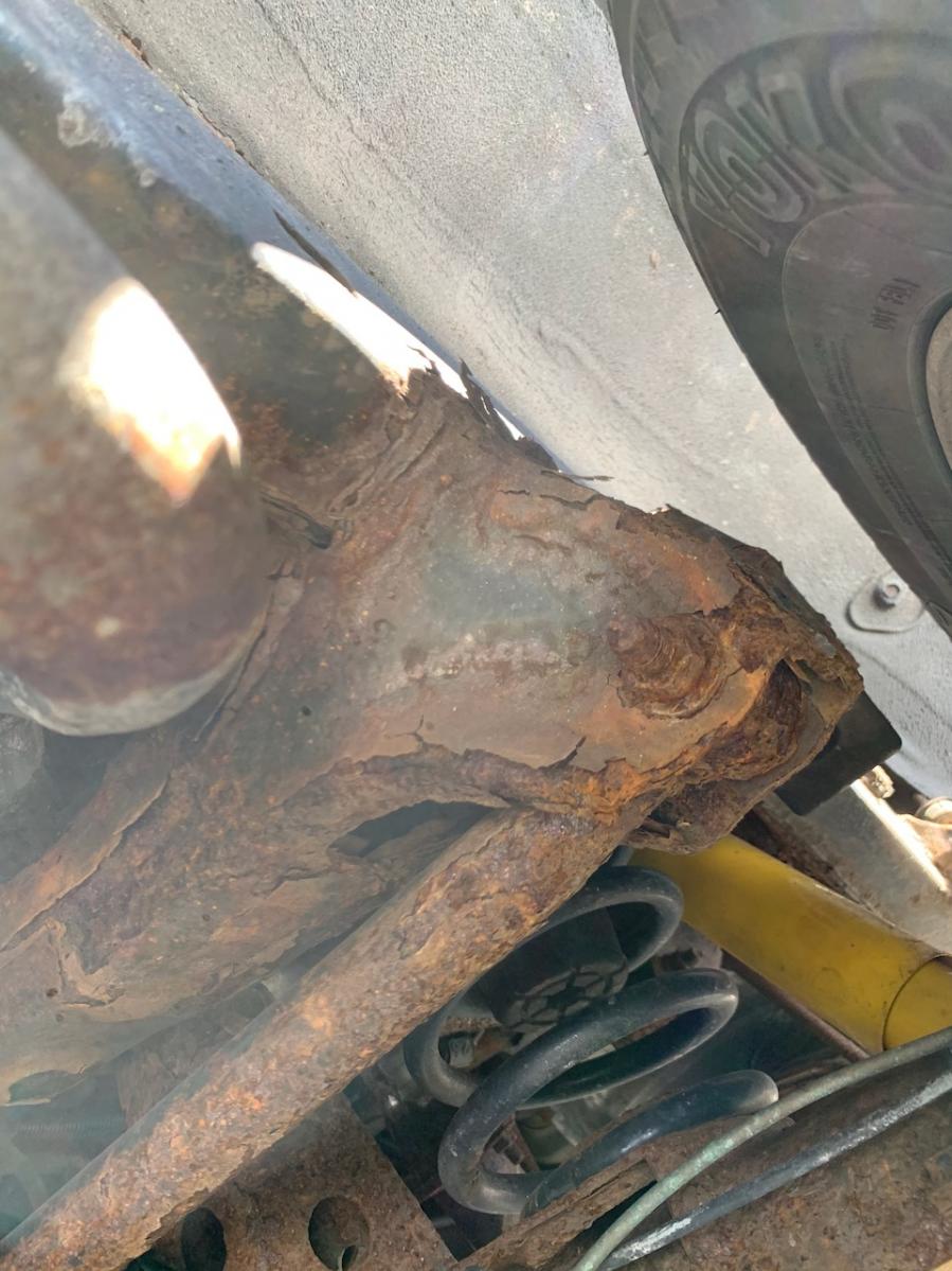

I looked at this one the other day. 02 with 155K, other than this rust pretty nice. Wanted 4K, said the rust was superficial. I passed, right call?

^ That looks far more than superficial IMO. Good pass. Way too much flaking on there, everywhere. It doesn't look likely to break tomorrow but it is weakened everywhere. Diff appears to be leaking, probably due to it rusting through.
You can fix/repair rust spots but the rust never stops- it keeps on going.
