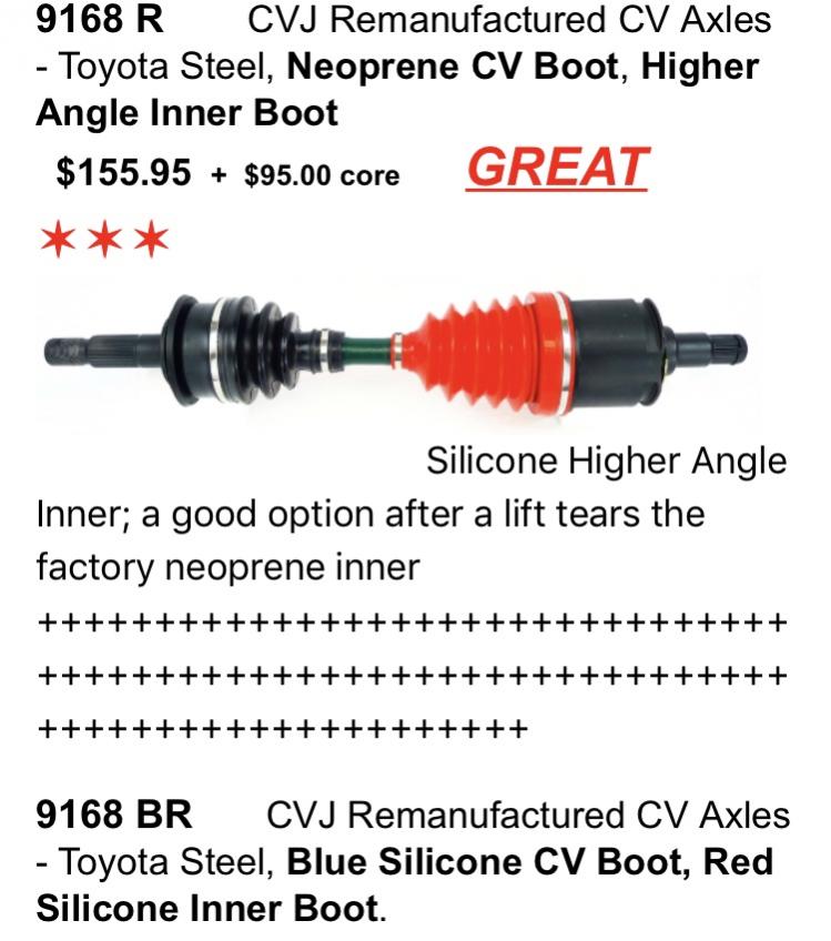

So my CV boots busted right after my lift, which I’m sure they needed replacing anyways so I did some reading and searching and found this place due to somebody else’s post but I wanted to get some opinions or other options on this set up. These are supposed to be for lifted vehicles...

The CVJ axles are the best you can buy. They're a local shop here in Denver and only rebuilds OEM toyota axles. If they get an aftermarket axle, they will consider it as a core but will throw it in the trash.
Really great people, awesome company, highly recommended.
Reboot your CV axles and do the boot stretch mod. It's hard to beat OEM axles for their durability and longevity.
I installed a set in May. No issues so far. I'm Denver so was easy enough to drive over and pick the up.
