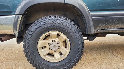

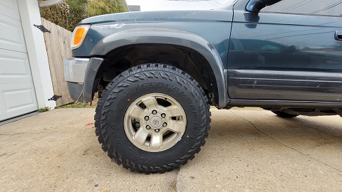

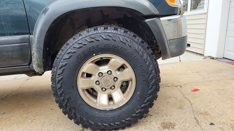

So the tires are mounted and they actually fit pretty well for a 33.5 inch tire on basically almost stock suspension. I had to trim a bit of the front fender flare where it comes over the chrome bumper and I had to trim the back of the front wheel wells as well. Nothing really major. I will have to beat back the pinch weld a good inch or so and then it should be mostly fine for wheeling
What's a good pressure to run these at for the street? I have them at 35 currently
Also note my front wheels are slightly tuned in the pics which is why it doesn't look centered
