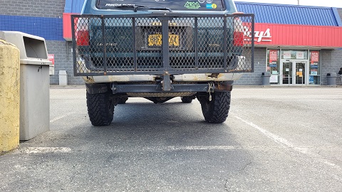

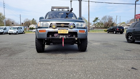

Would you take a pic head on from the front or rear? Curious about the stance. They look great though — I’m so excited to get this size next time.

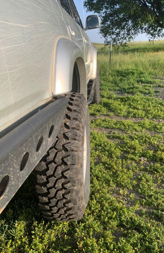

Sure thing. Keep in mind im running 1.25" spacers up front so I can fit the Tundra brakes

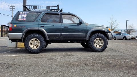

Here ya go! I will say they do look much smaller on the vehicle than I thought they were going to. I barely have any lift and they almost look stock size just glancing at it

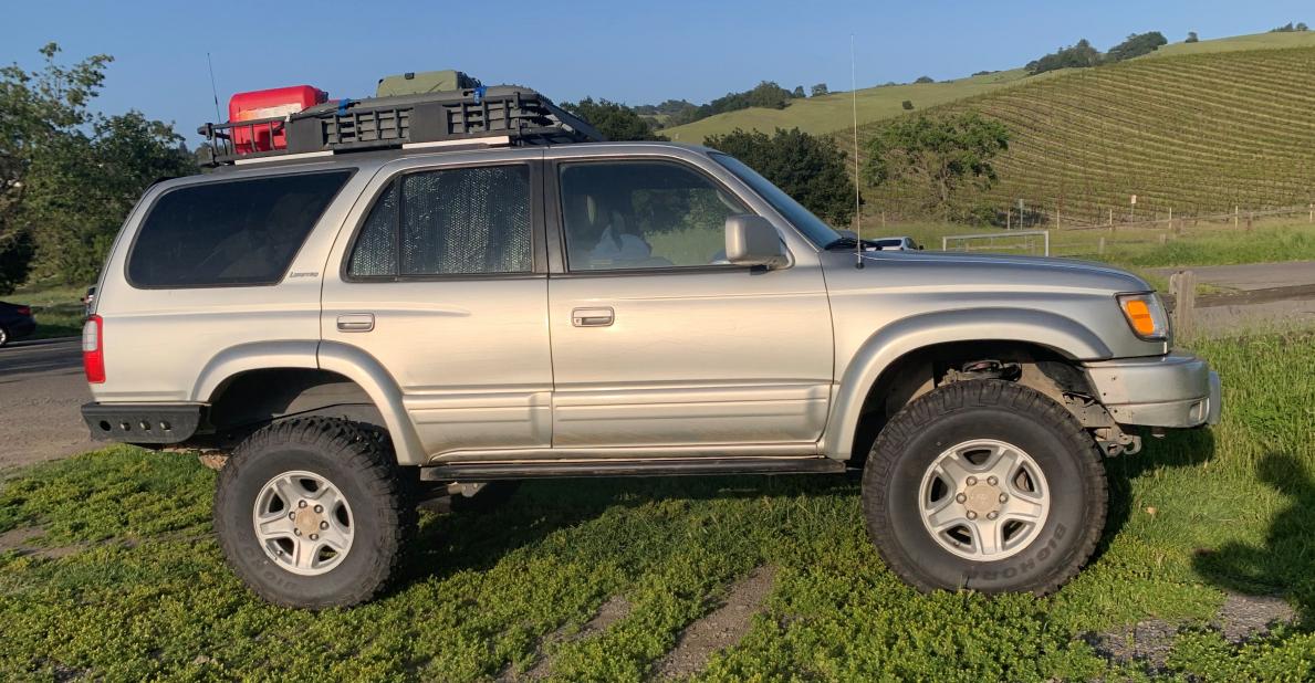

Maxis Bighorn MT 255/85-16, OEM 3rd gen alloy wheels. If you really, really wanted to optimize the tires to match the Limited flares, then use 1.25" spacers in front, and 1" spacers in the rear. I have 1.25" spacers all around.

Dang, those do look kinda small, I thought they looked bigger on the previous pics I’ve seen.
Maybe it’s just time for 35s.

The more I look from a distance the more stock size they look. I had a Subaru with 30s on it and you could tell those were nowhere near stock. I dont wanna say im disappointed but I am kinda let down. Im just glad I didn't go with 285/75 cause those are smaller than these

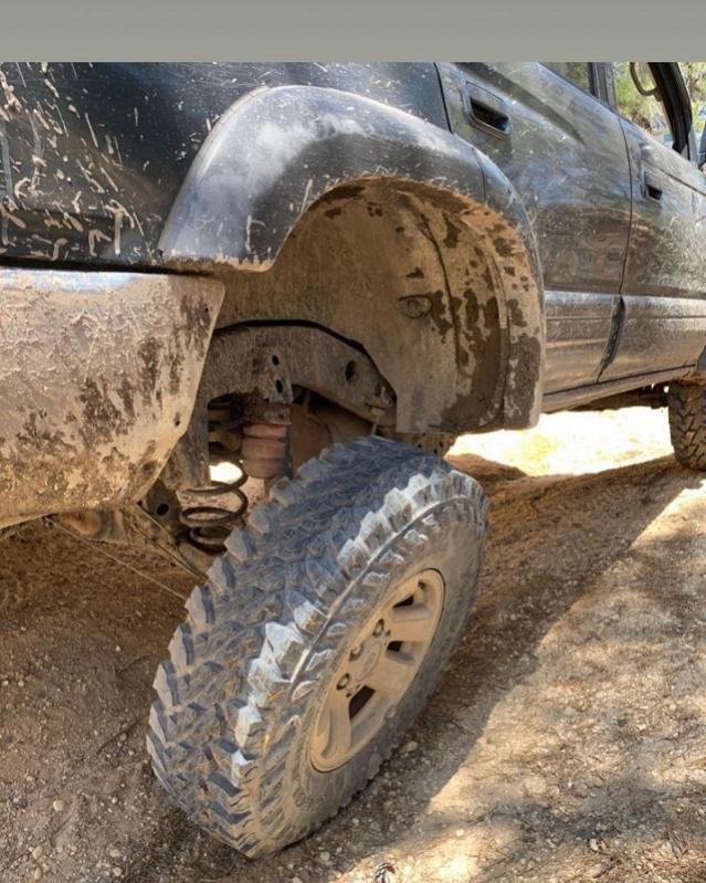

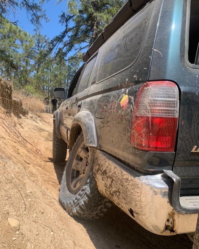

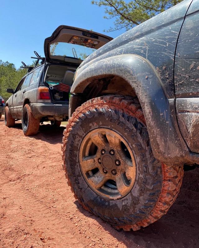

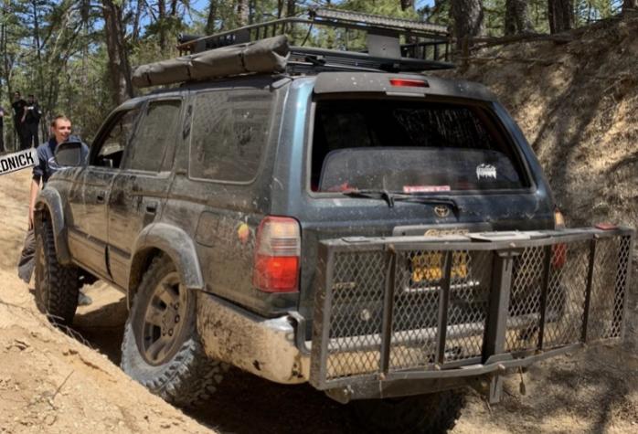

So I flexed the shit out of the truck this weekend to the point that I was teetering and the tires fit extremely well after some cutting and sledge action. I will have to take 2 inches off my rear bumper but thats only cause it hangs lower since it was hit there previously. Overall this size is perfect for me. I tired posting the head on photo of where its hitting but for some reason it will not let me
