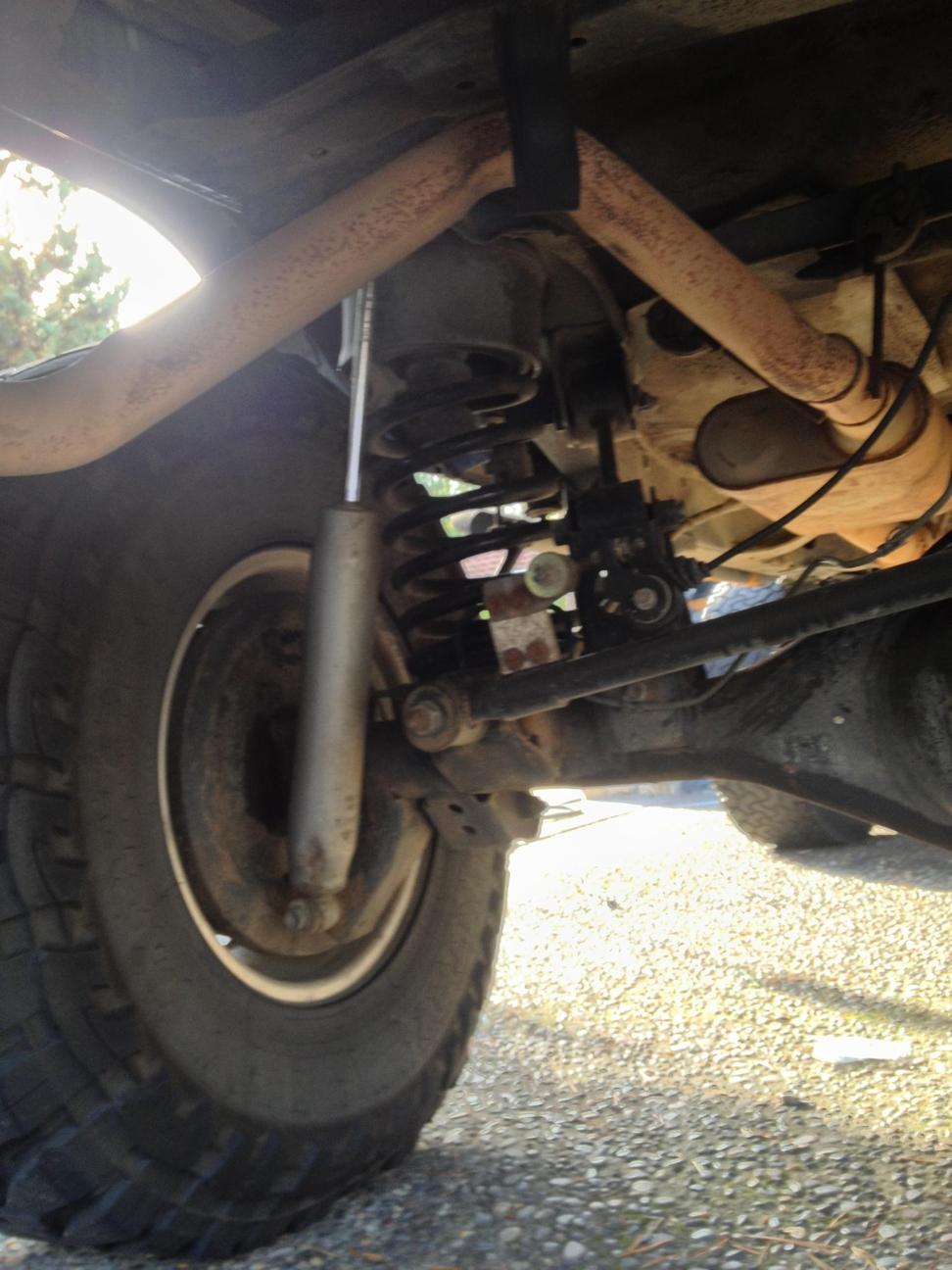

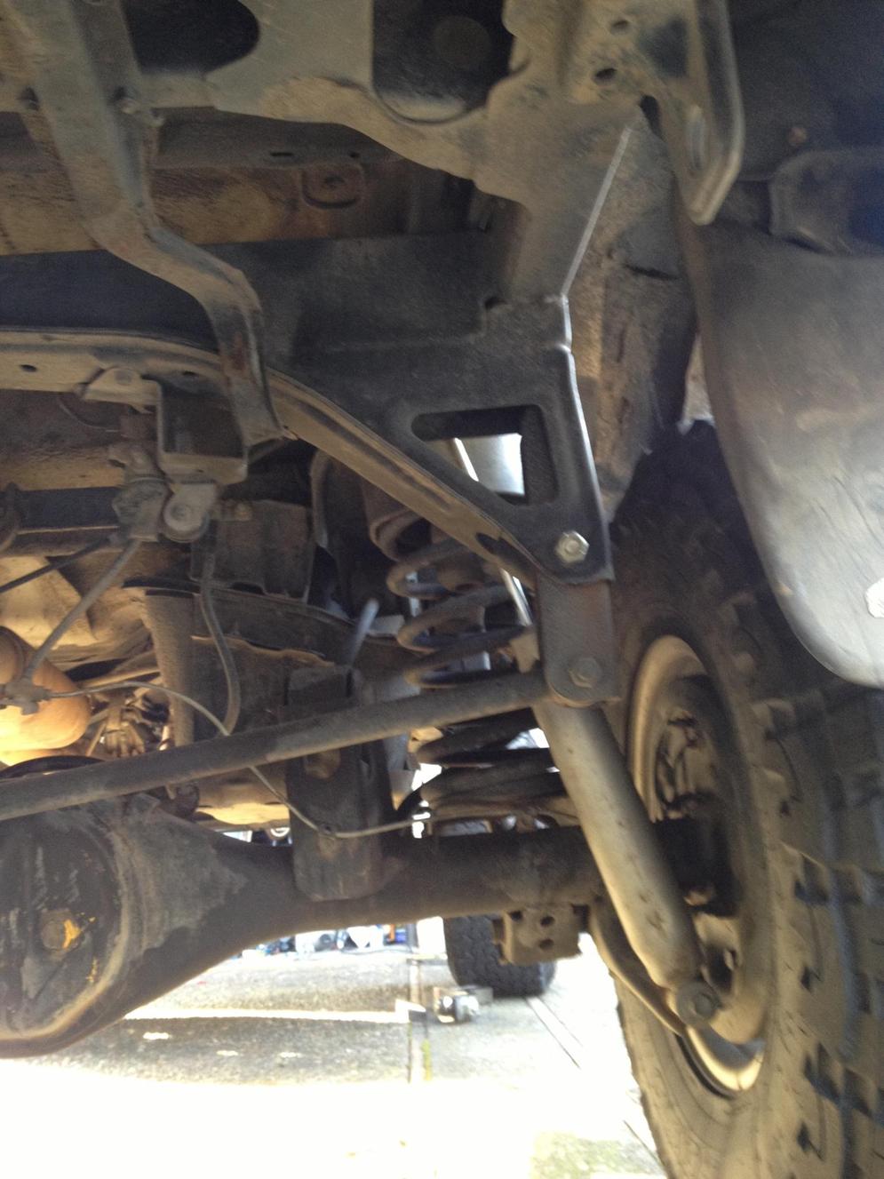

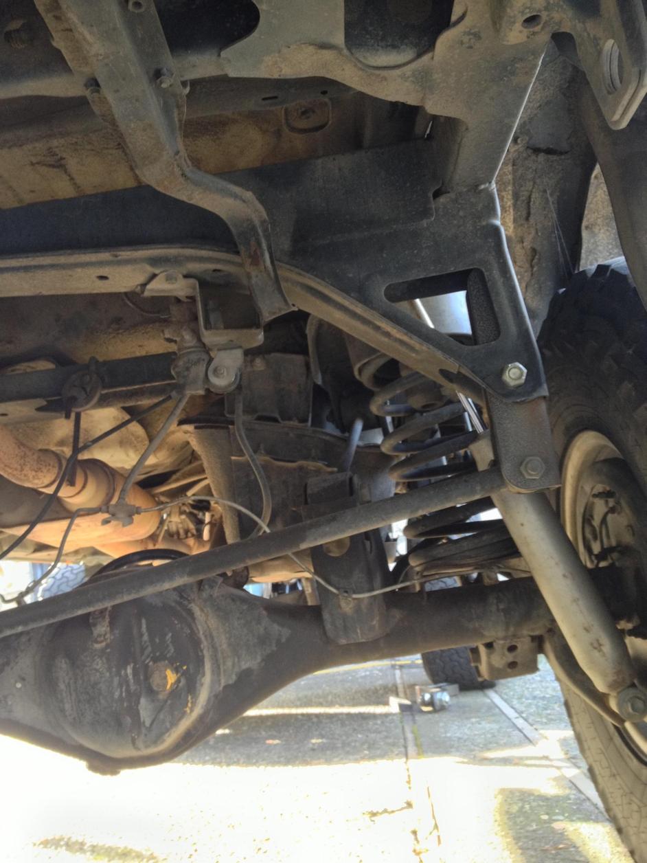

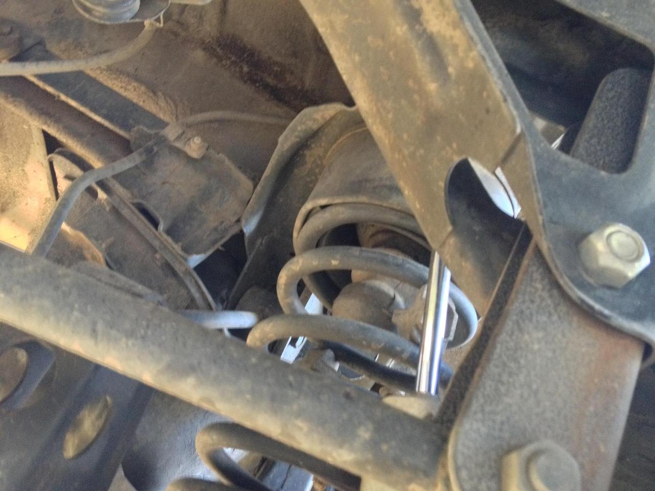

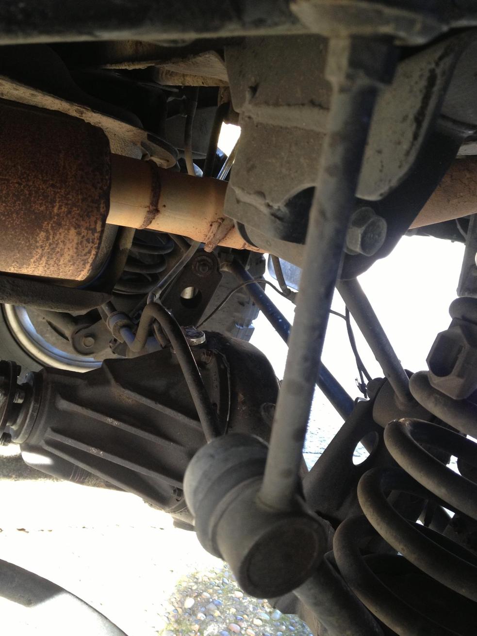

Here are the rear suspension pics.

Its not a bad rig, but the rear suspension is ****ed. The trailing arms are almost maxed out just sitting there. It would need a chevy 63 leaf conversion to make it right.
Go talk to Toyota man off of columbia off of 205. He may have some leads on some rigs for sale too.
anyone else notice the coil spring separators in the coils? That rear suspension is ****ed the **** up!

WTF is up with that brake line? I would be afraid to drive that thing with the fear of the brake lines on the rear axle ripping off! Too much shady information and work on this thing. I would back off like you suggested.
I still think it's a sweet 4runner. Rear leaf spring conversion & new brake lines and you will have an awesome DD & a mean trail rig. Inspect it with a fine tooth comb and talk him down on the price. SAS/gears/locker already done...
