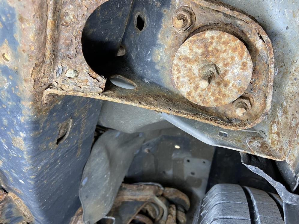

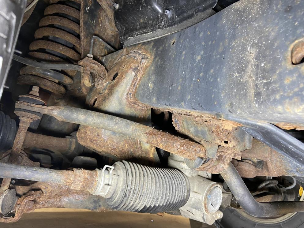

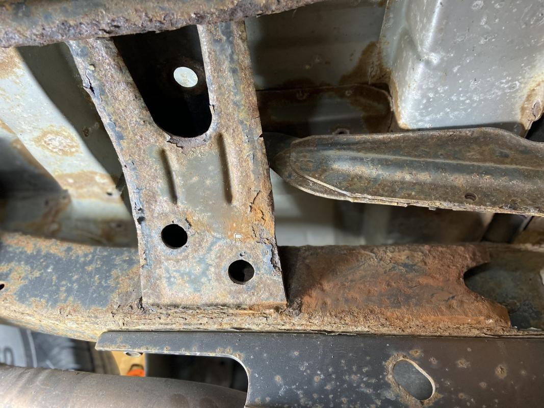

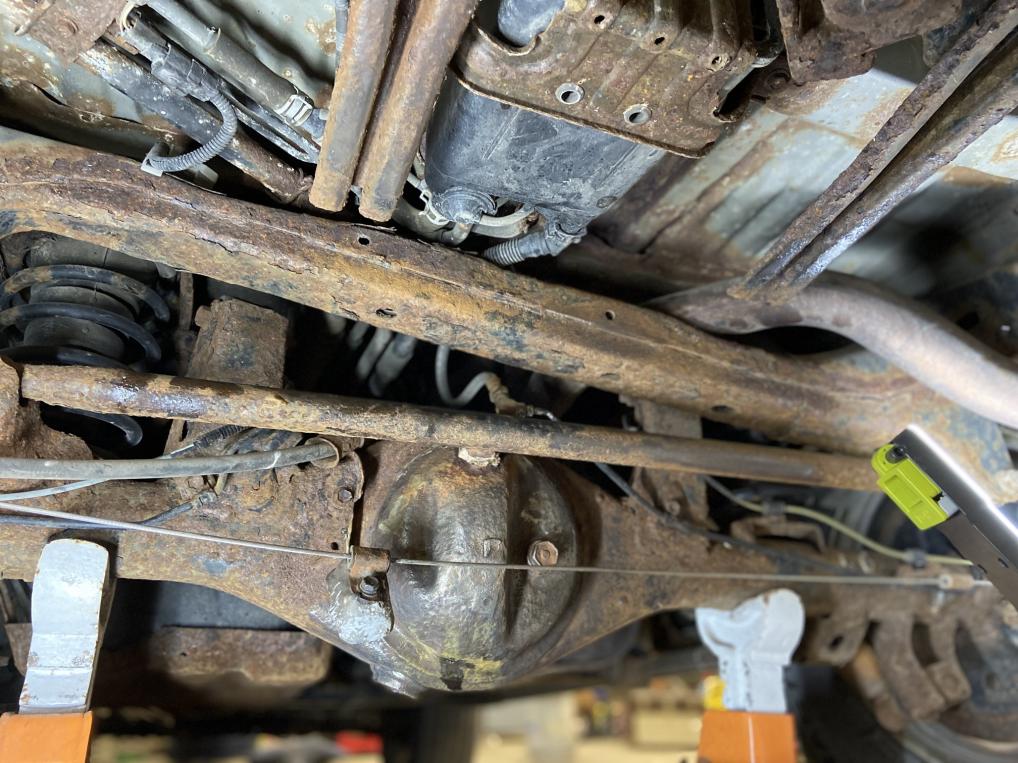

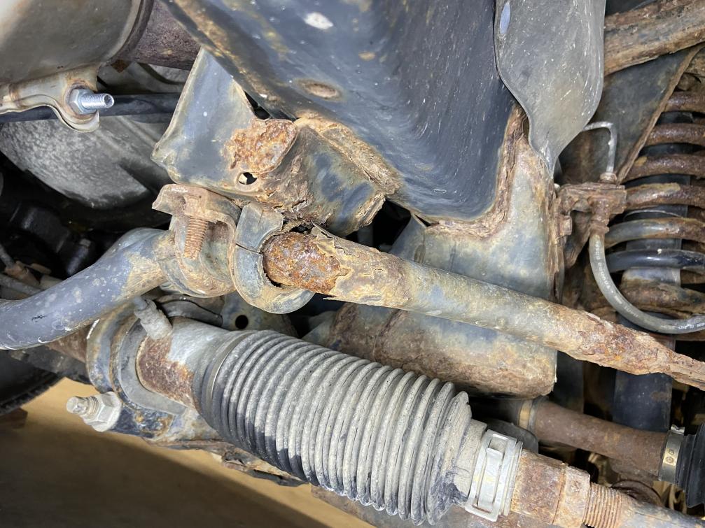

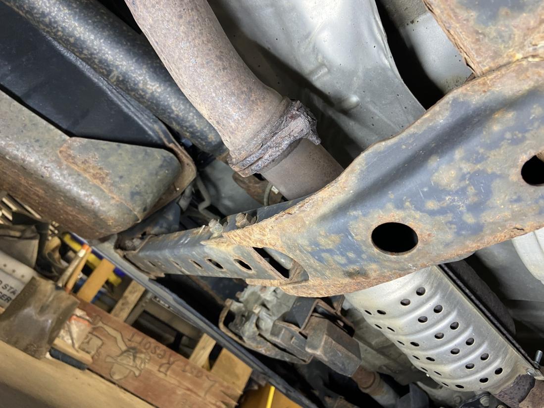

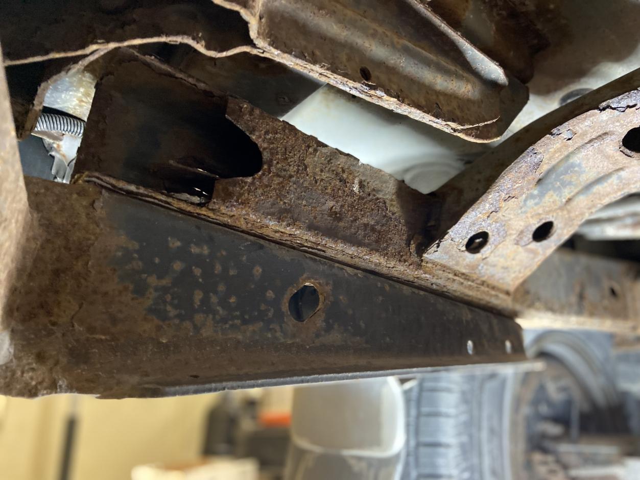

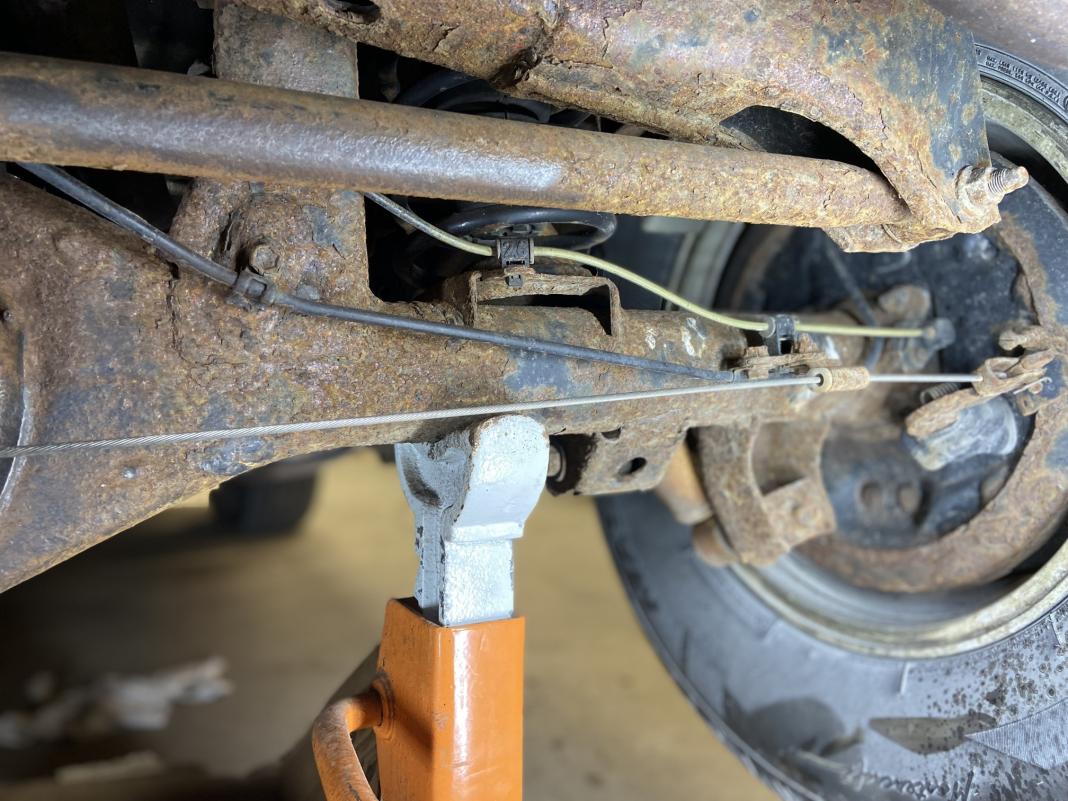

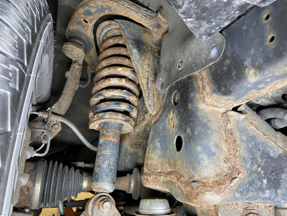

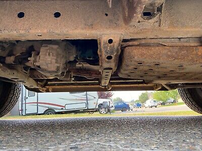

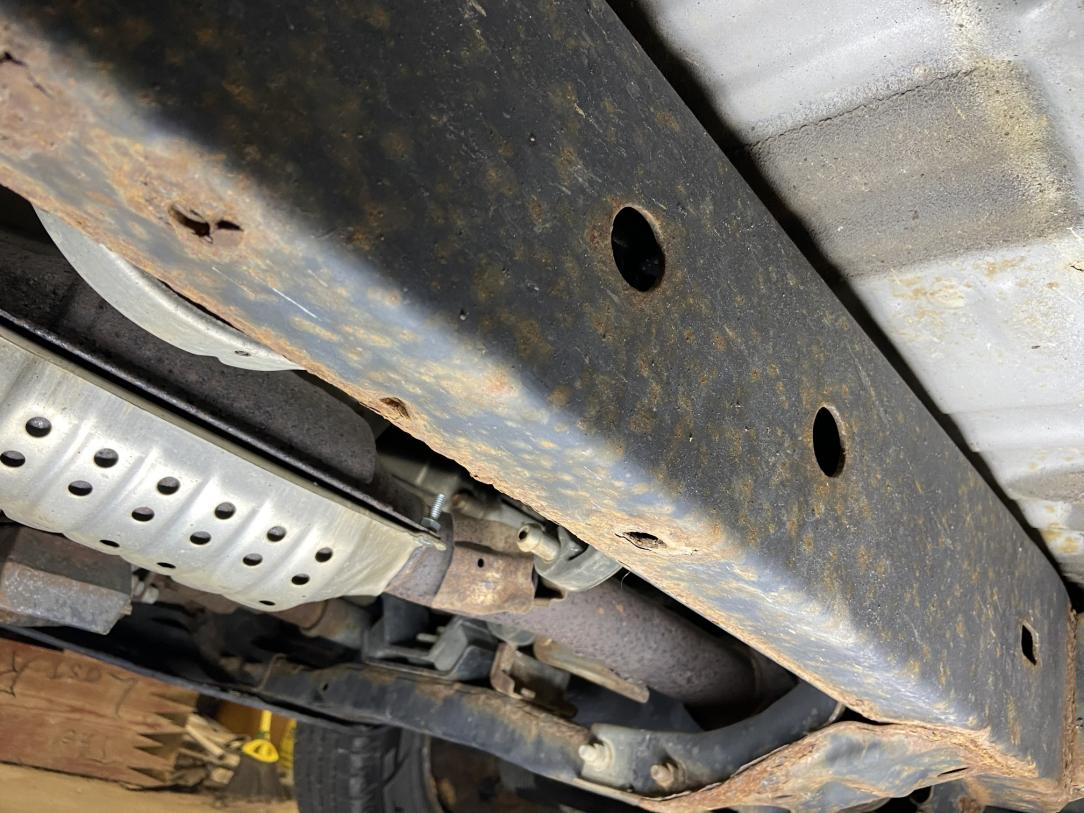

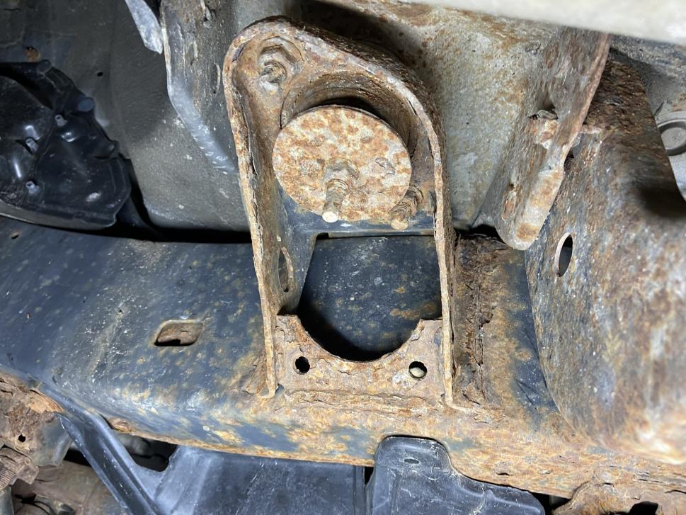

Hi,
I’ve been looking really hard for a 3rd gen 4Runner. There don’t seem to be very many options out there right now even if I’m willing to spend a little bit more (up to $10,000 CAD). All of the decent shaped high mileage ones (200,000+ miles) are too expensive for what they are ($8000-$9000 CAD) while the lower mileage ones (155k-180k miles) seem to all have bad rust issues on the frame. Today I found this one that is low mileage (234k kms or 145k miles) but I’m uncertain about the rust. Specifically on the cross member. Any thoughts? For a little more context, this vehicle would be a 3-4 hour drive away.
Thanks,
Eric

I wouldn't pay over 5000 CAD even for that mileage because it will take a few thousand to right the frame. The first two images seem like wide spread surface rust, the last image seems to have more serious rust on the crossmember.
The frame doesn't have laminations separating or crumbling, it might be salvageable but it wont be cheap. I would pass that vehicle, look further away to get one with less rust, and then do everything in my power too keep it rust free (no point in getting a rust free 4runner if you are going to let it rot away while you own it)
The only way to know is to go look at it. You need to actually crawl under it and see if it is just cosmetically rusted or rusted through, particularly around the rear lower control arm mounts and around where all crossmembers are welded to the frame. Surface rust is okay, a hole or two is fixable. A frame that has holes and thin spots from end to end is not repairable.
Thanks for your input. Ya I want to have my future 4runner for many many years to come so I do plan on protecting that frame with my life when I eventually find my baby.
I get that it takes more than a few pictures to determine how severe the rust is. I was more wondering if it was even worth making the drive to go see it considering the way that the crossmember looks. Looks like I’ll probably move on to the next one.
Take the dive and go further south. Idk where you are but it seems to have seen some salt

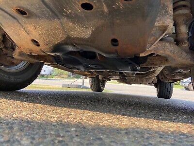

pass on that for sure, the oil dripping on the skid plate from oil changes done without removing the lower plate is a sure sign the original bushings on the steering rack are gone as well. Also check for rust in the circular cross section joining the chassis in the rear, the opening is visible from the rear wheel well on both sides most Canadian 4runners have that section collecting salt and rocks that corrodes in the middle. hard to see but this one would have that corrosion as well.
Not an expert on British Columbia, although I did once drive up and down nearly the full length of it to get to Alaska. I do believe that some of the nicest used vehicles in America are found in Eastern Washington and Oregon.
Go look at it. That looks like it could be fluid film with dirt stuck to it. Doing an oil change without removing the skid won't kill your rack bushings. A leaking rear main seal is what you are confusing that with.

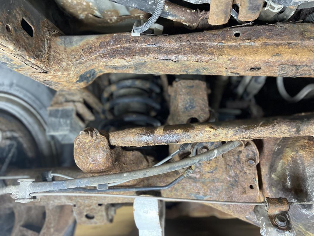

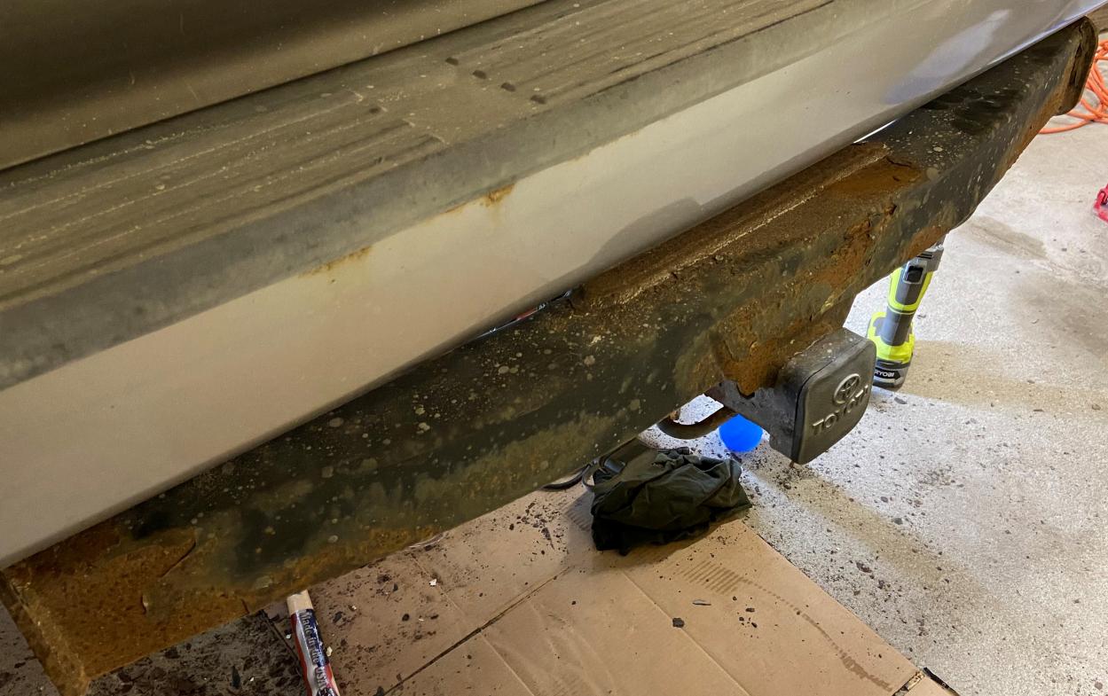

Rusty Opinion

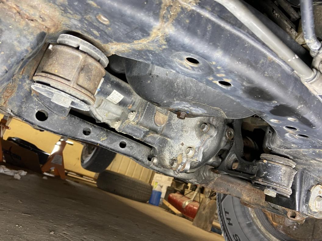

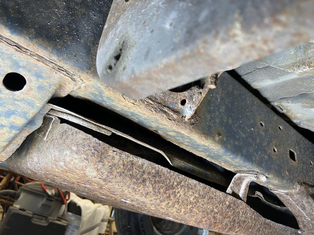

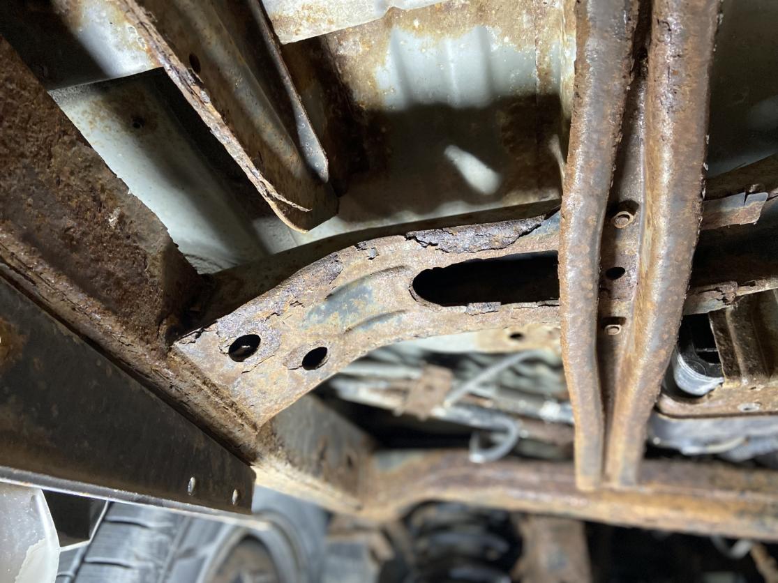

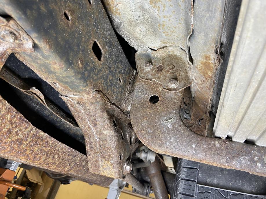

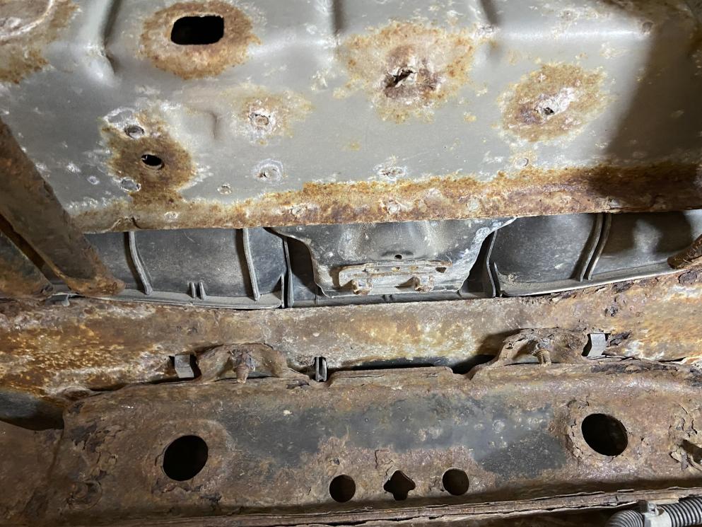

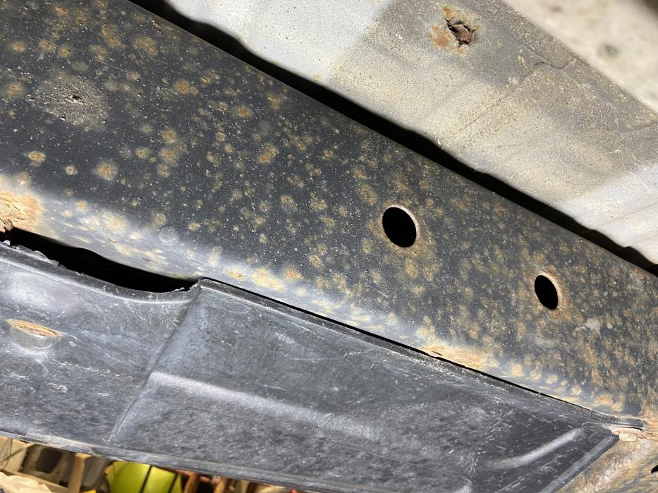

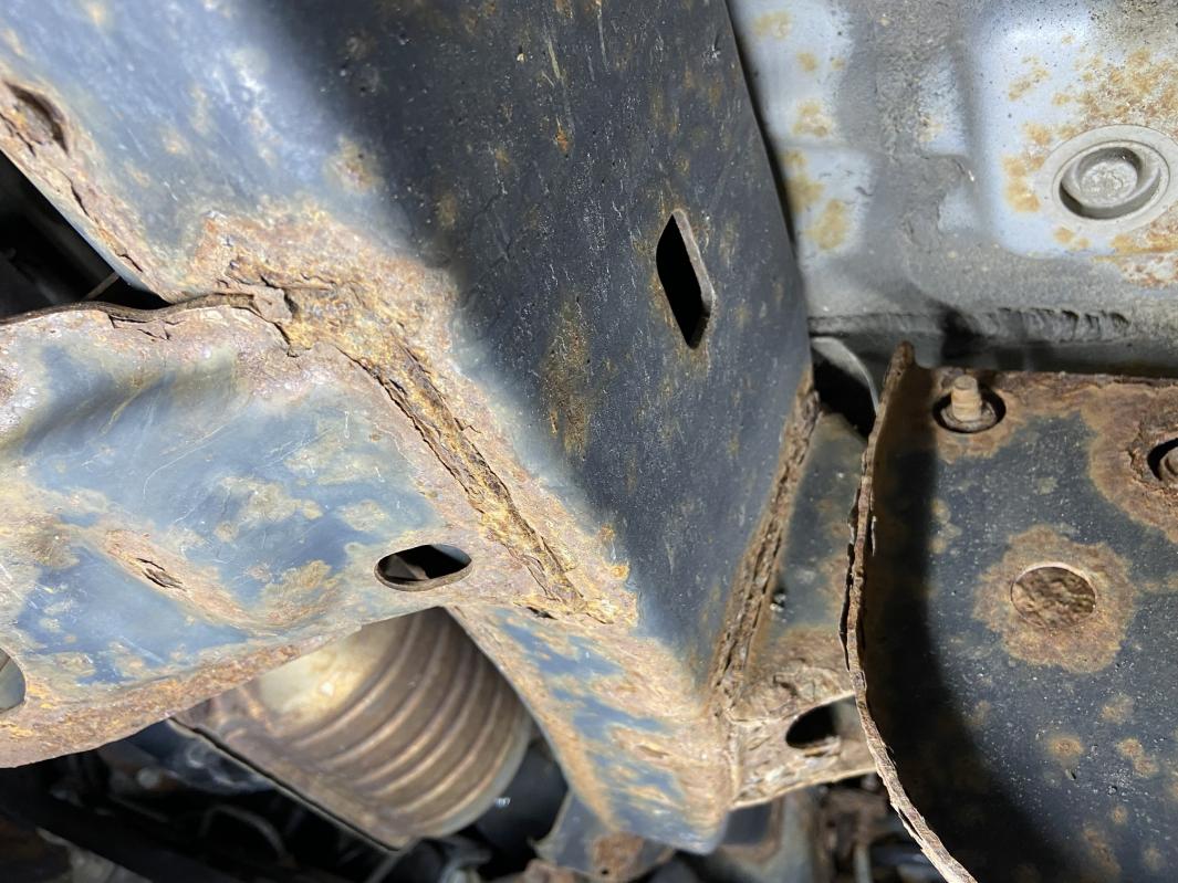

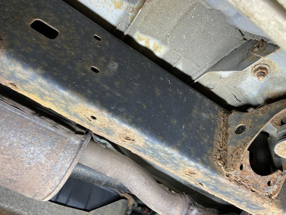

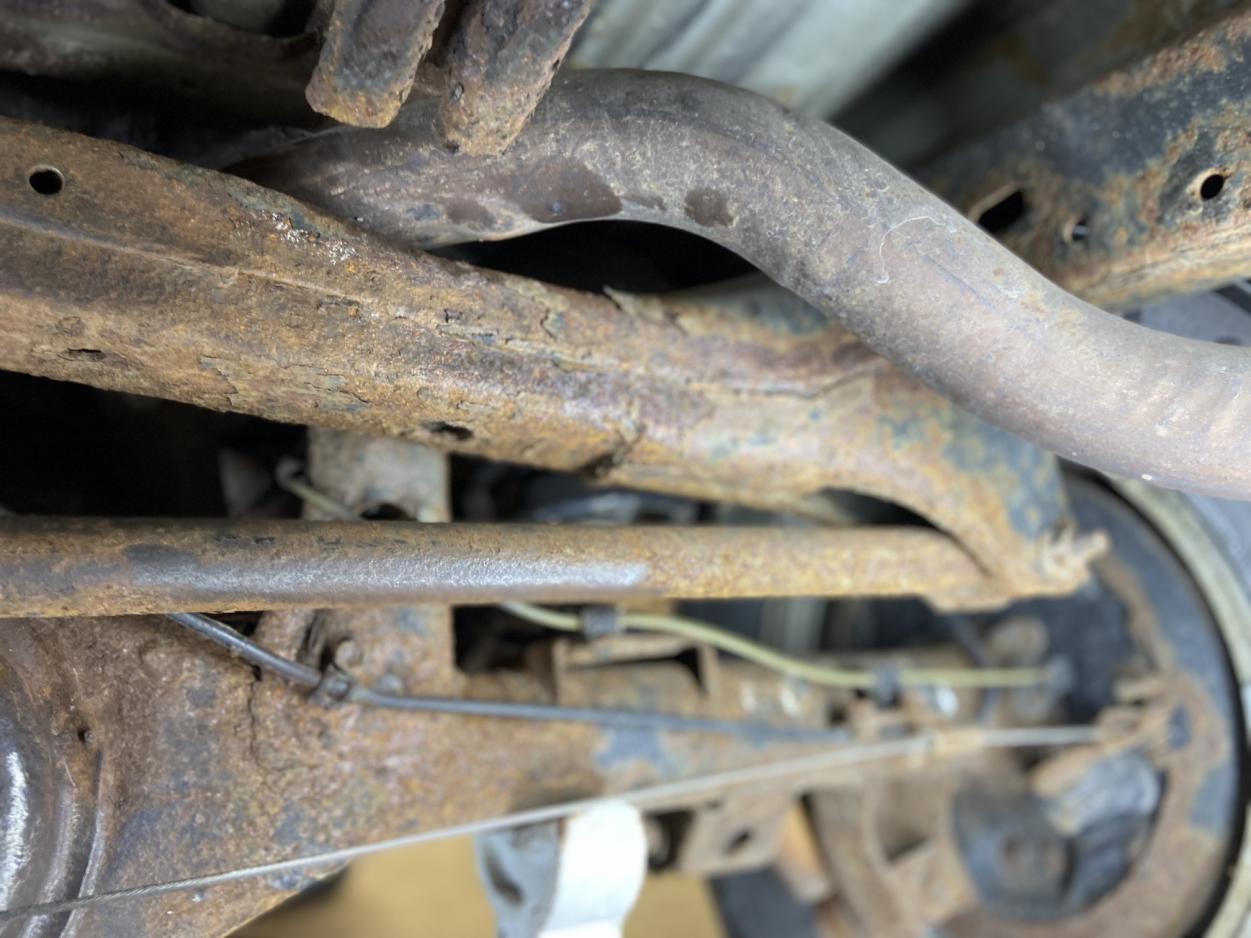

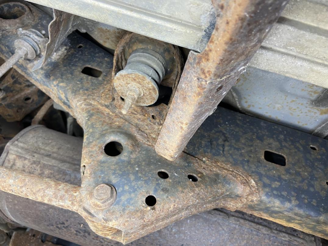

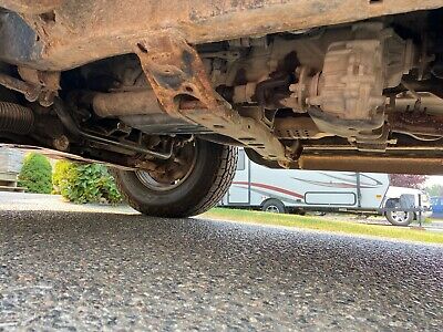

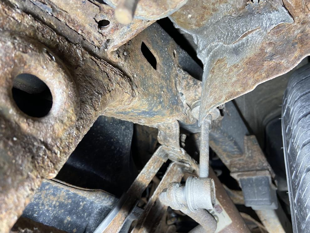

I was curious if I could get some of your guys opinion on my rust as well. I have beaten on it and it seems pretty solid to me, the only real worry I have is the area behind the rear end where the spare tire hangs and what not. It looks to be a lot worse than everywhere else. My question is what do you think I should do, the 4Runner just got to 161,000 miles and everything else works perfectly (except for the previous owner putting a screwdriver size hole in the rear diff cover). Should I get a grinder and remove as much of the scaling/rust as I can and get like a rust kit from POR 15 and some Eastwood inner frame encapsulaor, take it to a body shop and get it sand blasted and coated professionally or just sell it. I do plan on moving to Michigan from Kansas at the end of August of 2021 to finish up my masters and I plan on hopefully towing a Uhaul trailer if possible. I will try to provide some photos of what i'm talking about

To me it looks solid enough, that if you rust-treat it with a grease-base anti-rust right after buying, you could go long with that truck without worrying. Seems like mostly surface rust that had the time to work deeper. But it is not rotten.
Exception being that I would have a solid look a the part that attaches the frame to the rear trailing arm (the kind of triangle). Seems like the worse area in your picture, it's a weak area that rusts easily, really have a look if it is still solid enough. If it is, rust treat that thing in and out with grease/oil based every year. Also have a look at the underside of the rockers extremities, seems like you could get through with a screwdriver.
Agree with above. Its probably fine but it needs attention, even if just a thorough coating of oil based rust inhibitor everywhere, applied yearly. Also you'll need to deal with the diff cover.
Thanks for the replies. The diff cover didn't have any pinholes, it actually had a a crack in it from a rock hitting it or something. I couldn't afford to get a new cover so I tried to remove all the rust and scrape the whole thing down to bare metal then applied 3 layers or so of JB-Weld and topped it off with some rust reformer. Didn't see any metal chipping when I drained the fluid and isn't leaking so I think I'm good on that
