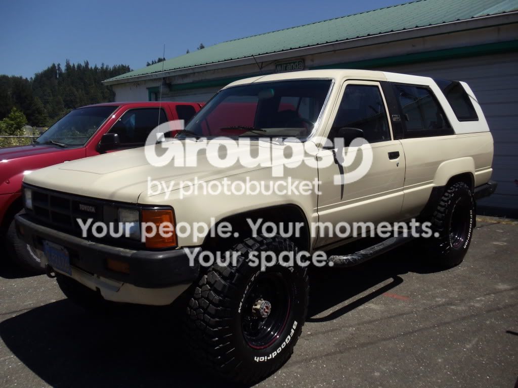

i have an 85 with a 22re. i had to cut tons of rust out, weld in new steel and bando. then i re rattle canned the new spots. its just a start. id like to make it a rock crawler in the near future. i drive it around on the road some but have 1 problem. it dosnt happen all the time. mabey 3 times a week. when im at low rps (taking off from a stop) some times it bogs down and dosnt want to go. i usally floor it and when the the rpms come up a little it goes like hell. it only dose it during take off. idles and runs great. i have replaced the fuel filter, plugs, wires, cap, rotor, and has a new timing chain. i have also ran a couple bottles of fuel injector cleaner through it. any ideas or sugjestions would be appriceated.
