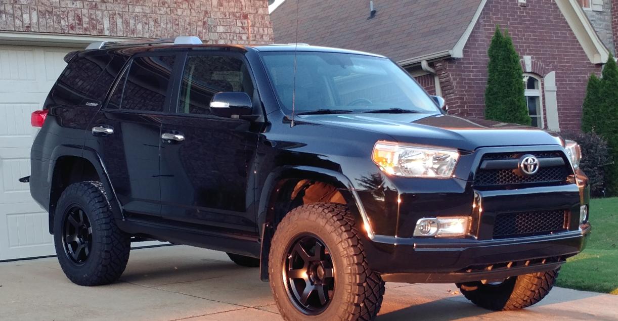

Here is my 13 limited
Icon stg 1 with 275/70/18 ridge grapplers on level 8 Mk6 18x9 0 offsett
Had to do the fender liner mod and remove the small inner piece of the front mud flaps for rubbing. i lost 2 mpg HWY going to the 18s from 275/55/20 cooper zeons. It is about the same mpg around town. Gained about 20lbs per wheel. The ride quality is better with the 18s and icon suspension over the xreas and 20s. There is noticeably more brake pedal input required with the bigger tires. if you have the 3rd row seat and dont have a use for it there is all kinds of stuff you can do with the space back there like a stealth sub or storage box.
