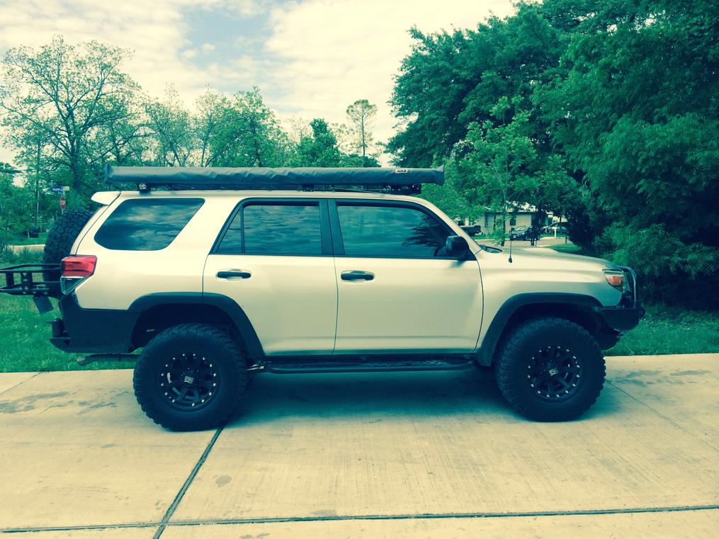

Hey, that's my picture with the 6". Honestly, I rarely use the reverse lights, especially the 2 x 6". In a few weeks, I plan on taking those off and moving them to the front next to my 20" like I originally intended. If you really need light back there, I would suggest just running a single D series light such as the Dually or D2. The 2 6" lights end up drowning out the backup camera and I can't see anything.

I am running Rigid Dually's on each side, mounted in the 'O' on the GOBI cut out, and also use an ARB Awning 2500. The light fits perfectly below the awning and works great for setting up camp, however is still very bright.
