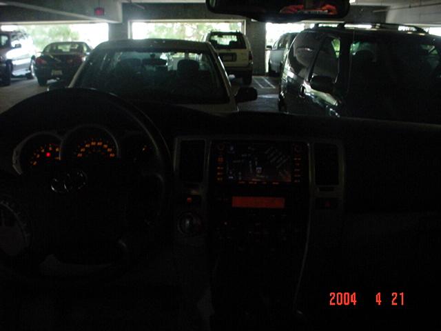

To add to these instruction, I took a thin peice of cardboard and some of that special blue masking tape for painting, and covered the screen to protect it while soldering.
Bling Bling!

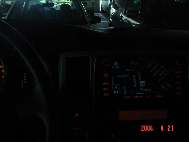

Holy cow! What a job that was. 8 hr job to do the bulbs. Thank you webshot for those great instructions. I now have orange lights! It was worth the $1300 gamble.
I ended up destroying the old green LED's to remove them, but it worked well....All the lights work, and they even dim...I just have to hook up the speed sensor wires and the antenna power and I will be set! Thanks again...

After a few nerve wracking days and sweaty palms, I am happy to report the my Solara Nav system once again installed in my 4R and working perfectly now with matching LEDs, voice amp and console bezel.
Thanks to those who went before me. I learned through the info they shared on this board.
