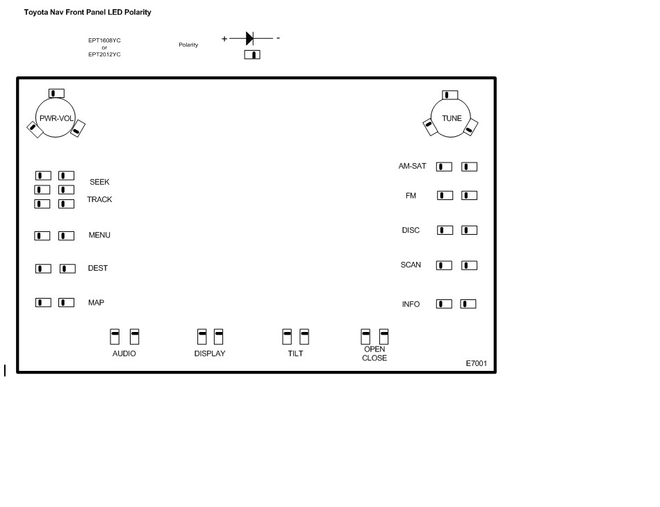

I have attached a chart which shows the polarity of the LEDs on the faceplate. Might be handy for someone.
Regards -TM-
Here is the attachment showing the polarity of the 36 LEDs on the faceplate.

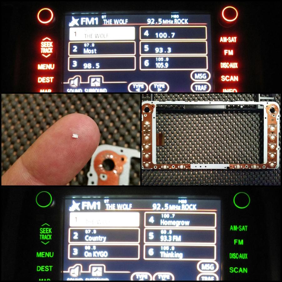

i did another e7009, but this time it was mine! i used these 0803 LEDs. They are 2mm x 1.2 mm.
Here is the before and after, as well as a shot to show how small the LED is.
