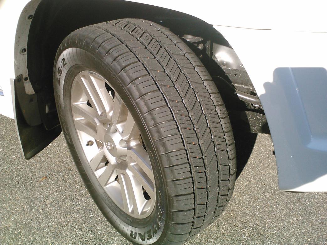

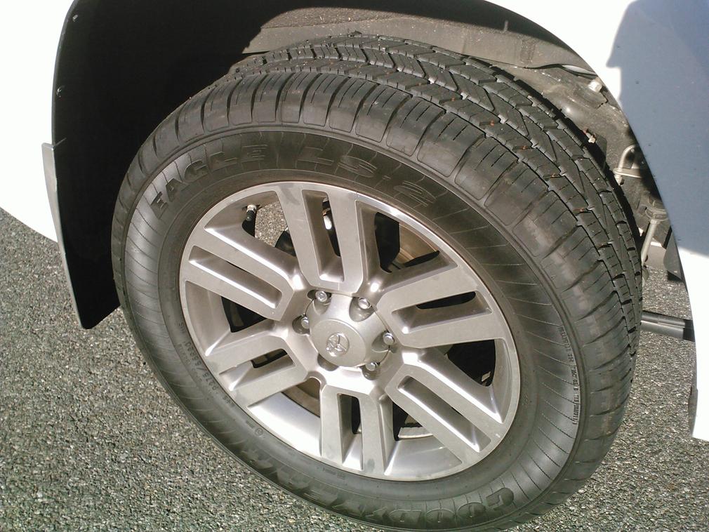

Here's a look at a GoodYear Eagle LS-2, 275/55 R20 on a stock '12 limited; no lift. They've caused no trouble, with the exception of an occasional liner rub if I cut to the extreme L or R, while hitting a "stepped" entrance ramp.
This issue could easily be remedied with a fenderwell liner adjustment, but it rarely happens so I'm not concerned. The wider tires have greatly improved the truck's road manners and stability at higher speeds...no comparison to original equipment.
Important: Each tire manufacture's product size may be different in terms of physical dimensions, so ask around BEFORE you buy.

Thanks Rigtec, they do look way better than the originals. I just posted a link that states that the size of the wheels in a 2013 LT 4runner are 20"x 7.5", do you know if that is correct????
And the GoodYear Eagle 275/55 R20 are compatible with the 7" wheel???
Most tire manufacturers won't recommend doing it (legal stuff), but many of us here have done this with no consequence.
I was apprehensive at first, but I decided to go with it and have had no issues; what ever you're comfortable with, it's totally up to you.

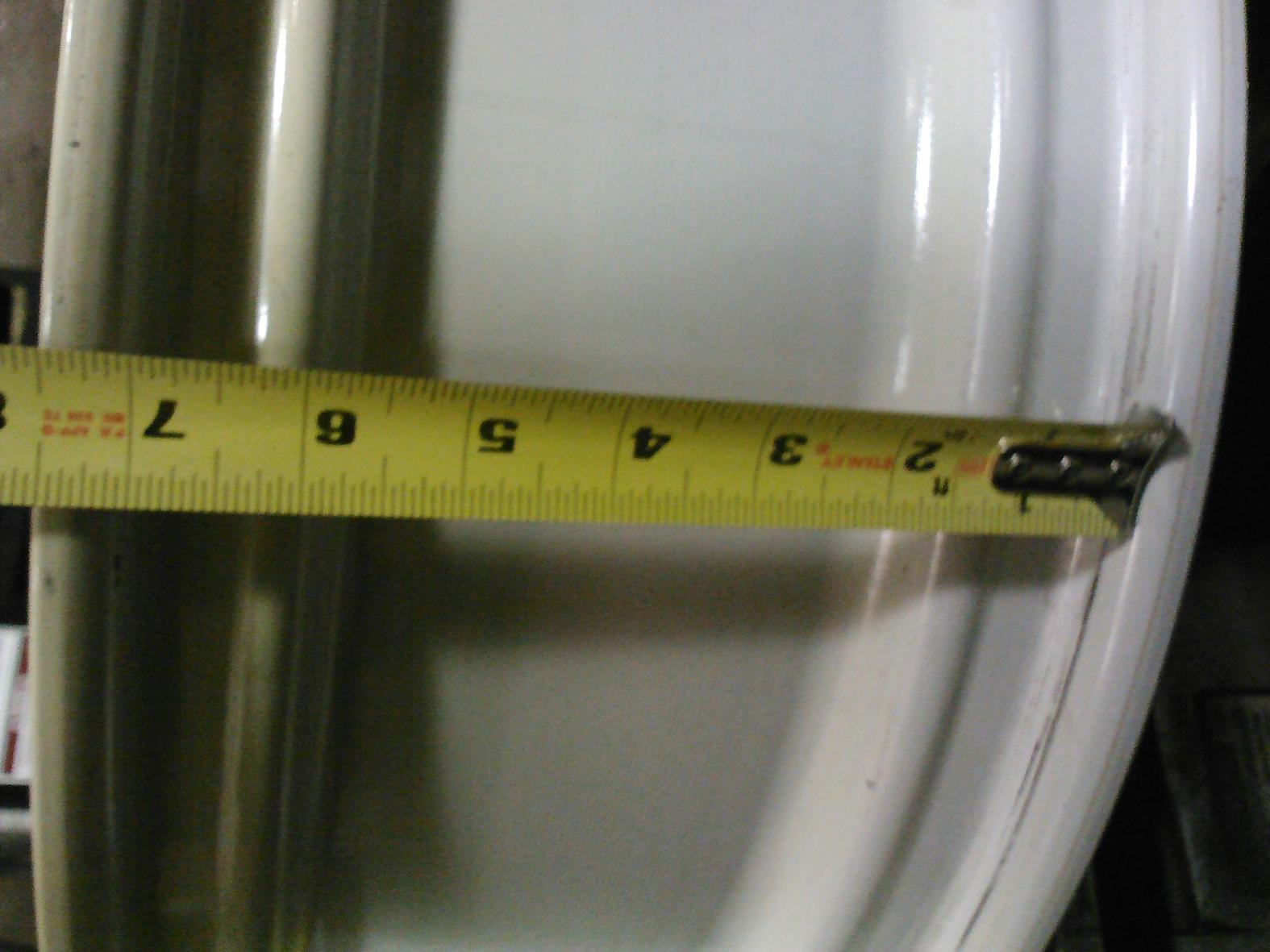

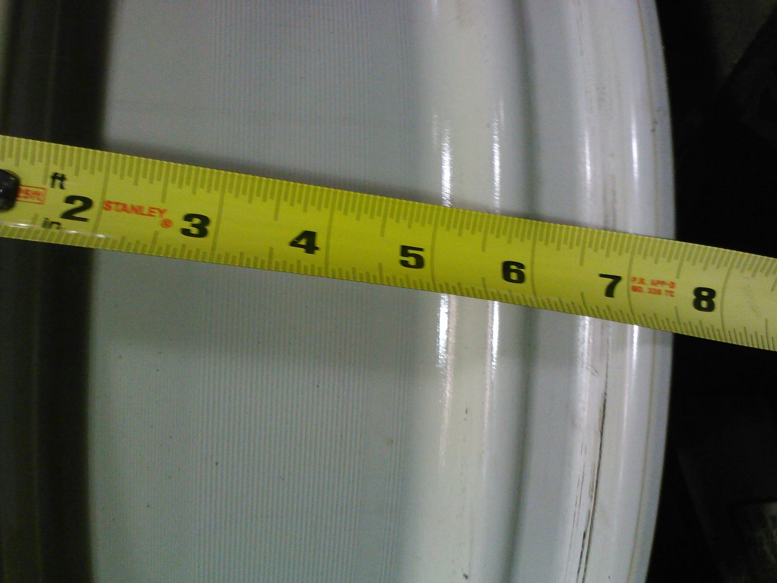

For whatever it's worth, here's a picture of the 2012 "Limited" 20 inch rim. I've removed the tire for the purpose of measuring the rim, between the inner flanges to settle this on going debate, once and for all.
I know that there are numerous spec sheets out there that have determind the rim to be 7.5 inches wide, so I measured it myself to remove all doubt (see photos).
http://www.toyota-4runner.org/attac...toyota-rim-size-numbers-misleading-img254.jpg
http://www.toyota-4runner.org/attac...toyota-rim-size-numbers-misleading-img252.jpg
Important: Before anyone says that these numbers are incorrect, please...take your own measurements with the tire removed, and document your point with photos (as I have done), and post them here; just don't wanna go through another pointless, unproductive debate (LOL)!

I'm not doubting your measurements, I've seen the thread that you posted those pics in originally. I'm just saying that there will always be doubts when Toyota has it wrong in their press releases on all 5th Gen years.
