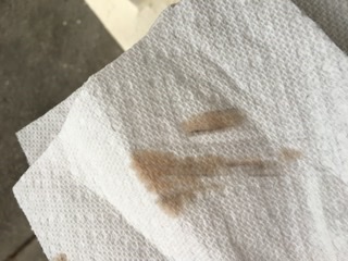

Well, looks like my trans fluid is actually fine after all. Blue shop towel had me thinking it was grey -_-
Took a 20 mile drive home today at 70 MPH... Overdrive worked perfectly the whole way. Has to be ECU acting up.
Trans fluid, the dark parts are from the top of the stick

That fluid does need a change, but it probably isn't an emergency. It should look cherry red with no hints of brown when it is good shape.

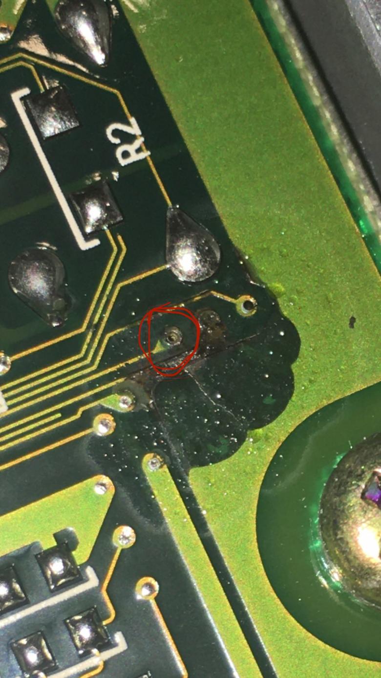

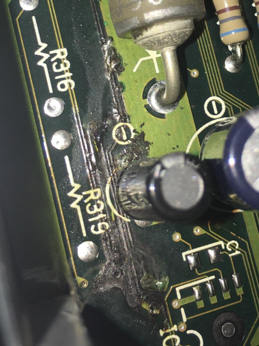

She’s fixed! Turns out it was in fact the ECU! No more p0505 code and no more overdrive issue! Thanks for all your help fellas! Hopefully this helps someone down the road!
