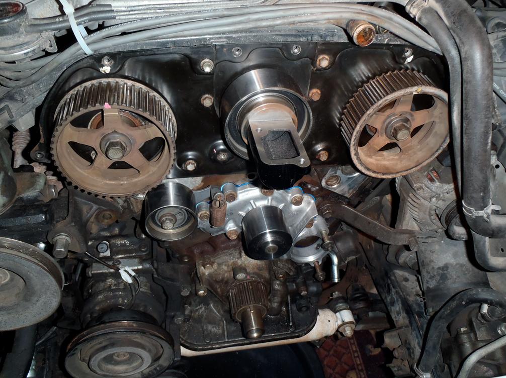

Your gonna have to tear into it a little to narrow down what is going on. Your going to get a lot of "it could be this" and worse case scenarios until you figure out what it actually is. For instance, your scenario sounds a little like mine when my timing belt exploded. The overheating was not as prolonged as yours, only about 1 minute for me to get it off the highway, but after the overheating and a noticeable "pop" it would crank but not start. Took it back, tore into and notice the lower timing cover was cracked from the the belt letting loose. Once apart I found that the water pump pulley had seized and the belt heated up until it let loose.
