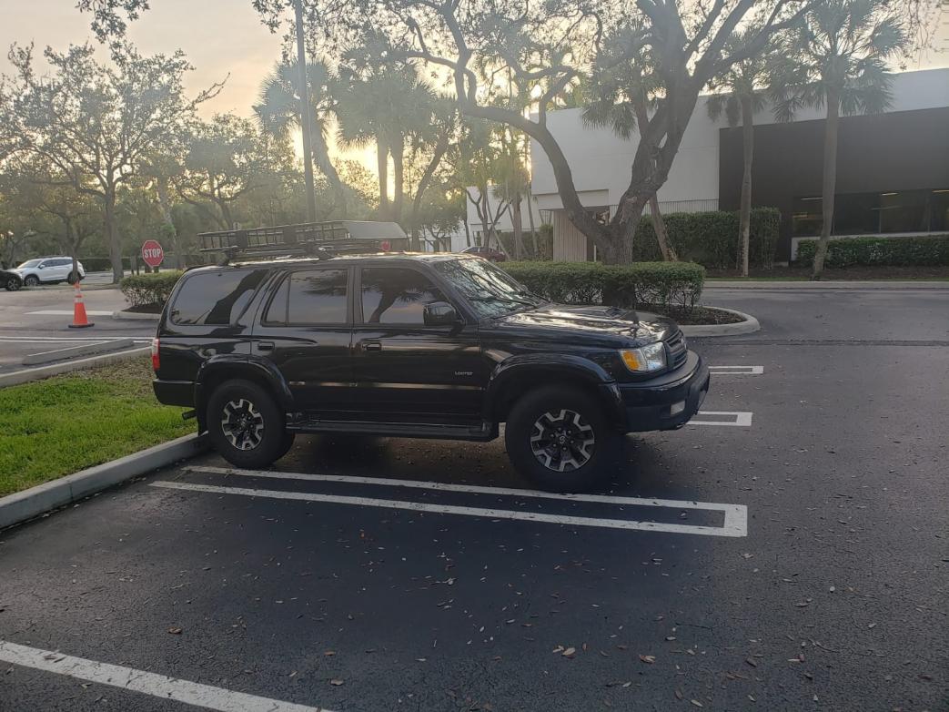

2002 4runner about 200k miles.
Having trouble diagnosing the cause of the overheating engine this weekend.
would love some opinions and diagnostic tips/tricks.
Current known issues/codes: catalytic converter & evap system. Slow oil leak.
Thursday 4pm:
Loaded the black beast to the brim with friends and camping gear to head to Live Oak Florida, about 6h or 450 miles.
Noticed quickly since the new roof basket and the 1,000lbs + of bodies/gear the gas mileage went down from ~22mpg to about 16/17mpg.
9:23pm
About 2 hours before arrival. Felt weird gear change, looked down, CEL, temp in the red, pulled over, coolant everywhere, let engine cool, fill radiator with water, turn engine back on, engine stutters for 5 seconds then normal, radiator liquid seems to be circulating, close the cap, back on the road.
11:15pm
Temp creeped back up into red territory, not enough for CEL though.
again, let engine cool, filled back up, back on the road.
11:35pm
Arrival at camp.
suspecting blown head gasket: lots of white smoke from exhaust.
but unsure because:
1. I know my catalytic converter is f*cked and could be letting out more smoke than normal
2. Outside temps at camp are low ~58F vs ~80F in South Florida.
NEXT 4 DAYS
started the car 1-2 times per day for 30 seconds, nothing out of the ordinary.
Monday 11am
Pack up even more people and gear into the truck and head home.
Coolant still full from Thursday (was plenty is reservoir).
Stop at an auto zone to get head gasket sealant.
Also added a quart of engine oil, it looked a bit low. (I have a small leak).
Planned to drive about 150 miles to the next gas station and empty the sealant into the radiator then since we figured the coolant would have leaked out enough by then.
~2h /150 miles later, pull over for gas, open the radiator cap and she is still completely full to the brim. Totally confused. Oh well, eat some brisket and back on the road.
About 1 or 2 hours after that, temp creeped back up into the red. This time we caught it pretty quickly and pulled over.
popped the lid and got the sealant out.
managed only about 1 cup of sealant before it was full again.
After that there were no more overheating issues.
small details:
-I had the computer plugged in to see exact temp readings. when going uphill temps would go as high as 98C, downhill down as low as 89C.
Im now starting to think my radiator / pump is just crap ?
