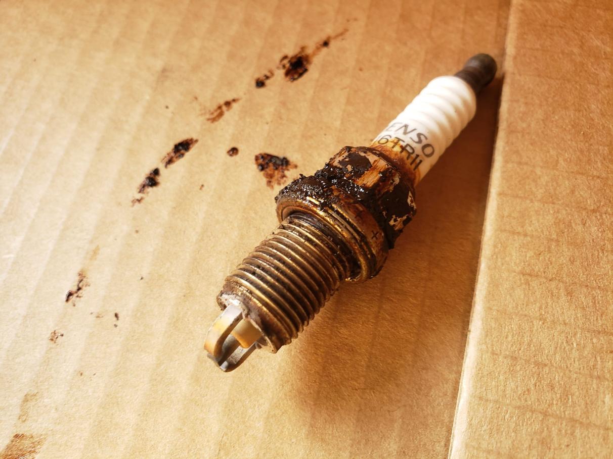

And pic of Cyl 2 spark plug
Now how do i know if i need to replace heads or just the gaskets ?

116 is no good. I'm not sure a head gasket or head would cause 1 cylinder to be so low compared to the others, could be rings. Let see what others think.
The color near the base of the strap shows burning coolant. My money would be on a head gasket. No really good way to tell without tear down. You'll see the failure point on the gasket. If you don't, you'll want to get the head fluxed. If your oil is free of water, it's going to be either the head or the gasket MOST LIKELY. Typically if a cylinder cracks you'll get water in the oil.
It could be the gasket but usually two adjacent cylinders show weak compression numbers.I could be wrong.
Pour a tea spoon of oil in #2 if you get higher compression then the rings could be the culprit. If the compression numbers don't increase much then it could be burnt exhaust valve, or intake valve due to overheating.
Unfortunately removing the heads and examining would be the only way, IMO.

If the head is flat no cracks it should be good. But getting it skimmed is an option that might be cheaper then buying a new head. I dont know cost wise what would be better. Call machine shops near you that do head resurfacing.
Do a cylinder leak down test on cylinder number 2 with a cold engine and the radiator cap off. It's possible to have a failed head gasket where it fails between the cylinder and a coolant or oil passageway and only affect one cylinder.
The 97 SR5 project was that way. One cylinder with antifreeze pooled in a cylinder.
